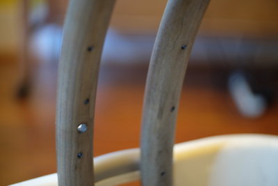

Alright, after a bit of hem-hawing, trying to find an original 28h hoop, and ultimately ordering some from Stutzman, we're back to working on the chainless.
Stutzman aluminum lined 700c. Beautiful as always. Now to make them look old.
1279273
Yes, yes. Now this gave me the perfect opportunity to use one of my favorite wood finishing techniques.
1279274
Black Tea and ironized vinegar courtesy of steel wool and other assorted nuts and bolts laying around left to sit for a day or so. Brush on tea, followed up with a brush of the vinegar solution. It doesn't doesn't look like anything is happening for maybe an hour. Don't fret. The idea is that the tea absorbs into the wood, then the vinegar solution reacts with the tannic acid giving the wood an aged look. Buckle up. Two passes of this and you have a lovely, weathered gray, hundred year old hoop (set against my 100 year old wood floors).
1279275
Two coats of tung oil, which I prefer for antique finishes as it protects, but retains a natural, wood-like appearance instead of a glazed look more apt for a restored bike.
1279276
