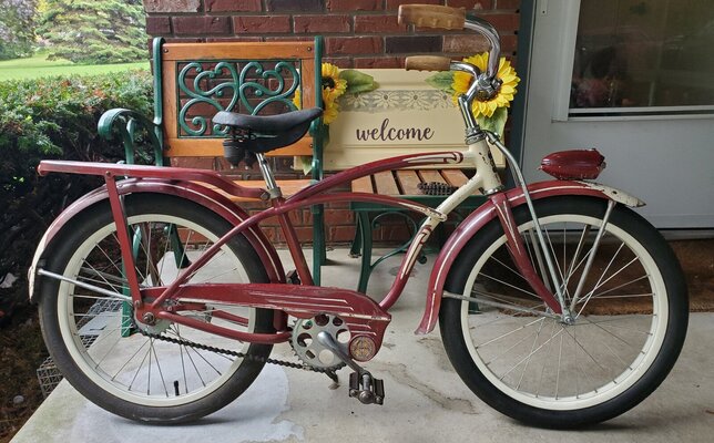

My Little collection of 20" bicycles. All tanks are NON REPRODUCTION! Hard to find stuff.
1624317

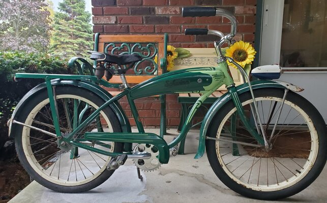

1939 or 40?? 20" mead ranger. Mostly original paint with some added parts.1624318
Restored prewar 20" schwinn.1624319Restored 19521624320
Og paint 19531624321
1953 og paint frame, tank, fork chaingaurd, fenders from another bike 1624322
1957 og paint1624323
1953 og paint
