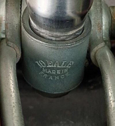

Nice to see another machine of this marque. Sad to see the metal tone painted over, I liked that about my bike. I wonder if the Arius saddle on yours was the original? I see the image of the post-clamp bares an Ideale stamping, perhaps it may have originally worn an Ideale saddle? Thanks for sharing.
I am almost completely sure that the IDEALE saddle was originally installed, because it is French, like almost everything on this bike, unlike the Spanish Arius
