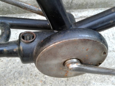

I bought this bike recently. The badge says Model 50 but I believe that number was for a mens bike. Also there appears to be a ghost image of a taller badge. It has the "trophy fork" so that means it's 1898-1899, right? It still has all its ball-end spokes. I thought the hub would be a fixie and was surprised to find it has a freewheel, which I found puzzling because there's no evidence of an original spoon brake. After a closer look I'm now wondering if it has a coaster brake that's not working. I see no evidence (like bolt holes for example) that it originally had a rear fender.
So here are my questions: 1. Which year and model is it? 2. What's going on with the freewheel and lack of period correct brake? 3. Did it originally have a rear fender?
Thanks,

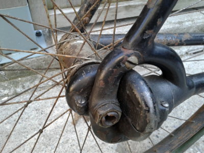

Brian that rear hub might be used with a spoon brake on the rear wheel It worked with a rod coming from a lever on rear hub to a brake set up infront of rear wheel. Is there any markings from the brackets on rear stays behind seat down tube.

Thank you Max, so do you recognize my hub - is that what I have?
hard to tell from your picture
does your hub have that extra loop to attach the brake wire?
the red arrow, in the picture I posted, points to the clue to your answer
not all coaster brakes had the brake arms, just think of the very early CCM Hercules hubs for example.
But my guess is that they added the front Philco brake (not designed to be used on a wood rim) because they had lost the ability to brake using the rear hub So something is probably missing!
Front rim might be a replacement, the spokes don't seem welded like the spokes on the rear rim, and there doesn't seem to be any extra wear from the brake pads (compared to the rear rim)
as far as a rear fender, it probably had one.
they used a clip on the ones that I have seen

After some further digging on the CABE looking for catalogues or other Columbias, I can state definitively that this bike is an 1899 Model 60. It had a wooden rear fender originally. A post by dfa242 back in 2013 under the title "For Sale: 1899 Columbia Model 60 Ladies Chainless in Original Paint" shows the exact same bike including the ABC head badge, with the one exception of the rear hub brake. The rear hub on that one is the early New Departure, which could have been an option in 1899. The original brake on my bike is still unknown; I haven't had time to take apart the rear hub yet. A CABE member helped me identify an 1899 Columbia chain-driven bike a few years ago, and I will see if I can ask him to post the catalogue page here for the Model 60.
To answer the question from locomotion, the rear hub does not have that tab for mounting a rod for a duck brake.

Brian Run your finger around the round piece on the no gear side of hub that nickeled piece and feel if the tabe has be broken off.
yes, because the hub does look identical.
I bought a Columbia drive shaft frame 2 years ago, that had the spoon, wire cable and the hub piece with the tab (but no hub!)

I could not find a serial number. Can someone tell me where it's supposed to be?
I also could not find evidence of a broken tab on the freewheeling parts at the end of the hub. If the bike was originally equipped with a front spoon brake would the rear hub have been a fixie? I think the next step is to take apart the rear hub and see if there are hub brake parts inside, but I'm not sure when I'll be able to get to that. I'm knee deep in home reno stuff.
