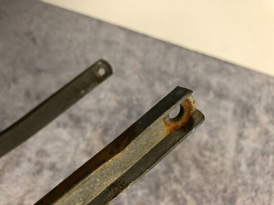

Just measured an undrilled early braced CWC drop stand and I get the following:
Hole - .25"
Space clearanced for dropstand bolt head - .48-.50"

Maybe others can confirm. Also, did the early CWC dropstands even use a shouldered bolt? I asked this question a few months ago hoping to get some photos of an original set but nobody stepped up. I have two separate sets of photos from original braced cwc dropstands that show just normal bolts with square nuts.

I had purchased these dropstand bolts a while back but their shoulder (.33) was too wide to use on the CWC braced dropstand with a .25 hole.
Straight thread bolt ( no shoulder) would wiggle off. I guess it could have been done that way but they just wouldn't stay on.
