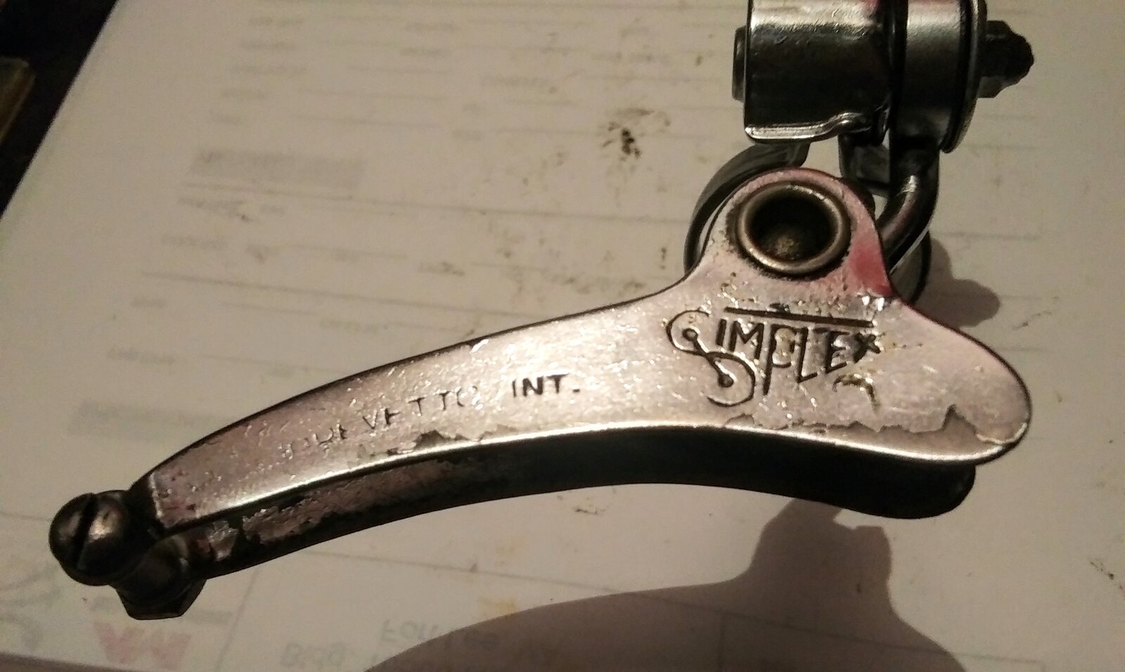

Here is the photo of the Simplex pivot or swing FD that the Huret is replacing. Also, I have another Simplex pivot style that has been unused due to apparently being a braze-on mount; a frame style of that period that I do not have. If someone has an example of a frame with that braze-on FD I would like to see it so I can possibly fabricate a proper 'tab' in order to utilize that FD on an older frame. I do like the butterfly nut for friction adjust, but I have not checked to see if it would fit the Italian clamp-on version; trying to keep each unit original. The Simplex clamp-on weighs about 148g which makes sense since it is all steel construction except for the aluminum knob, and stamped cap.

Quick note: the Simplex French braze-on butterfly nut appears to be 24 tpi, whereas the Simplex Italian clamp-on hex nut appears to be 32 tpi; definitely not able to exchange hardware regardless of personal preference. I will post these Simplex units on a separate thread with more detailed photos and specs.
1468409
I am starting to think that the Italian version might be a rare bird. It was from an Italian frame; but a Lygie which has it's own odd history between France and Italy. Still I never knew Simplex ever had their components manufactured in Italy. If you know of other examples please educate my ignorant brain. The Italian unit is definitely the earlier version, but by how many years; your guess is as good, or better than mine.

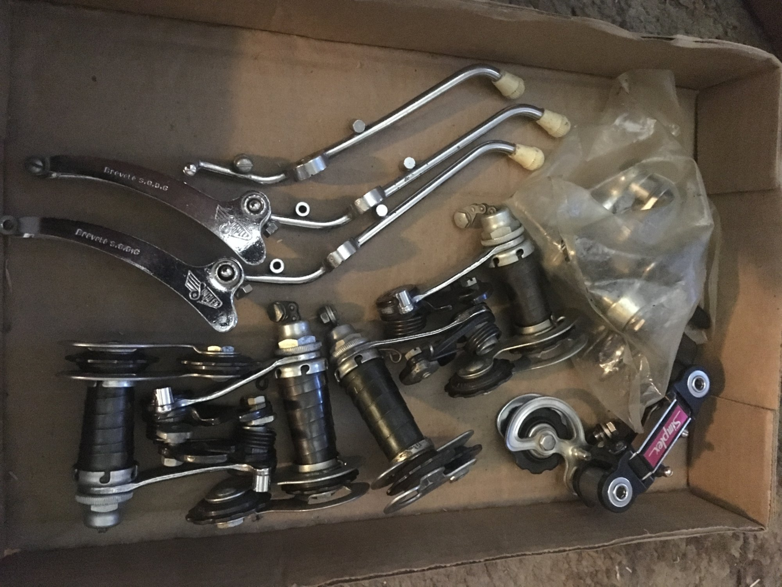

Now I know where the Cyclo spares went to! I think I have an old dual cable rear derailleur buried somewhere.
Don't know much about these but have a few boxes of similar stuff, sorry not trying to hijack your thread but thought this stuff might be related?
I was looking for some parts in your boxes; needing a tension spring and bracket for my late 20s early 30s dual cable unit below, but I think it's a little bit earlier than your stash.
