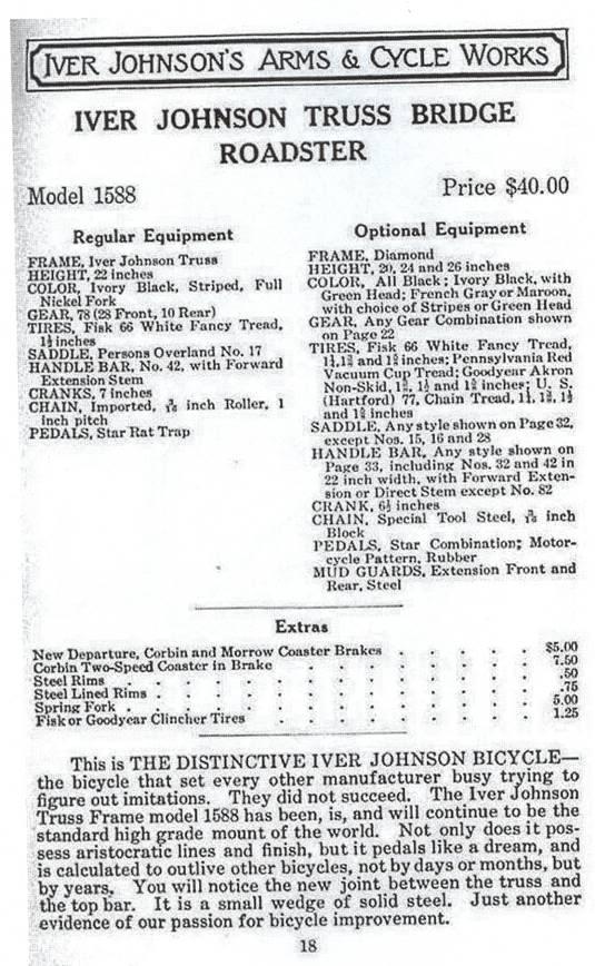

Not an expert but I just got a reprint of the 1915 IJ catalog. Saw this bike on ebay, great buy. I love the lines of these truss bridge frames. Anyway in the catolog is the 1915 Iver Johnson Truss Bridge Roadster 1588 which looks exactly like this bike. It is part of the truss bridge line. Standard frame was a 22" but it also came in a 26" (also 24" & 20") frame which this bike looks like it might be from the photos. Same chainring, same truss bridge weld at top center frame. The IJ Heavy Service model looks more like a Columbia Arch Frame with a filler piece between the top of the arch & top of the frame rather than direct weld like the roadster so pretty sure yours is the 26" roadster based on this and the length of the head tube. This bike was produced a lot of years so 1915 is only a guess. Someone with more knowledge on the serial number would have to nail the exact year down. Standard color was Ivory black, striped, full nickel fork. Optional colors were all black, ivory black with green head, like yours; french gray or maroon with choice of stripes or green head. The standard saddle was a Persons Overland No 17 but there were 10 other optional saddles offered. Your saddle looks like a Persons Eclipse No. 26 which was an option but just a guess from your pic. IJ offered a lot of options so I'll post a copy of the 2 pages for this bike. Hope this helps you and please post pics as you restore it. Thinking about an IJ truss bridge frame for my next project as well so would be interested in seeing your progress on the bike. Thanks. Gary
Morrow was one of 3 hubs used on IJs in 1915. I agree the fork is definitely wrong, should have a full nickel plated fork and would not have come with the truss rods. Its a big bike and a big guy may have damaged and replaced that original fork, just guessing. Mud guards (fenders) were optional so not sure if yours are original or not, need a better IJ expert to weigh in on those. Seat definitely could be one of the original options. Good luck with it.

The flat wedge piece between the truss bridge and top frame began in 1915 on the roadster so still consistent with 1915 or later roadster. 7-style seat posts are correct. Troxel saddles were options from the 1915 catolog. See pic of saddle options for 1915 IJs below.

Funny, your seat looks like the No. 28 Troxel Eagle Climax which was not an option per the roadster page but pretty obvious someone got one on this bike.
