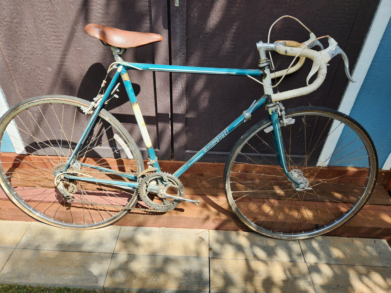

I was given this bike by a co worker who was cleaning out his garage. I have searched here and other forums trying to figure out what i have as well as history of the brand. Its very complete but needs some love and id like to get it rideable. How can i tell what year and model it is? Im aware that its not a high end bike but Is it worth my time to put effort into making it use-able again? Thank you for your time and i would greatly appreciate any information or advice you can give!

Your example clearly Mercier.
Cycle a base model hailing from right near to 1965.

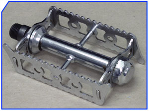

the cycle's non-resident pedals were likely to have been Lyotard model 36:
Thank you!! Thank you for the education, How can you tell the date or range of dates? I have the pedals, they were removed for storage. I think im going to clean it up and service everything. My local shop has the press for the cotters so I wont have to stress over those. Even though its a base model do you know, do they ride well?

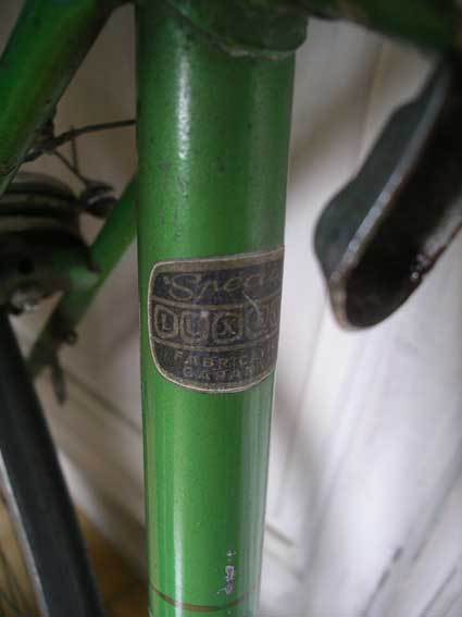

tube set: Mercier house branded hi-tensile termed "LUXTUB"

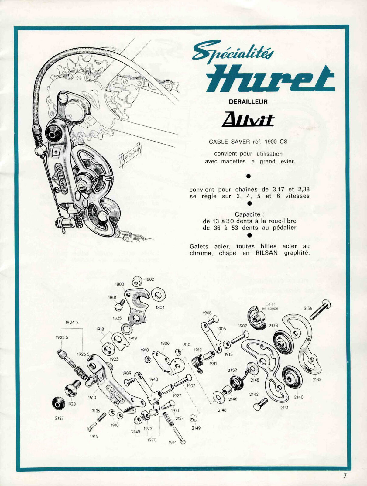

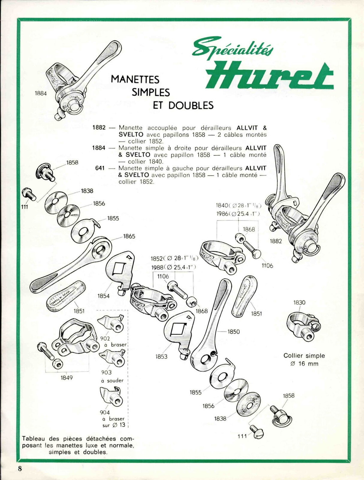

here are some manufacturer catalogue pages illustrating a few of the cycle's components:

two date bracketing components are the Normandy Sport hubs and the Huret Allvit 600 front gear mech

"do they ride well?" Part of this is going to depend on whether the bike fits you.
I realize that was a very broad and open ended question. It is my frame size and i can see places that will need to be changed to fit me. The bars seem very narrow.
