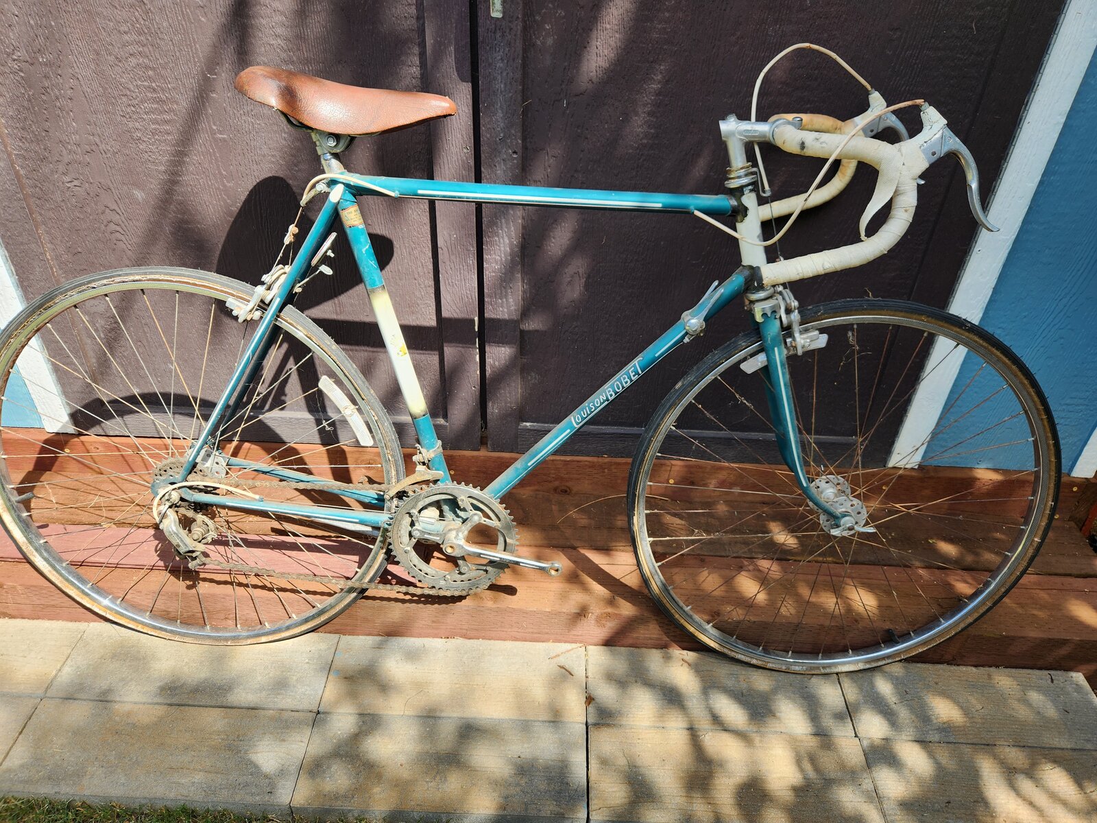

I put the bike into the stand this evening and gave it an overall assessment.
It doesn't have any rust issues. Everything moves, nothing is frozen.
The wheels will need to be trued and possibly replace the spokes.
All of the consumables will need replacement, tires, tubes ,cables etc.
The saddle is junk ,i will need to locate something more "correct" for the bike, Suggestions?
Brake hoods are barely there and it looks like replacements don't really exist, Is there a suitable full hood that would work?
Large chain ring has a bend in it and will need straightened.
Overall it really needs a complete service, clean and polish.

The rear derailleur is early 60's. If the jockey wheel cage has four tension prongs then it's the earlier Alvitt piece that was used by Schwinn in 1961 and 62. The second gen with three tension prongs was use in 1962-1963 and part of 1964 on Schwinns. I would have to assume that one was used on other makes until Huret came out with the Hersey Kiss style Alvitt that showed up sometime in 1964. The jockey wheel cage was changed in 1966 and only had two prongs along with the wheels being changed to nylon verses all steel.

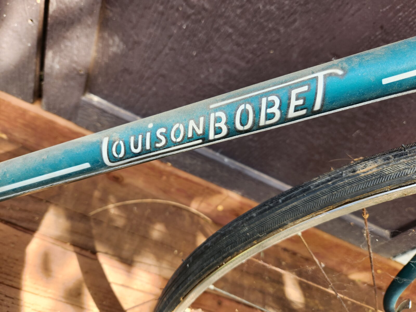

The gold decal on the seat tube says
''The Bike Spot"
New and used
1022 main st
Santa Clara
241-9747
Thank you.

borgward
Frame -
lug pattern: BOCAMA 51/I
fork crown & cap: BOCAMA
bottom bracket shell: RGF (Raccords Gargatte Freres)
dropouts: NERVEX Ref. 1028
tube set: Mercier house branded hi-tensile termed "LUXTUB"
Fittings -
here are some manufacturer catalogue pages illustrating a few of the cycle's components:
non-original bits present: saddle, saddle clip, wheel reflectors, rear reflector
Louison Bobet -
in this image he is seen in the yellow leader's jersey during the TdF of 1954; he went on to win the event
he is astride a Stella cycle in this case
poster of him doing motor-pacing on a Stella, 1953 -
competing in the TdF of 1953, which he went on to win -
long after his retirement there were also some Louison Bobet badged cycles produced by the firm Meral
Dating -
no easy answer to your question here
in some cases it can be a paint or transfer which was employed only for a brief time
in other cases it can be a particular fitting which enjoyed but a brief production life
in this case it is a combination of several clues
two date bracketing components are the Normandy Sport hubs and the Huret Allvit 600 front gear mech
the gold rectangular transfer at the top of the seat tube appears it may be from a cycle shop
would be interesting to know how it reads
first word appears it may be "San" which suggests a possible origin with one of the shops on Stanyan Street in San Francisco
one national seller of Bobet bicycles at this time was Gene Portuesi, proprietor of the Cyclo-Pedia mail order catalogue, originally based on Michigan Avenue in Detroit and subsequently relocated to Cadillac MI
