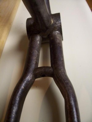

Hope some one can offer some help in making an Id. The tubes seem to be drawn and seamed. the number on the right of the seat tube is 245687, two patents are listed on the BB Dec. 3 1895 May 29 1900

^^^I was thinking that also. Serial number is in the right place. How many holes for the headbadge? IJs have 3 holes. Any other parts with it?

Thanks for the reply! There are two holes for the badge , verticle at 3 3/4'" cc. All the others parts are of a later period, the only other piece I think maybe original to the frame is the Chainwheel.

fat tire trader The BB is 3" cc inside 3 1/8 outsde, the width is 2 5/8.
Found some cool stuff on the patents: the May 29 1900 seems to be for a self fixing seat post http://www.google.com/patents?id=RV...=gbs_selected_pages&cad=1#v=onepage&q&f=false
The Dec. 3 1885 is for an extruded BB which this frame has; http://www.google.com/patents?id=7T...=gbs_selected_pages&cad=1#v=onepage&q&f=false
Thanks for the interest in my project. This has got me truly stumped
Rus Tea
^^^ That was my orignal thought, but the patents are held by individuals, so I have to see if I can find the purchaser of the patent. Or I'm hoping that something like the unique seat post( may 29 Patent) will be a clue. So far, no luck.
