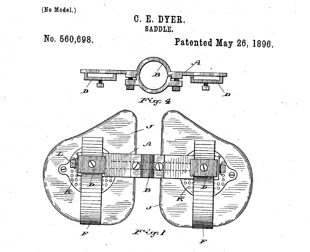

There are some very early patents for saddles from the late 1800s that are super old timey and the TOC guys probably are familiar with them. Saw some bizarre designs with completely separate pads for each butt cheek.
You can also see in the Provoost patent above that there are springs in the front (nose) and rear of each side.

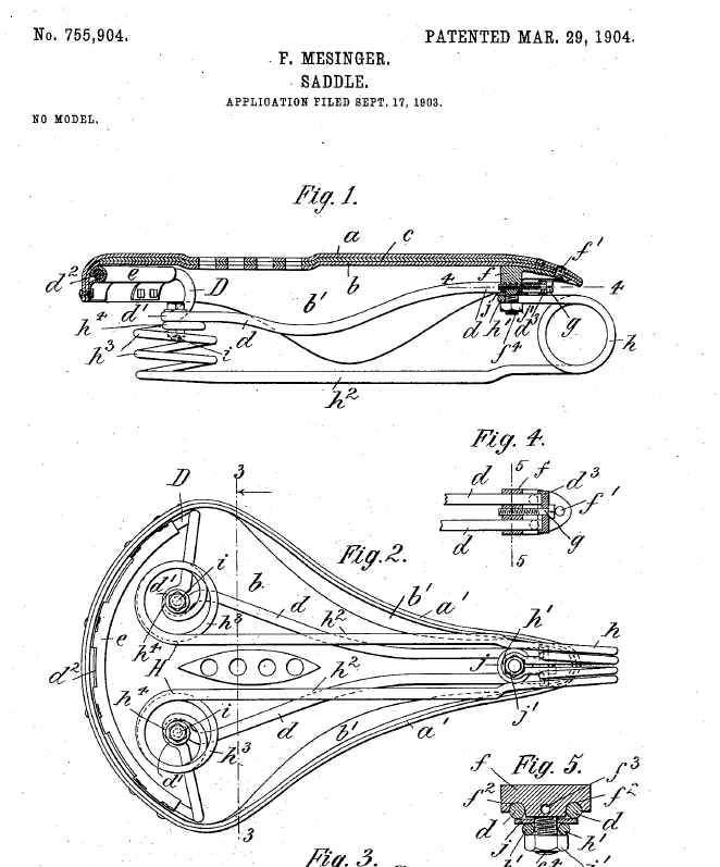

3 spring design from Mesinger 1904

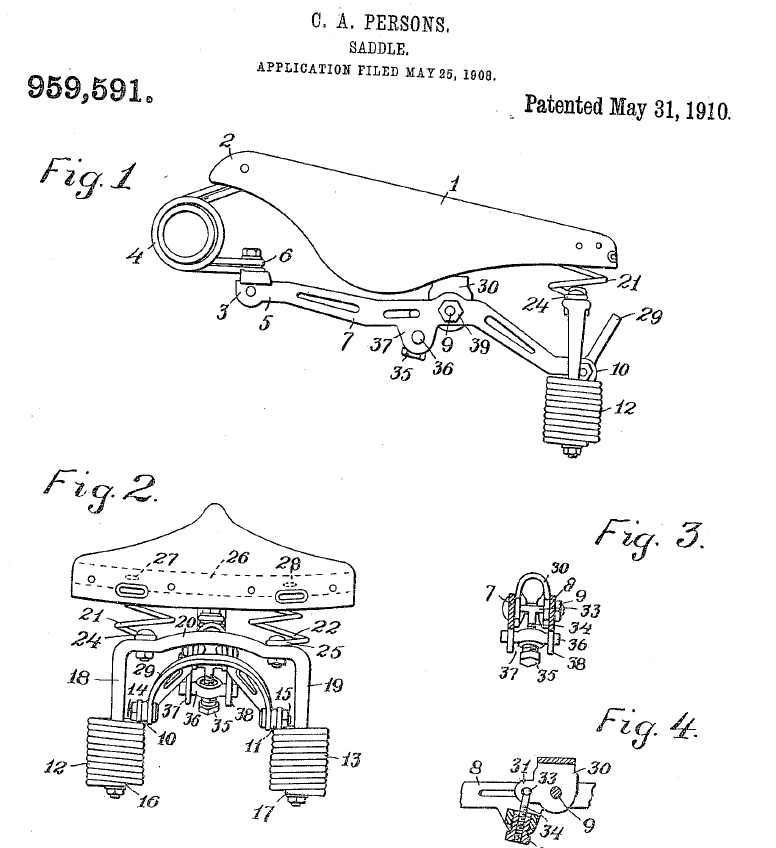

Persons is close in 1910 too. The top spring 21 resting on the cross bar 24 is kind of like Mesinger above.

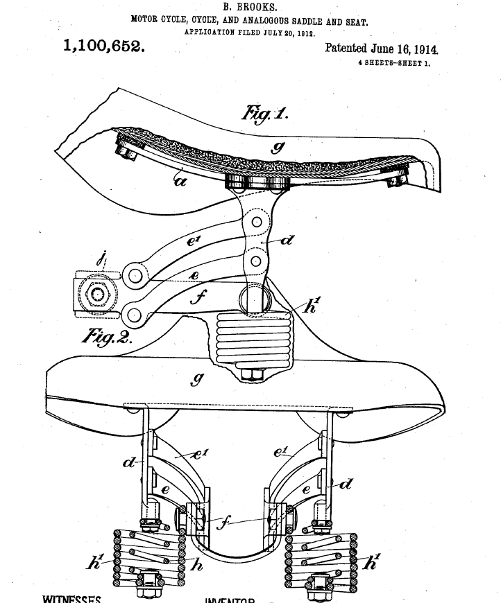

Brooks is working on overly complicated designs in 1914 too.

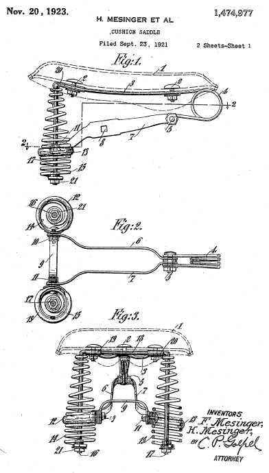

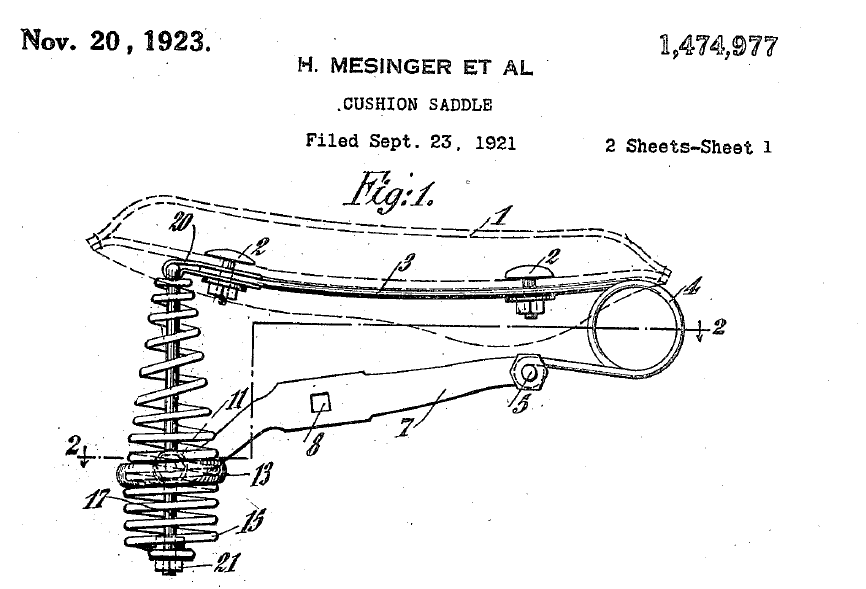

In 1923 Mesinger shows this design with a more formed platform 13 between the opposed springs and a nose coil at the front.

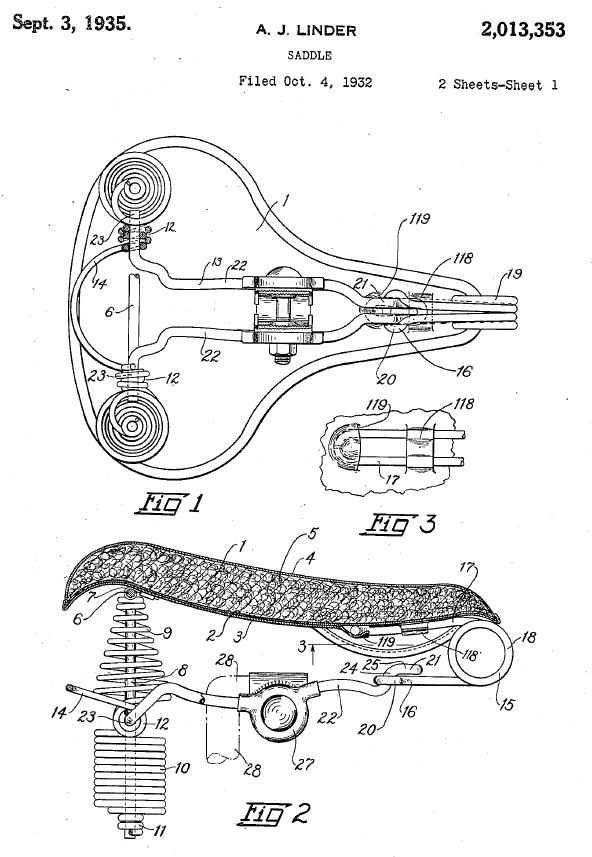

In 1935 Linder at Troxel patents the classic Troxel long spring design with a nose coil and two opposed rear springs connected in the middle. Notice how the bottom springs are attached to the center rods by threading on at 11, not with nuts like the designs above.

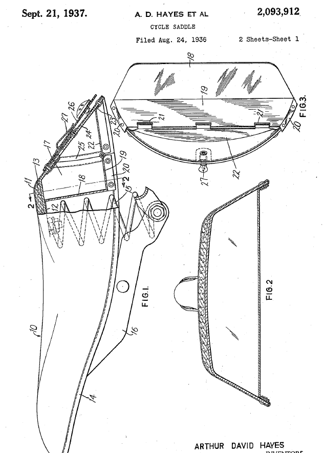

In 1937 Hayes at Troxel shows the Tool Box Saddle design.
