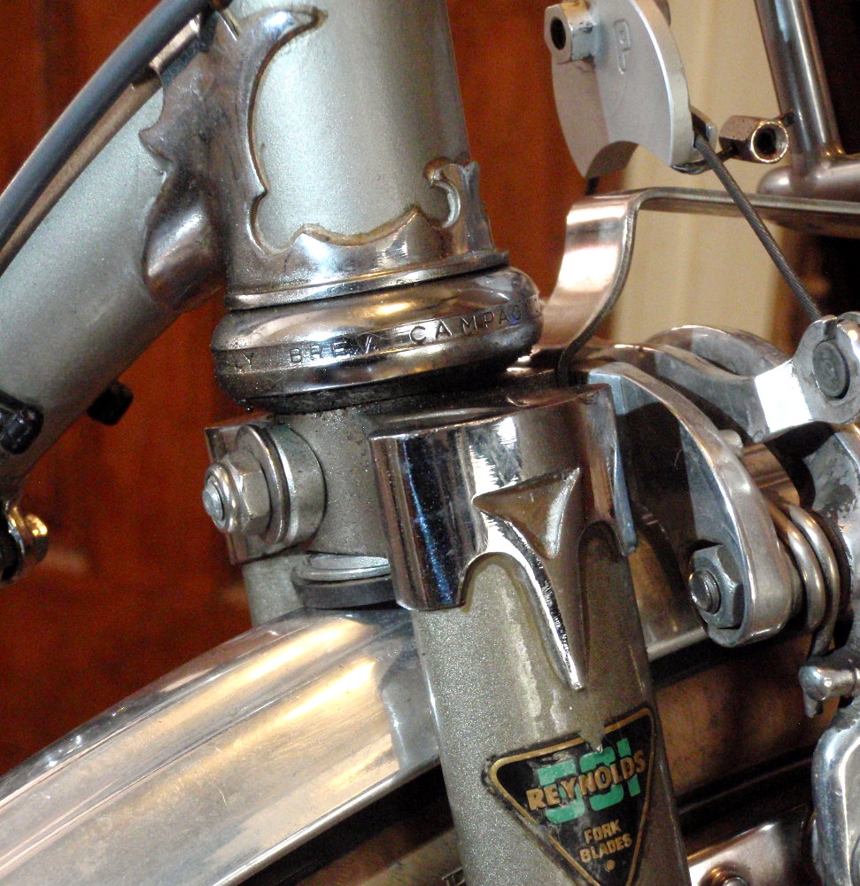

There was a time they even repaired them with available blades, though buying whole forks (for trail change/ asthetics/ prestige) became the norm.

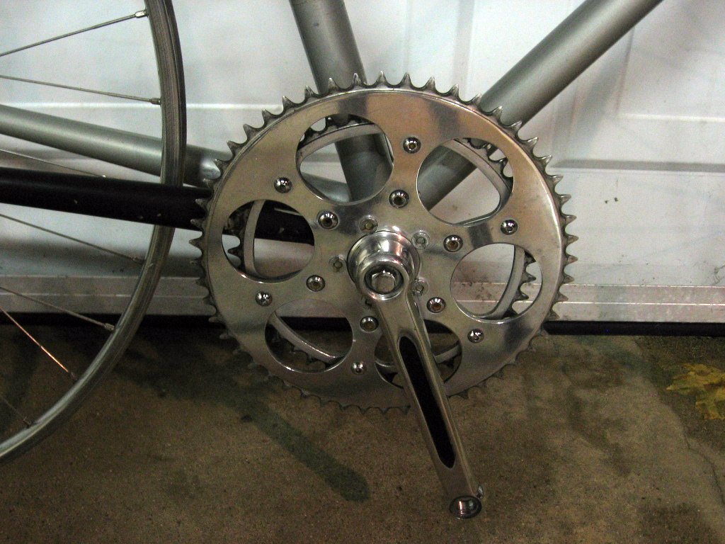

Getting past all that, a lot of cool things about the bikes - they were well-appointed, and one of the coolest things was their cyclotouriste crankset copy, licensed for their manufacture by TA.
