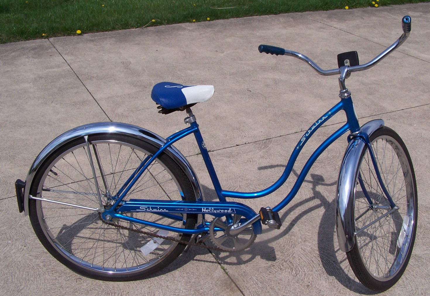

Your info is partially incorrect.
My 77 Hollywood and my 78 HD both have the new style chainguards!
