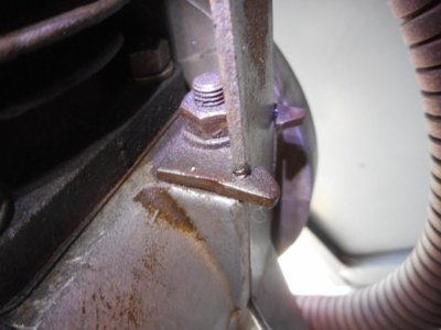

The Whizzer guide bar bolts to the bottom engine mount stud.What is the stud on the front for?
An H shaped clip that holds the bar ( bar slides up and down in it) and that bolts to the front of the engine.
There is a clip that attaches to that and a clamp to the frame that connect together. Hard to explain...
