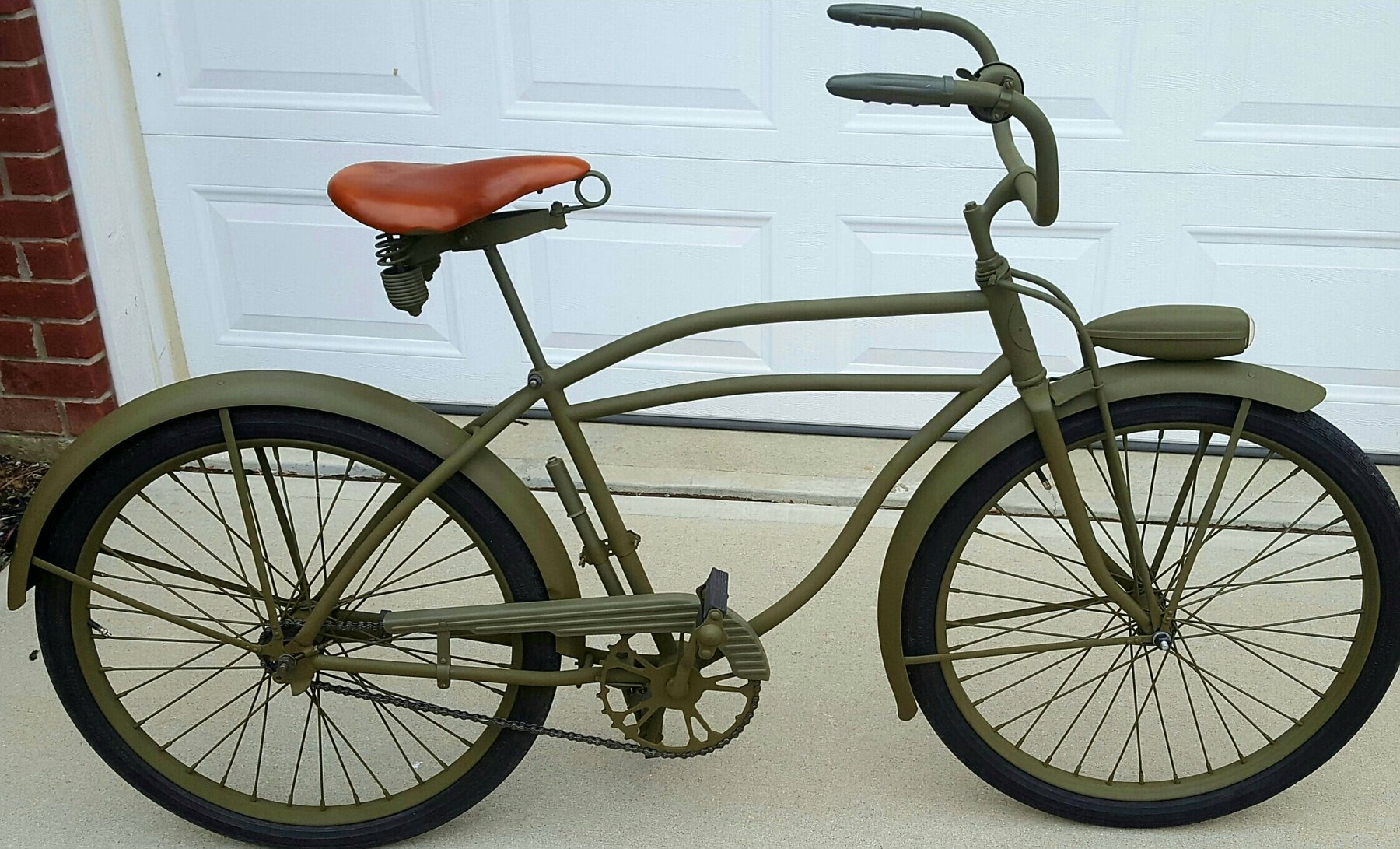

I owned the this bicycle below in the mid-90s....
I bought it as shown below from a Dutch seller at the British War&Peace show in 1997... He had imported it from the US.
This bike had a Columbia headbadge and an MF serial number, and was fitted with balloon tires on two different rims with narrow spokes and New Departure hubs...
Don't know if the number was genuine, or if it was a real Columbia or even a Military model...
I sold this one around 2002 when I found my first MG model and had too many doubts about it...
As this was in pre-digital times I don't have many pictures of this bike and I will look in my old photo boxes to see if I can find more...
