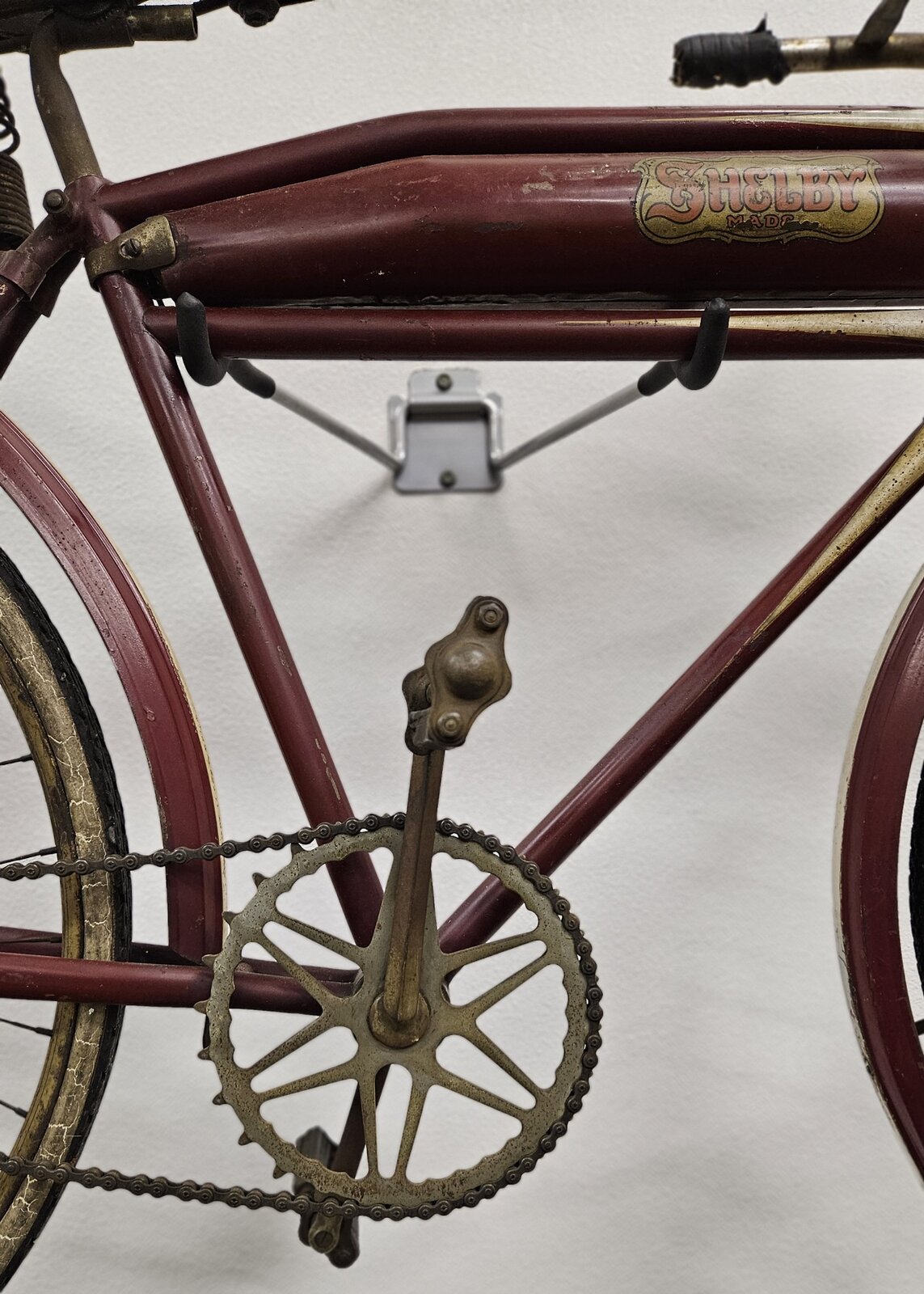

Nice bike! The Chain Ring looks odd but maybe not? If possible can we see the serial number on the BB shell and also what the chain stay bridge details(bottom) look like? Thank you in advance, it's a beauty! PM me if you wish to keep confidential...

The chain ring looks very similar to my 1925 Shelby motobike, IMO. Subtle difference, but very close with the snowcones, and 5 vs. 6

@oldmtrcyc - Very different ring. Can we see the rest of the bike? Show us the rings' drive pin if you could as well..

Appears some of these early Shelby's used Excelsior-like sprockets. Below fork crown new to me for Shelby...
