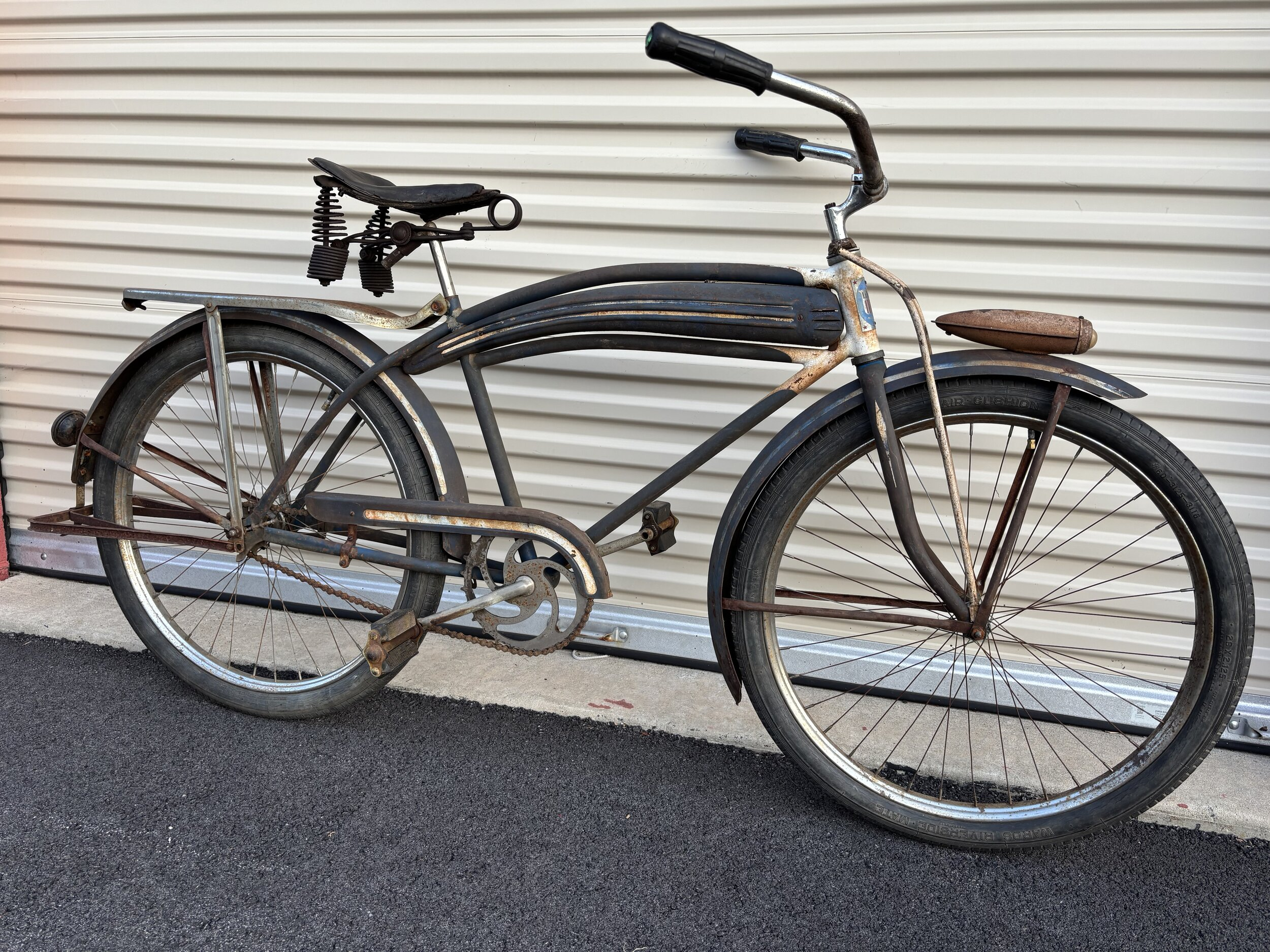

1937 Huffman

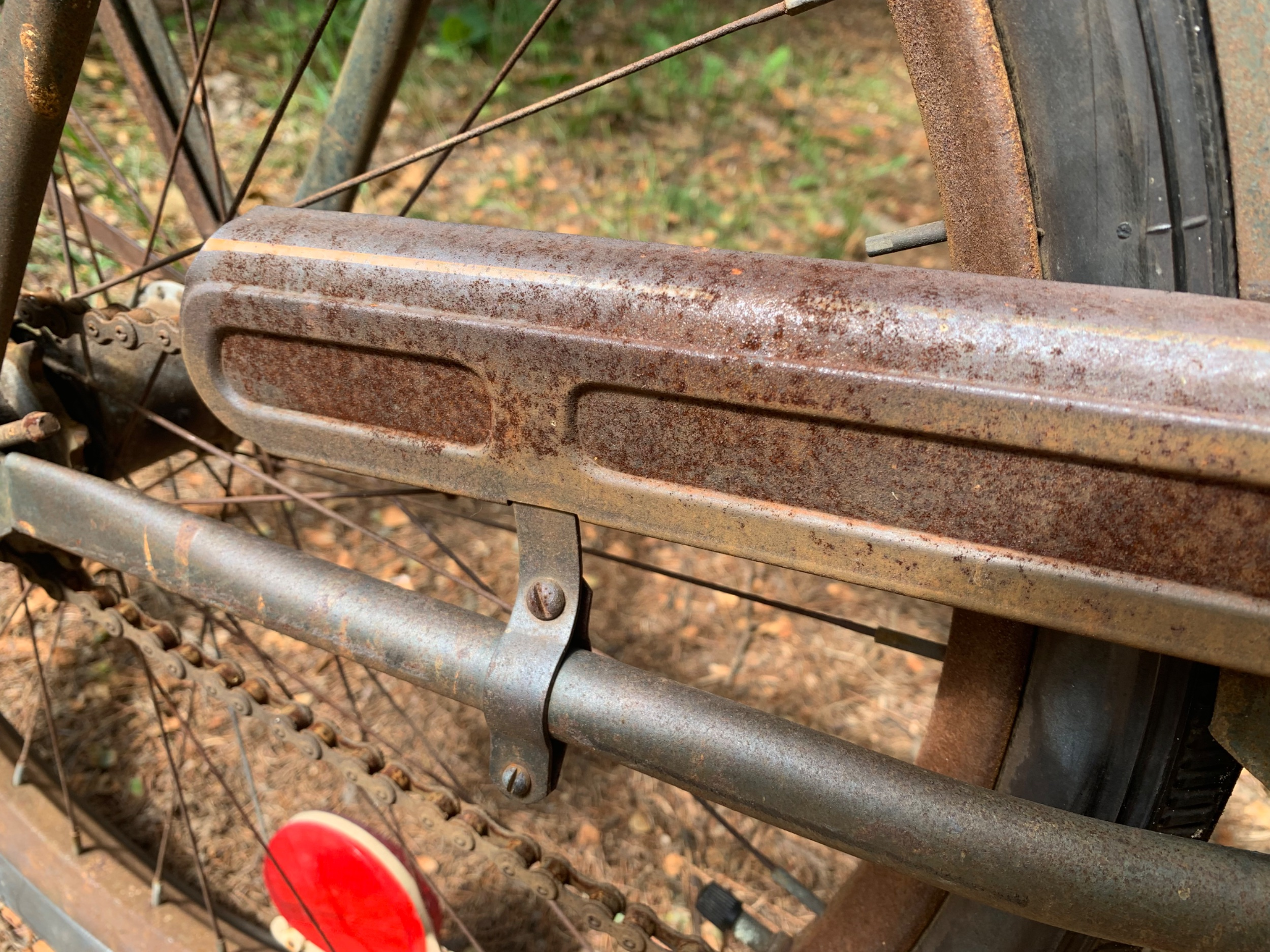

Did Huffman ever use that guard ( patina kind of matches ) if so could be a clue to badge?
Betting $ crows beak flew the coop at some point! not a huffman guard
looks to be prewar hockey...silver king and others
I have questions about the guard too. The guard appears to be painted the same metallic blue and is pinstriped. Appears to have been on the bike a long time. And for late 37 would the crows beak be correct or the mesh version? I have a crows beak in blue/red that is a perfect patina match. But I’m leaning towards the guard on the bike being original.

The fork stamped 11/7 has the pyramidal shaped trussrod tangs that is a feature associated with the 1938 model year.
So this bike may have been considered a 1938 model by the factory or distributor?
Which also would mean that a “Crowsbeak” guard could have been a legitimate possibility?
But, with that said, the paint on that “ Hockey Stick” guard has me convinced that it’s original to the bike.
To collectorize it, put the matching crowsbeak on it.
To preserve it, keep the hockey stick on it.
Owners prerogative?

Just enjoy it as it is, and have fun showing off your $200 hundred dollar Lima Ohio marketplace score.
Either way, it’s a cool bike man!
sure enough looks orig huh
This is a "generic" guard as well isn't it:
