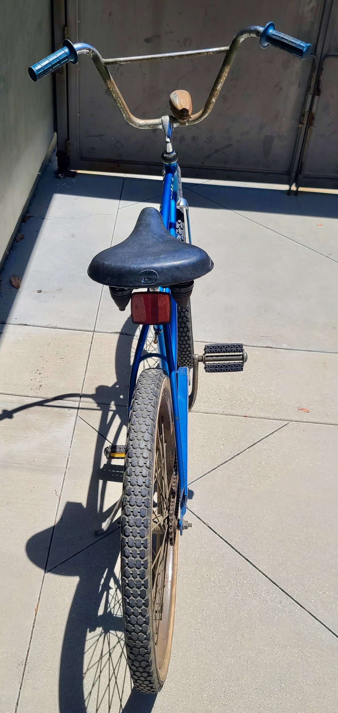

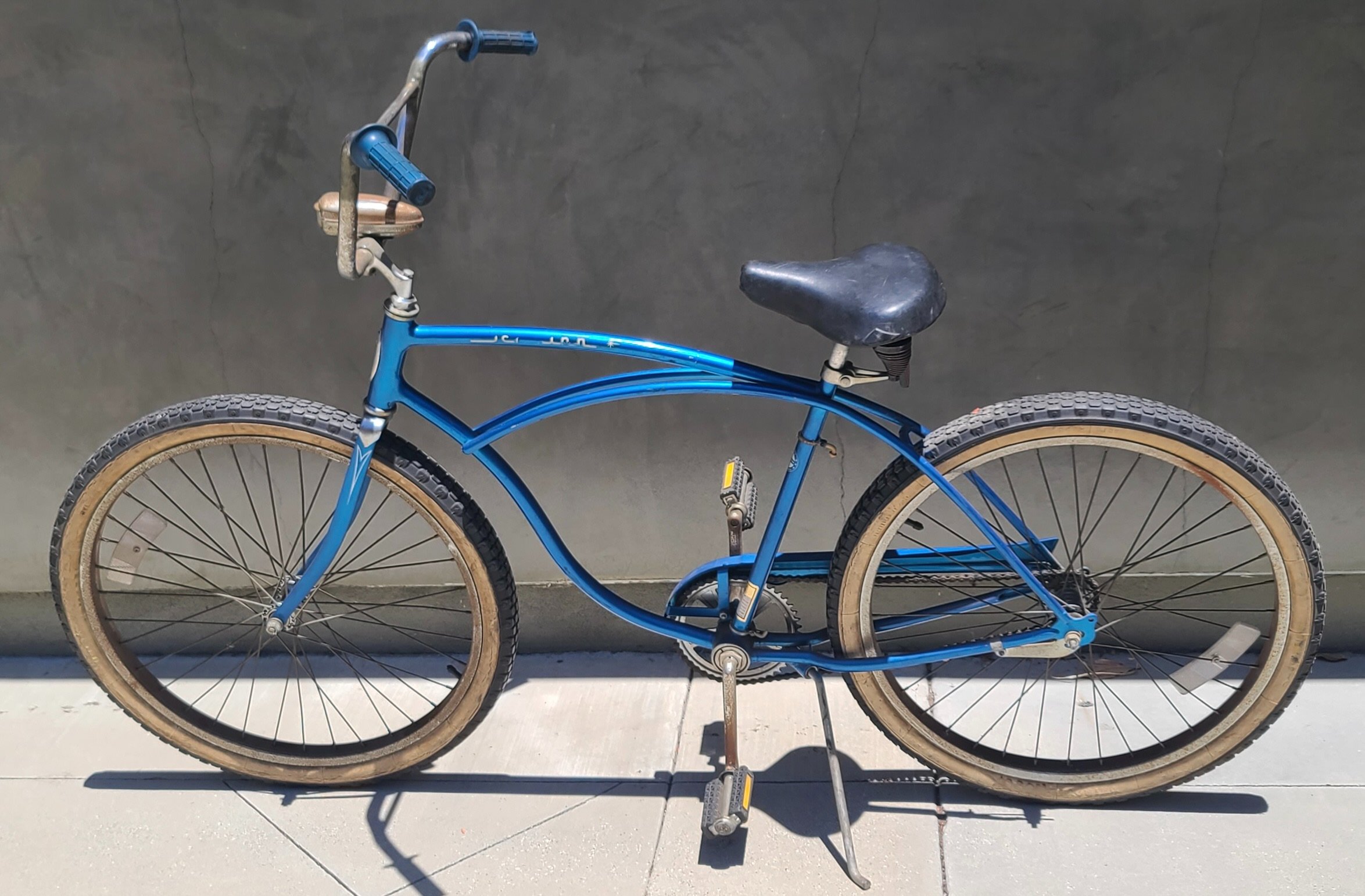

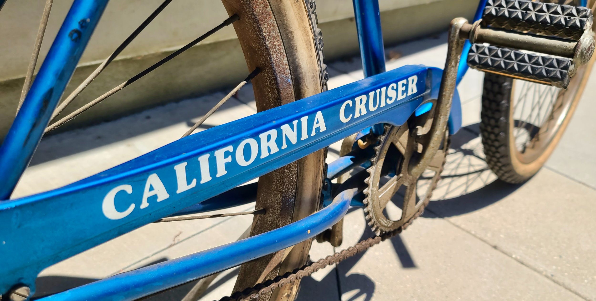

I was fortunate enough to pick up another Schwinn California Cruiser the other day. I got it from an older gentleman friend's brother passed away recently; the brother gave it to the guy I got it from to sell for him. The bike sat covered in a garage for 36 years about 15 miles away from me. The bike came wit the home made BMX style bars pictured; fortunatlely for me I have a correct set of bars for it in storage. This is the earlier version with the wingtip chain guard and mag-style sprocket. I am in the process of tearing it down for service and cleaning. The original wheels have quite a bit of surface rust, but I think they can be saved. I threw a set of blue Arayas on there until I have time to clean up the original wheels. I already soaked the cranks and sprocket in Evapo-Rust and they turned out really nice, which gives me hope for the wheels as well.

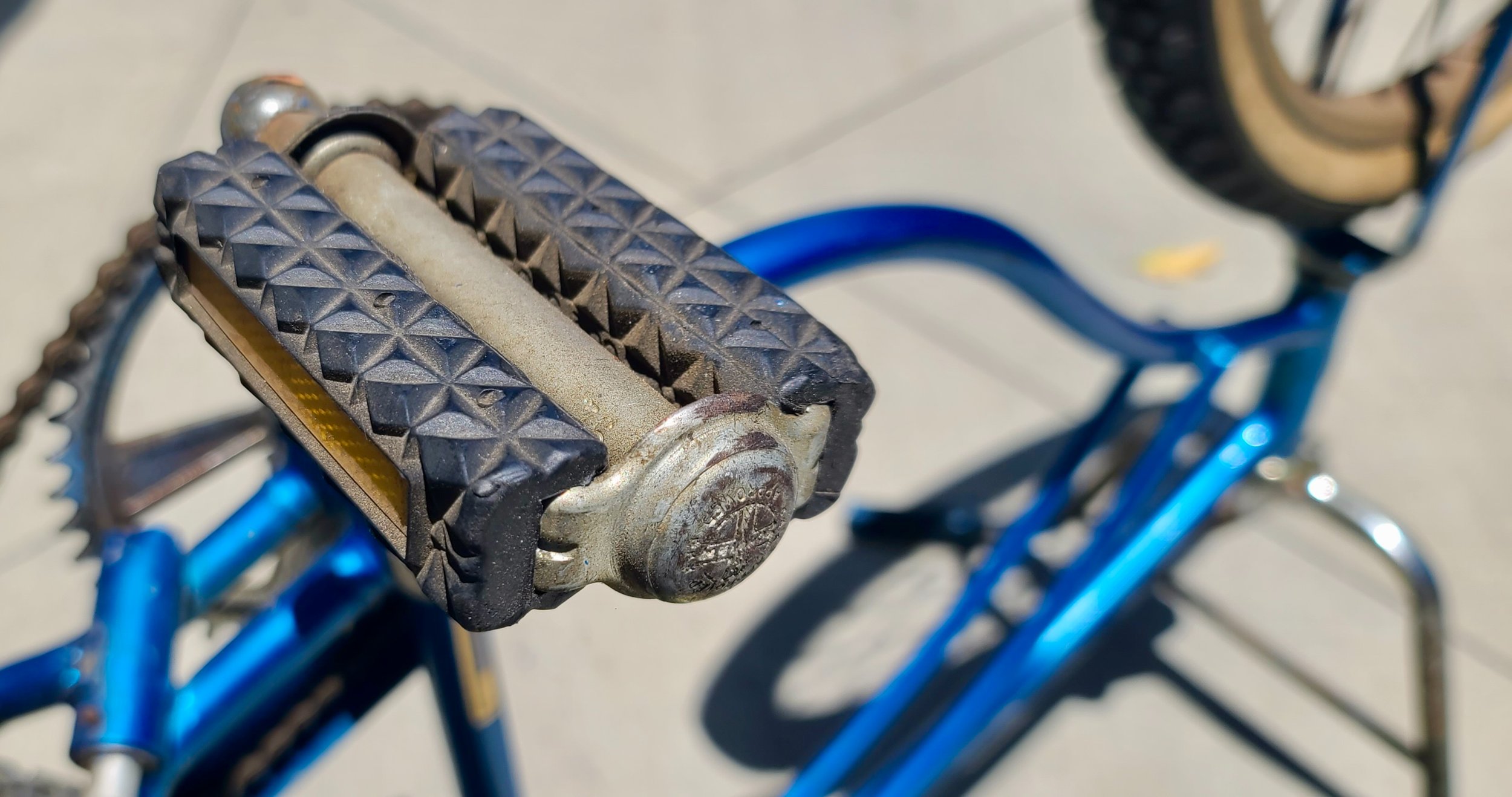

Exactly! Not sure what is meant by so many variations other than the earlier sprocket/wingtip guard with script top bar and later sprocket/spitfire style guard with block letters top bar. Besides that, all should have 76 stamped parts including pedals. Uniroyal tires. Side stamped S2’s, 76 stamped Japanese Chair front hub. 76 stamped lower typhoon/hollywood style cruiser bars. Slim line grips. Head badges are usually stamped a little later than frame. I’ve only seen and owned red, black, and blue. Guys like me and you and a few others here in SoCal search high and low for these and the other odd color cruiser frames. This one here is totally real and to say it’s fake is crazy. Especially not knowing how we roll as far as collecting. I’m not sure which ones he claims to be real since he’s bashed both chainguard styles. I’d sure like to see one.
