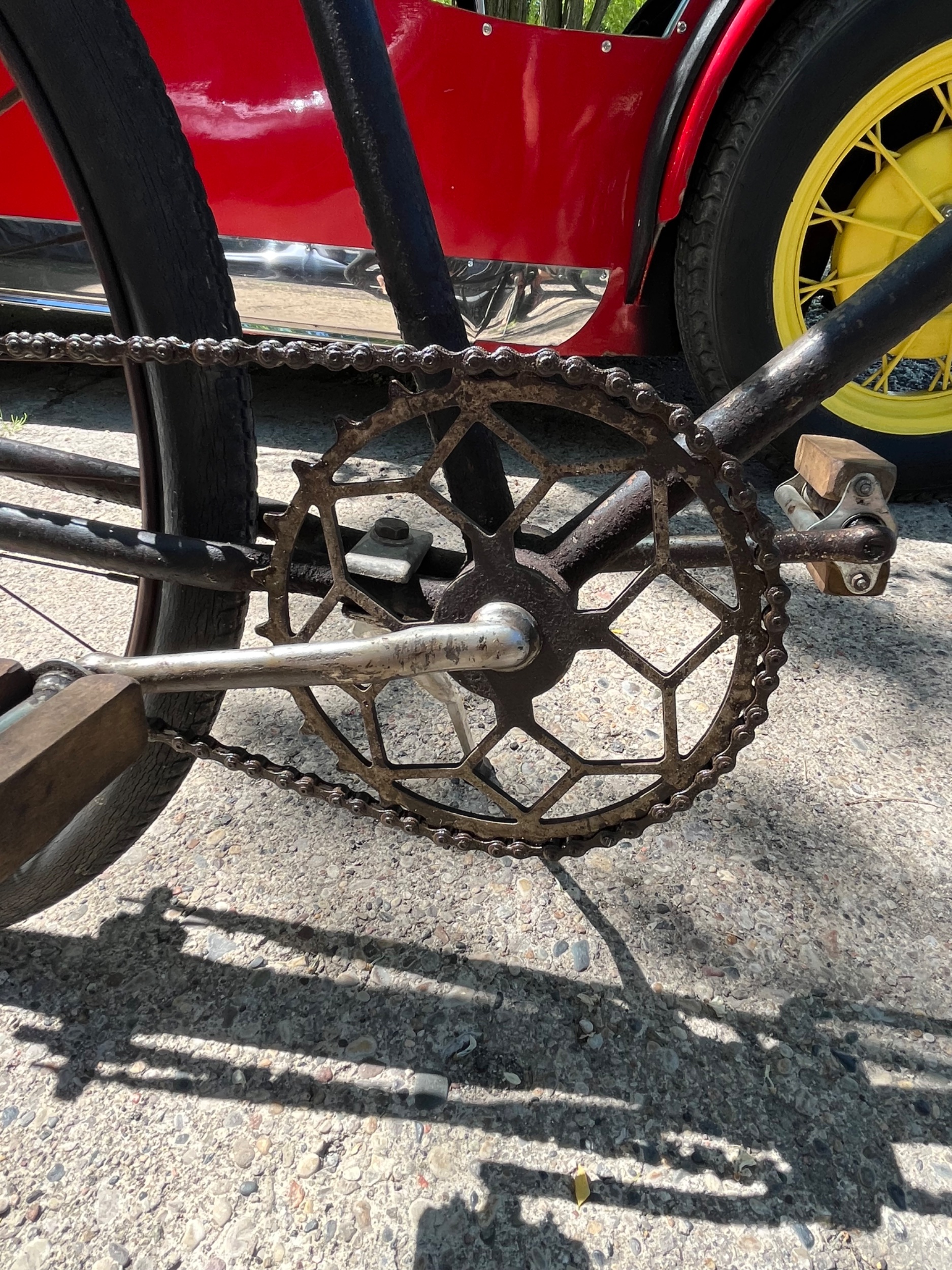

Here’s an old Flyer?! Hoping to ID it!
Cabby
Would love any insight to this oldie!
Hard to tell what all might have been replaced on the taller 24" frame.
Looks like 26" balloon (or middleweight) tire wheels on a non-balloon frame, but the front forks do not look like there is a lot of extra space for 28" tire;
(could just be the picture angle)?
Sprocket looks like a ladies or youths size by Snyder or perhaps others, but was it original?
Perhaps clean-up the bottom bracket joints area, could be Snyder (covered with crud)?
Perhaps post pictures of the usual locations of the serial numbers might be insightful?
Might lean towards a teens Davis built frame, (Sears Peerless or similar)?
Are the main tubes usual 1" diameter, or smaller for racer-type bikes (Westfield)?
I’ll see what I can find out!
has the exact same probably 'incorrect' chainring that was on my 1938 hp snyder zep,
harvard badged.
thts all I got
rad find!
The sprocket and font-style of the serial number stamping might suggest an early 1920's Excelsior Cycle Co. product;
yet the chain stays are not oval-shaped but circular?
A couple of New York manufacturers may then be within possibilities?
