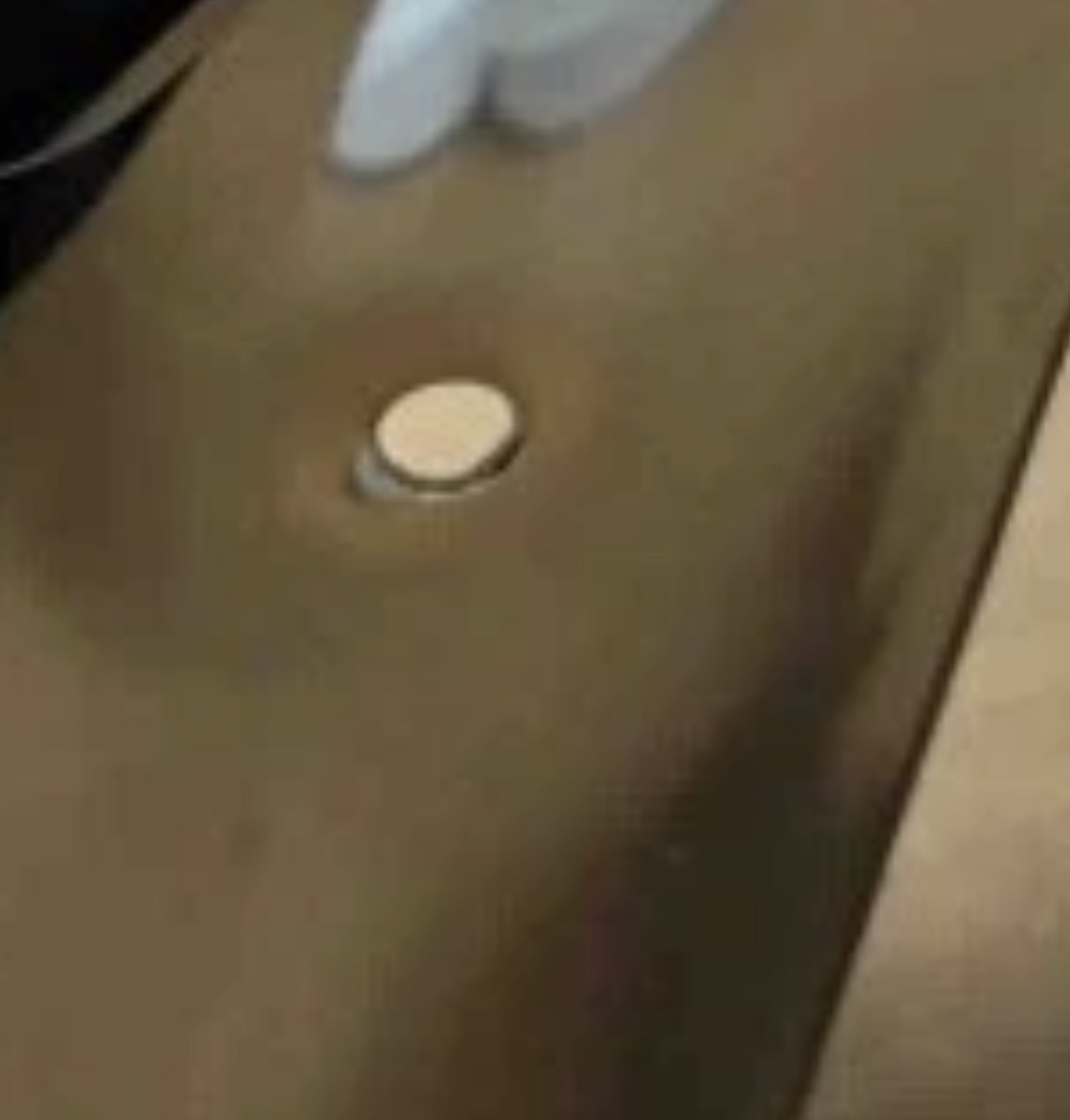

Some reproduction fenders have a soft nickel ring around the holes. Not sure why this is. Attached some photos for reference. Though this could possibly be covered up by a rivet? I don’t own any reproduction fenders so maybe someone else can chime in here.
This plating anomaly around the holes is referred to as either high voltage burning, or shadowing.
The holes were used as a point to fasten a conductive wire to the part and suspend it in the plating solutions throughout the multi step process.
If current load exceeds the capacity of the wire or fastener, voltage spikes, creating a localized hot spot in the workpiece and can produce discoloration like seen here.
The other explanation is shadowing whereby the suspension wire or fastener impedes the direct flow of current through its ionized path from positive electrode (anode) and negative electrode (cathode) and minimizes the rate metal is deposited in the space of the shadow.
Current flows the path of least resistance and material likely sees the fastener as the least resistive recipient of the charge effectively robbing new metal from being deposited in the desired space.
Apologies for nerding out but that’s the explanation and only well controlled plating processes and competent shops get it right.
