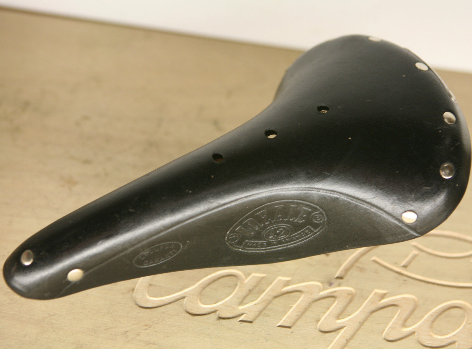

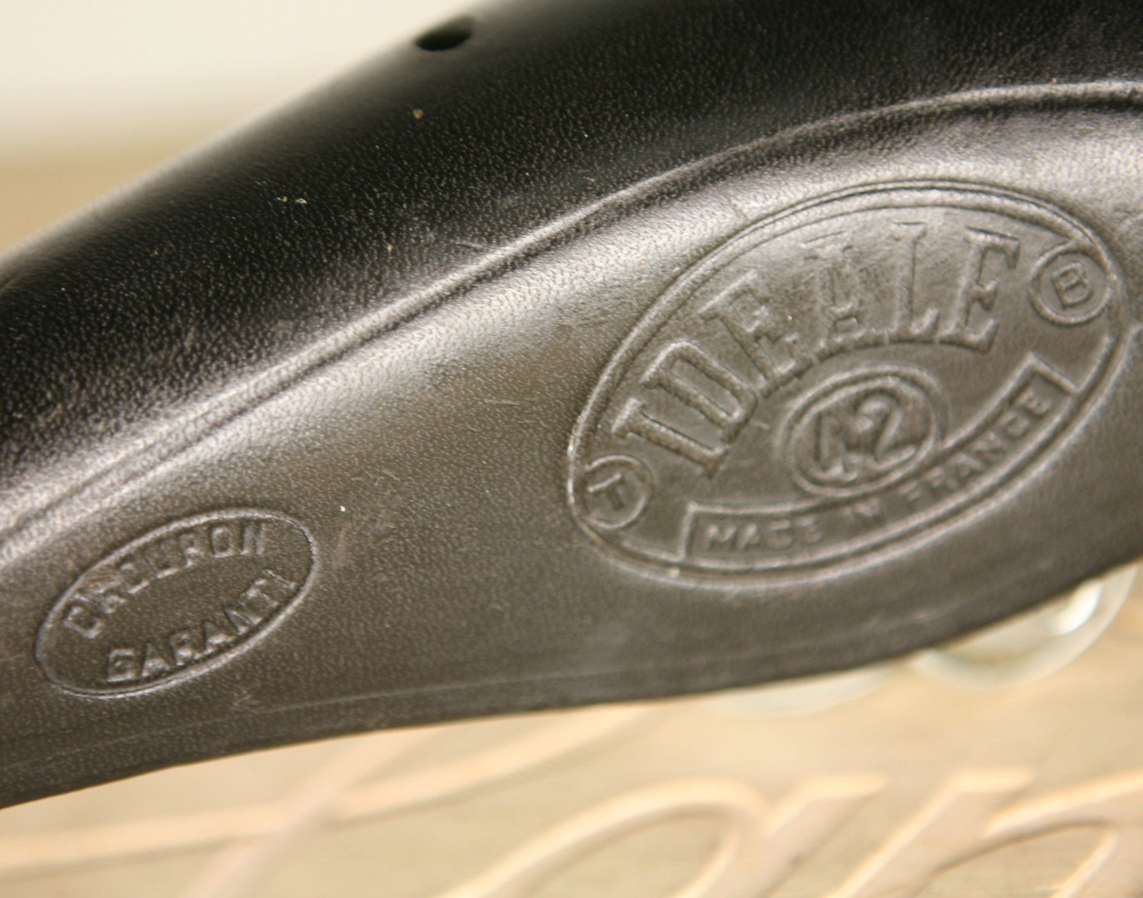

I have this NOS Ideale 42 stashed away somewhere. I found it on eBay France and had to talk the seller into shipping it to the US. Found out after I got it that it was not identical to the Ideale 42's that Schwinn used during 1961-1963. Schwinn had Ideale slightly modify the saddles that were made for them.
