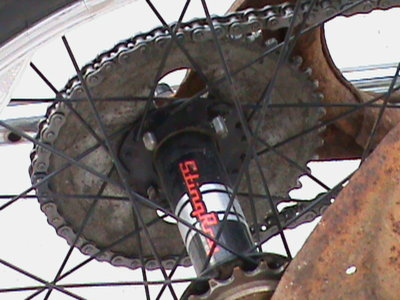

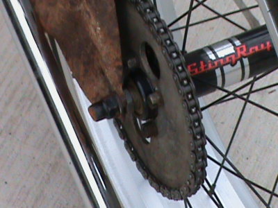

I marked, drilled, tapped and mounted drive sprocket to Stingray rear hub (thanks old sears snowblower and Schwinn for leaving enough meat to the hub to mount it).

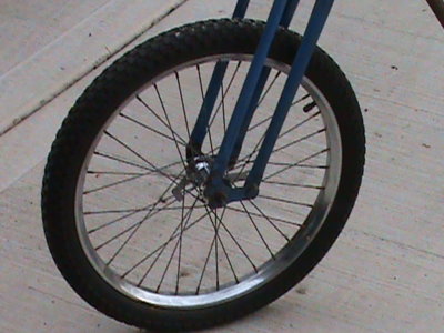

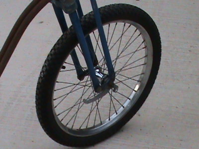

also built up 20" front wheel with a WD hub and installed that.

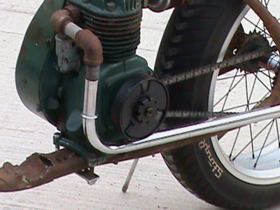

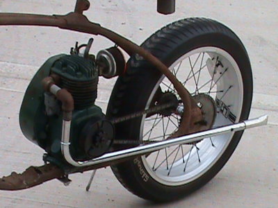

Bought a centrifugal clutch (and 4' of chain) for 39.95 shipped. Great deal. Motor mounted and all installed. Chain just clears frame!

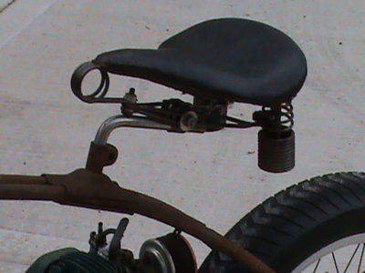

Bars and saddle mounted, but I am gonna invert twin bar's seat mount to give saddle a down low look. Added pet cocks to tank/carb also. Next is rear caliper brakes, fuel line, throttle and brake levers/cables.

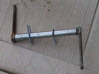

More progress...
flipped the seat post mount, really lowered the saddle profile. also moving saddle further back. Crank assy. mounted... clears everything ok. pics coming...
