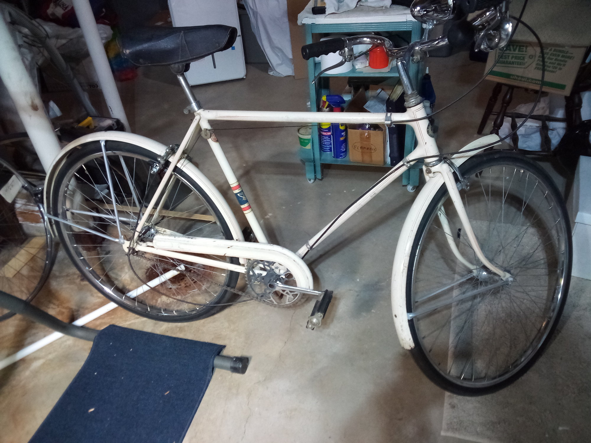

Updated list - we're up to 10 bikes now. Certainly not a common bike still. One bike has New World style paint and decals (the ivory one). All bikes are either ladies' frames or men's standard 21-22 inch frames.
The unusual ivory variation on a post-war Superior. I've only seen one post-war Superior in Ivory. It surfaced last year on Bikeforums. When done in ivory, the bike got New World style stripes instead of the chevron-edged decals.
Serial is U66938. Rear hub is from 1950.

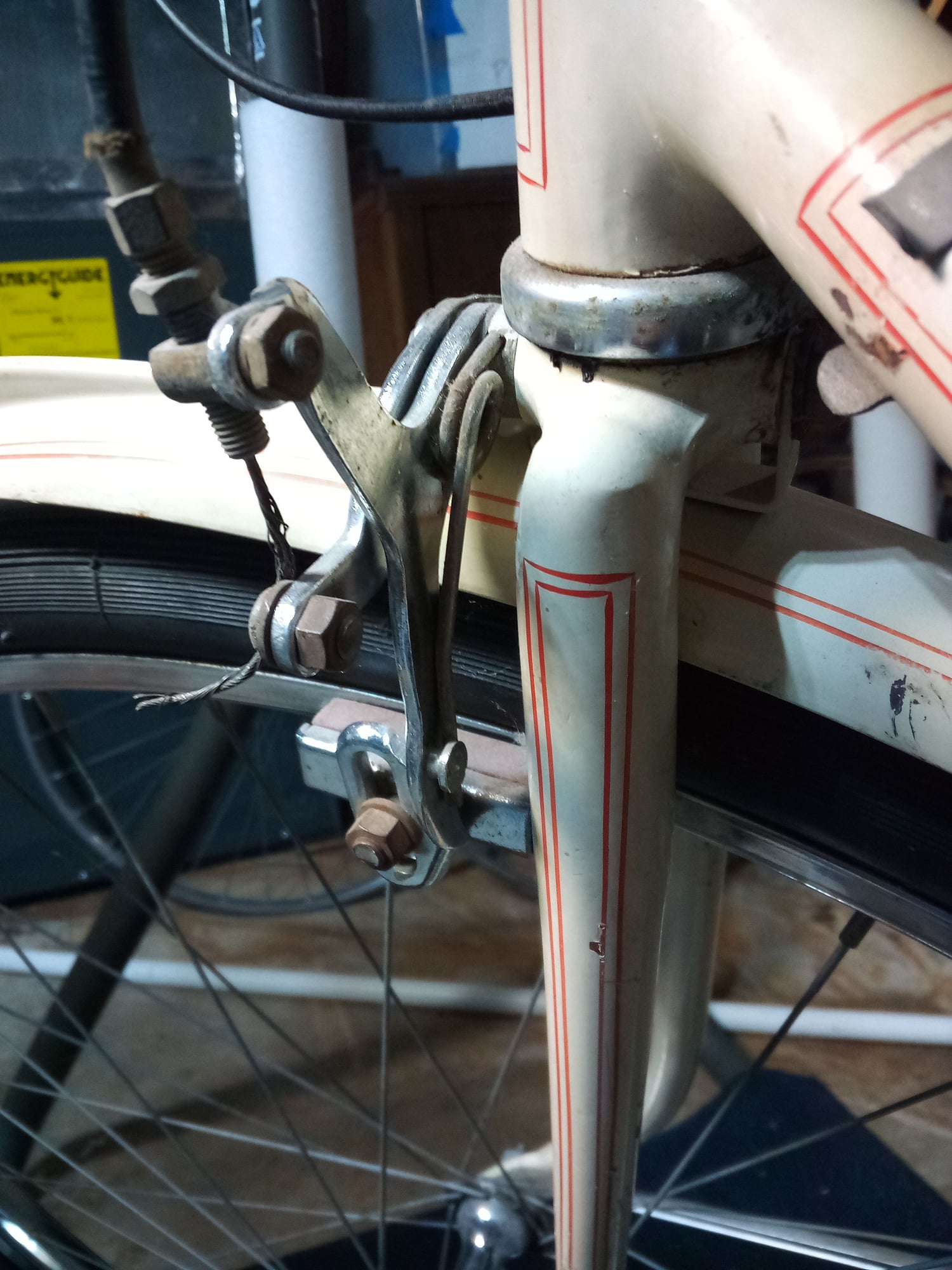

The paint on this is amazing. My thoughts on this one are really mixed, and the person that ran the new rear brake cable shouldn't be messing with bikes. 🤣
