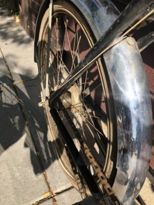

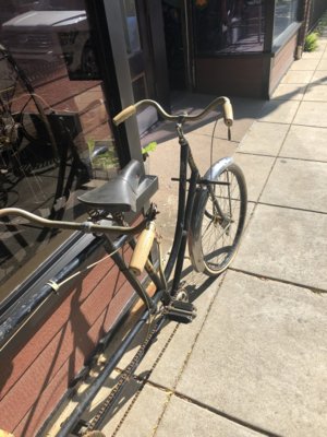

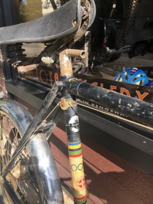

Picked up this bike and having a hard time pin pointing what it is. Things I know wheels are 51 and most likely added at this time. Fauber crankset from the early 1900. Seats are not original as they are from Italy and Germany. Fenders also added with grips and pedals (schwinn). The fork is crazy cool and can find nothing at all. Closest is a pic from Stearns ad but not confirmed. It’s in great shape for the time the guy I got it from said he bought in the late 60 or early 70 and said it was super old then.
