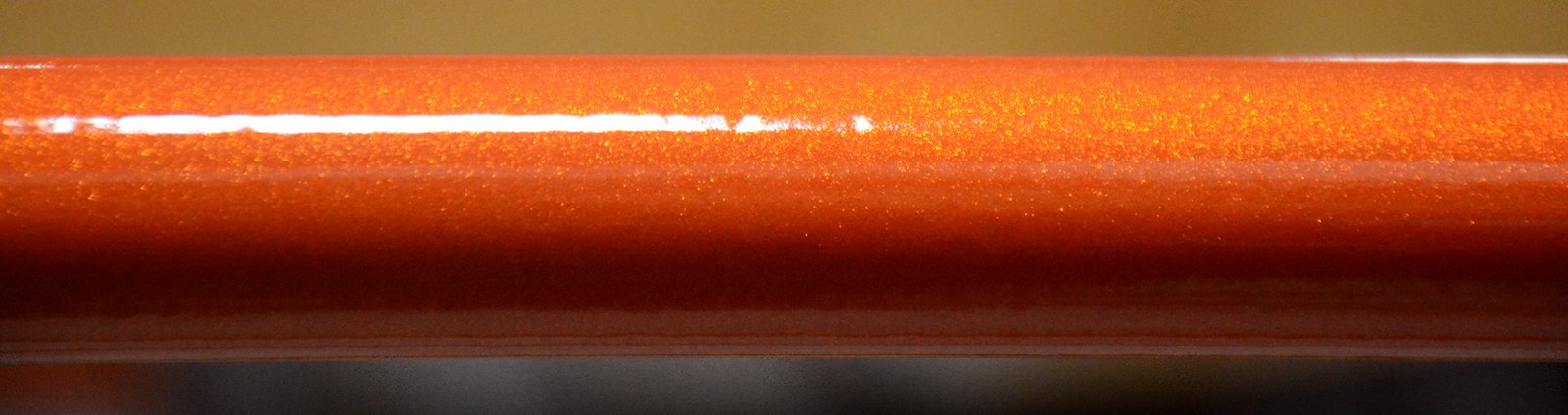

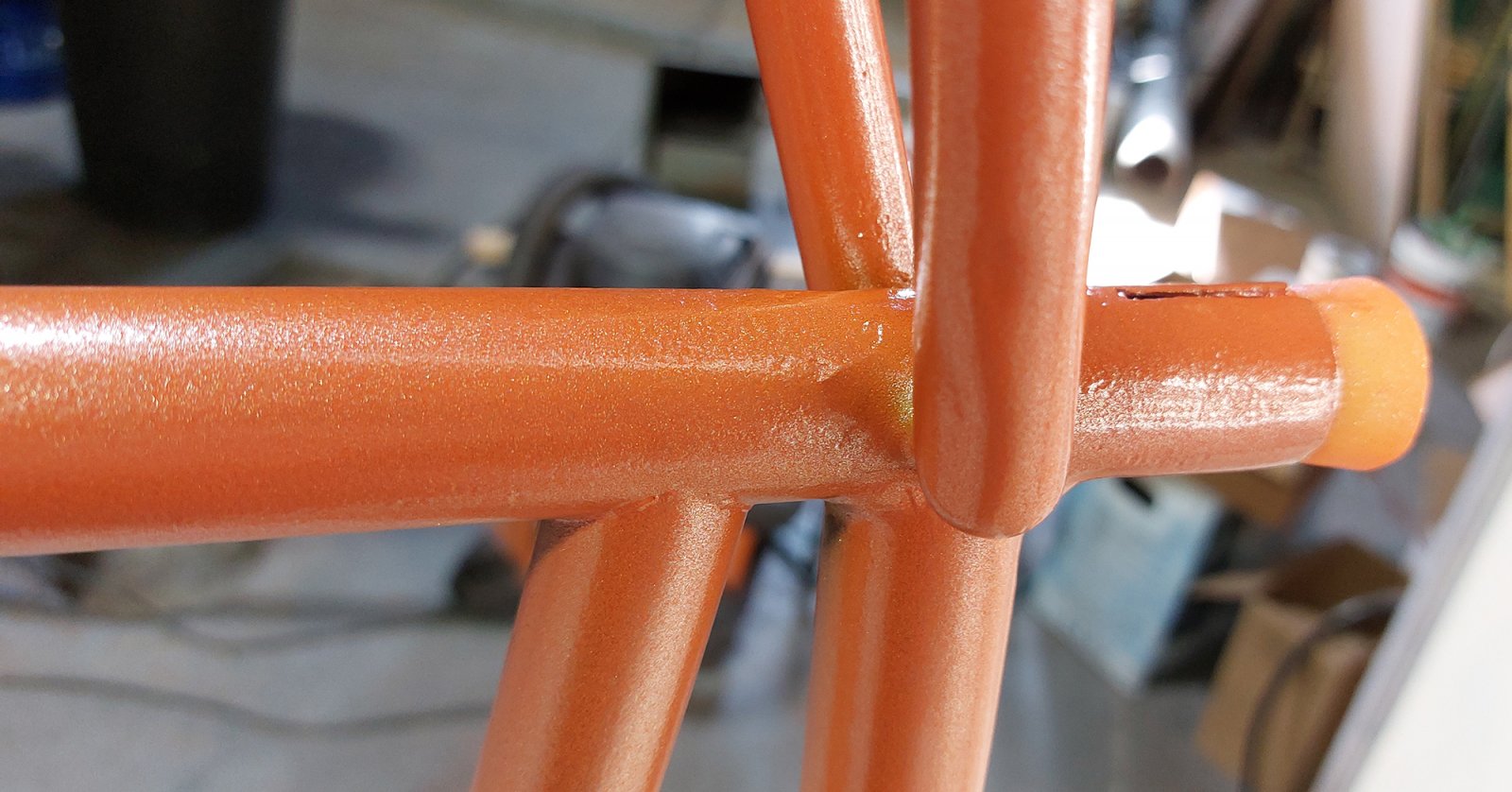

The first coat doesn't look all that great after curing in the oven, in fact some parts look more silver than orange, but that's where the second layer of powder comes in...

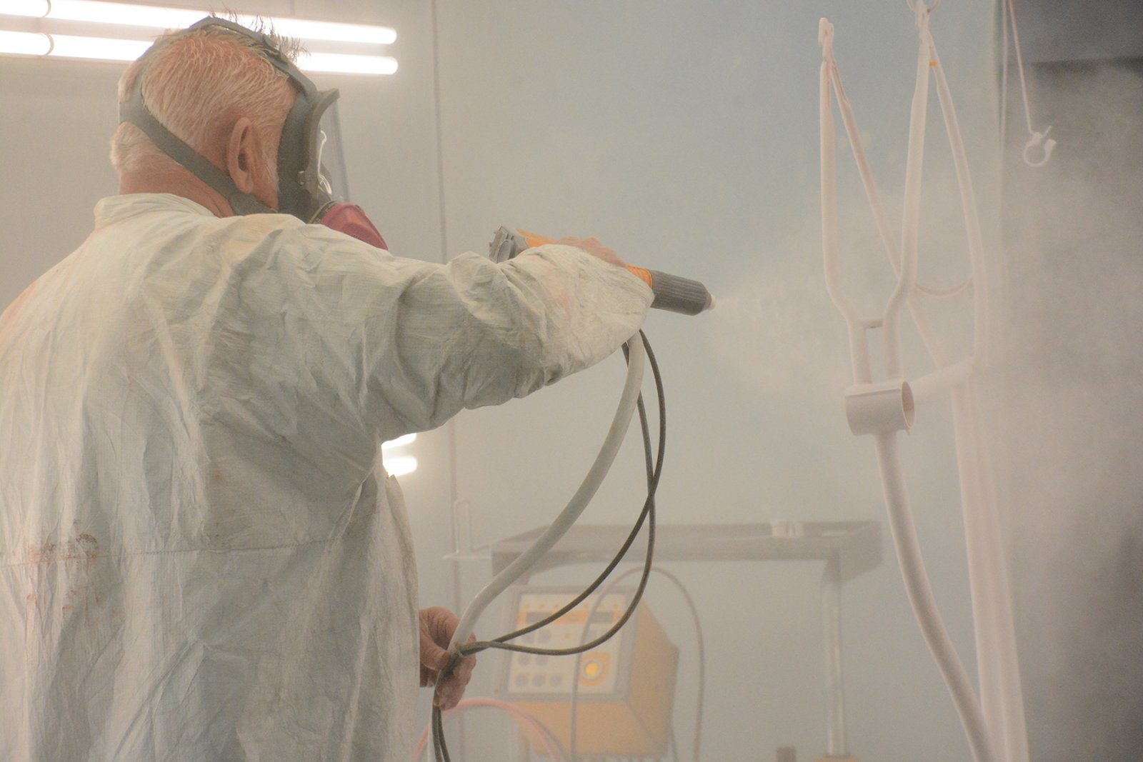

Once the first layer of powder fully cools, he applies the second layer of powder: clear coat.

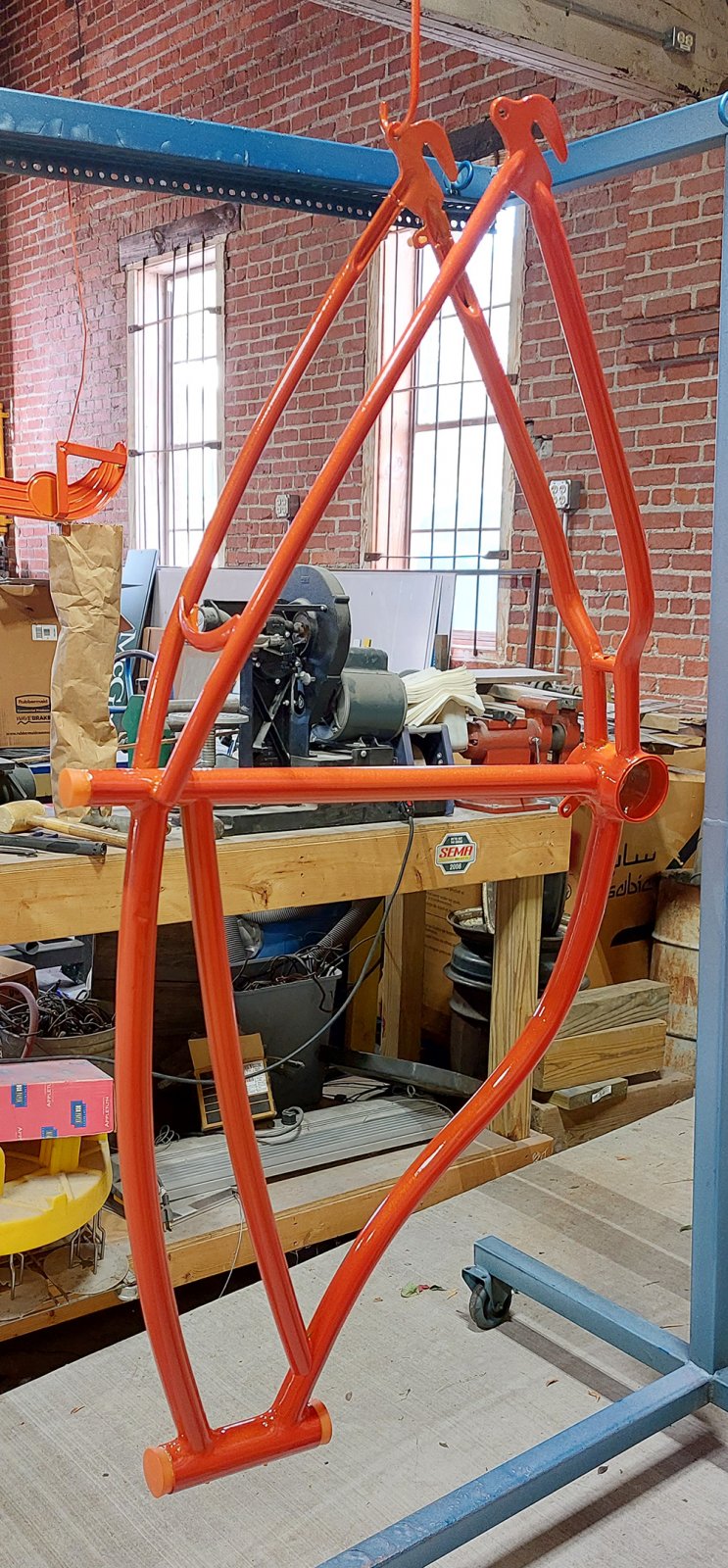

This is the result after the clear coat cures. That's when that orange really pops!
So now the parts are all powder coated. There's not much left to do at this stage, but I plan to make some more progress these next 2 days. I want to finish priming and painting the tank and tank mounts tomorrow and Tuesday while the weather is in the 60s and 70s. If I can get that done before it gets cold again, then all that's left is reassembly. I want to see if my fabricator friend can help me this time, since the last time I tried to put this bike together, the bearings weren't acting right. If he's able to help me, we might finish this bike before we start on my MBBO entry for this year.
