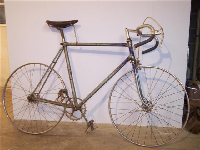

Express Werke also a maker of quality track & road cycles
Professional Modell road frame
1957 modell 65 L

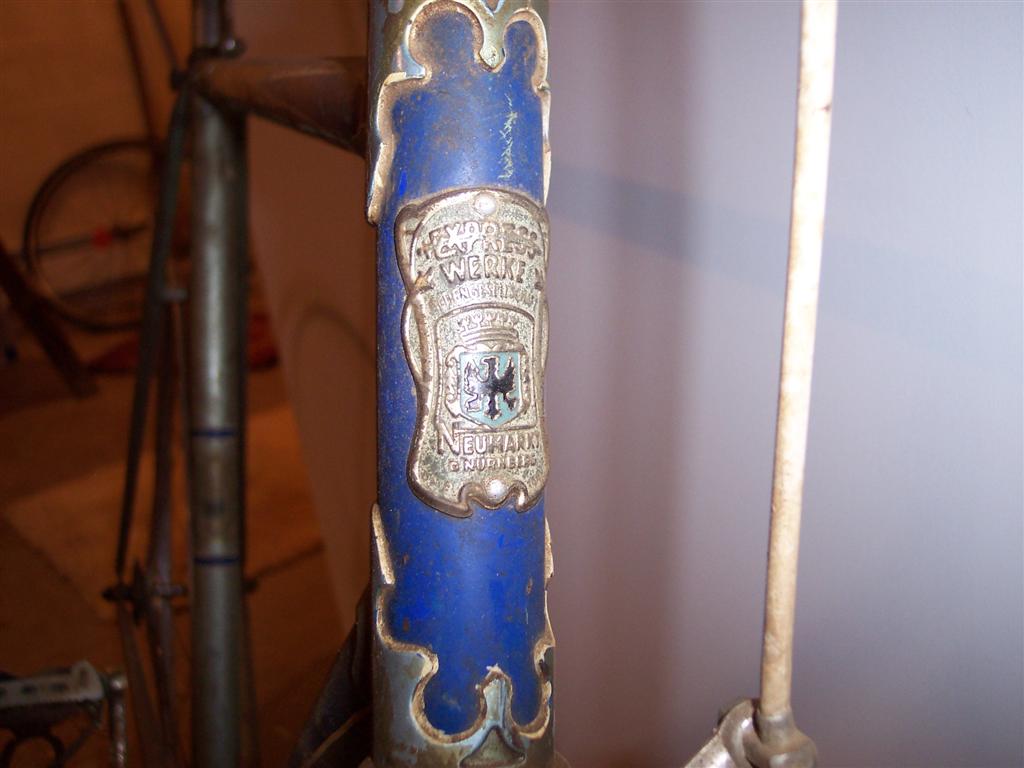

a concise company history found online -
"Express was the brand of Express Werke AG, a German bicycle, motorcycle and automobile manufacturer. Located in Neumarkt in der Oberpfalz. they trace bicycle manufacturing back to 1884, claiming to be the first European mainland bicycle manufacturer. Automobiles were produced from 1899-1910, with scooters being added in the 1930s. Production of small displacement motorcycles commended in 1949.
In the late 1950s, the decline of the German bicycle led to several mergers. In 1958 Express merged by Victoria from nearby Nurnberg (Nuremberg). The running dog on the crest and chain guard was a Victoria symbol, so this may date the bicycle to no older to 1958. In 1959 the Neumarkt factory closed, so the combined Neumarkt Nurnberg mentions on the seat tube may define 1958-1959.
Both firms were swallowed by Hercules, which was part of Zwierad-Union, eventually became part of the Sachs corporation. Apparently the Express brand continued in use until the 1980s and the original factory partially survives as bicycle museum."

@juvela now i want one of their road bikes! Is that black one with the red accents yours? It’s sexy as hell!!!
juvela
black one is of another owner
following completion of restoration it sold recently for about eight hundreds
here is an enumeration of the cycle's kitting as provided by the owner/restorer:
