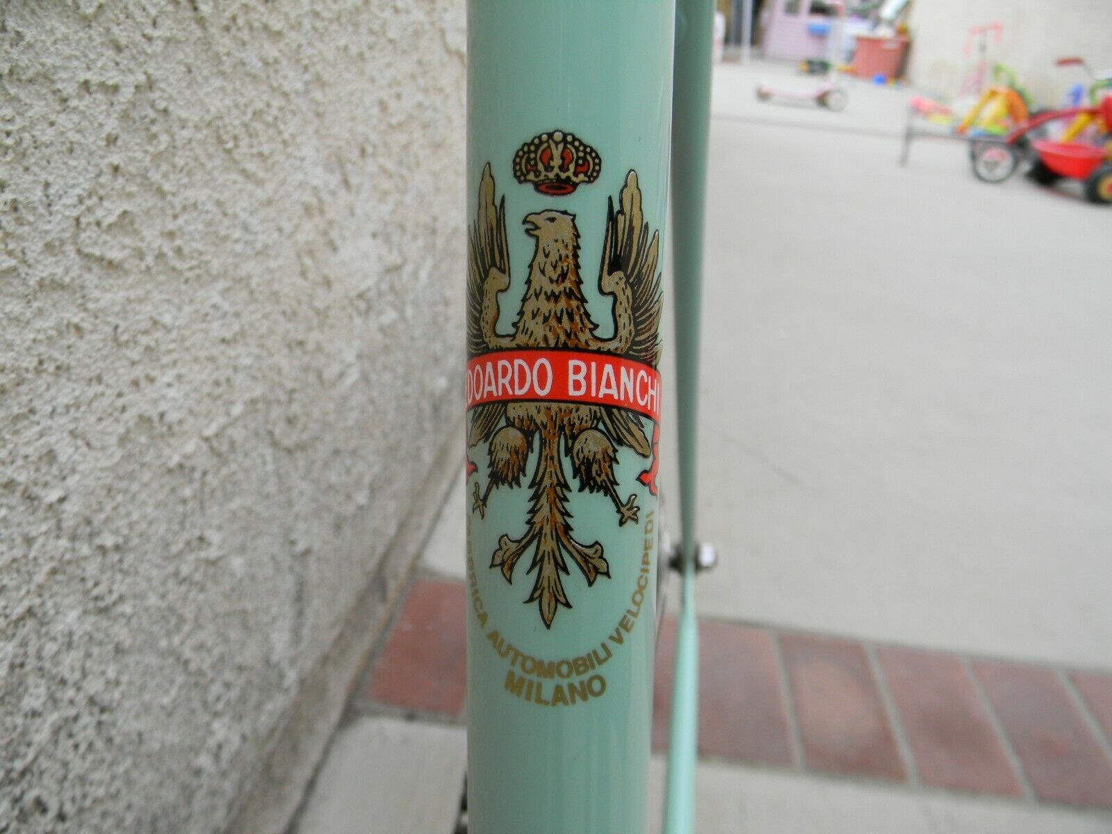

Also - any thoughts on these decals?? Correct or .....
I'm no expert but I think its a road bike and decals look more '50s to me. V/r Shawn
That’s what I thought. I’ll post pictures of mine so you can see the difference in decals etc. I know that I really researched mine in depth before I restored it.

Here's my '30's Bianchi Track iron:
I never had tires on it but you can see that if there was then the tire is closer to the seat tube. Plus - REAL Track frames have rear facing dropouts!
I also think his is more '50's as it has chrome lugs and I thought they didn't have the chrome lugs until the 50's. I could be wrong but all my study and research lead me to believe his is a little later than he claims but definitely his is not a true track machine with those forward facing dropouts. It would never be allowed in real competition!

First off , the chromed lugs. I wouldn’t expect these to have been chromed originally but the frame has been refinished. So they look correct in their design for that era but I think should be painted.

Without frame numbers I can’t be date specific. The restorer has done a good job in terms of colour and crest decals (down tube decal is later) but I would prob only expect chromed dropouts although if a track special i can‘t be definitively correct . This is a tricky one to say the least

The restoration work (from colour choice to decals) is totally wrong. The majority of components are good for a mid 50s bike, not a late 30s one.
@corbettclassics I highly doubt yours is an original Bianchi track bike, sorry.
