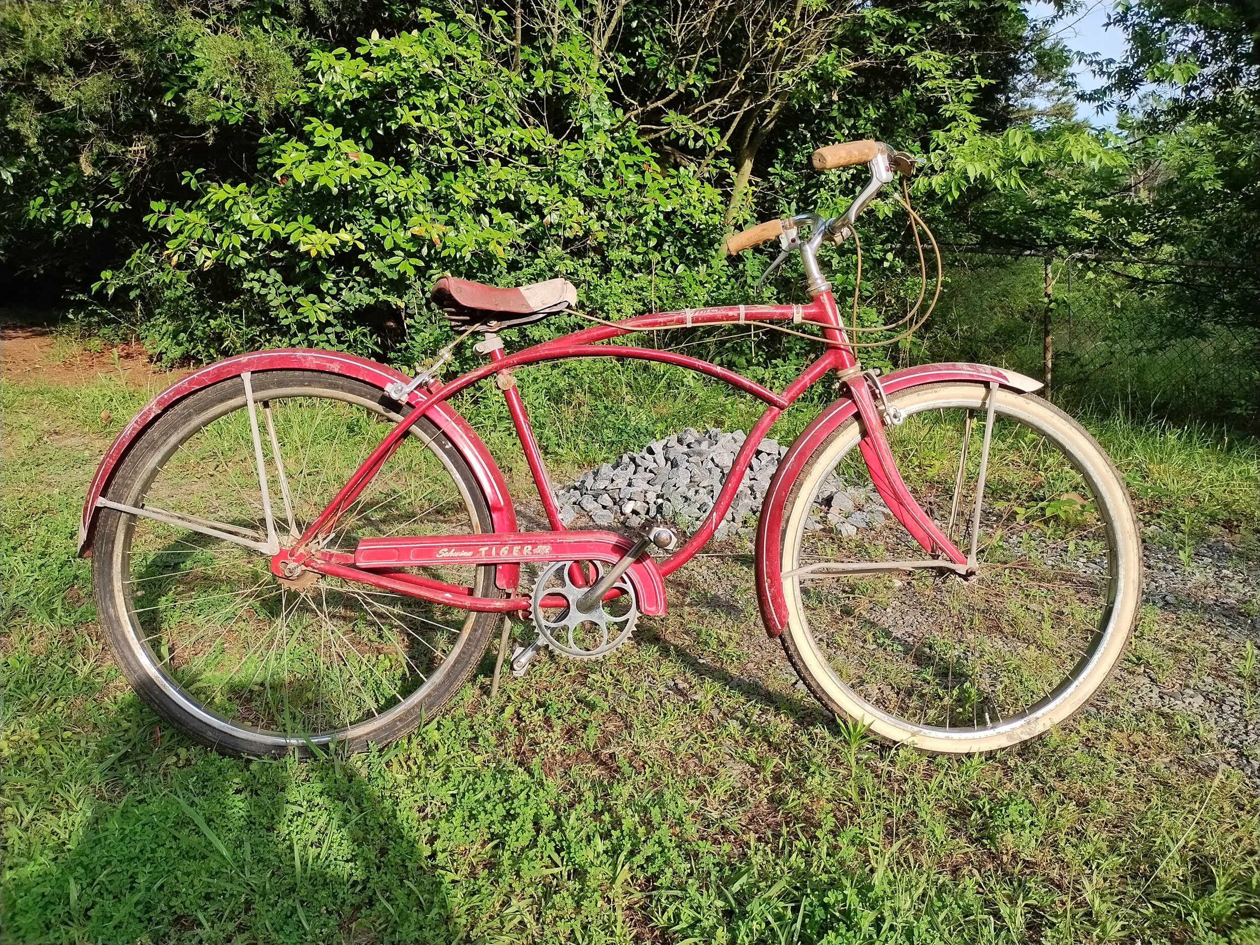

My Tiger (now totally disassembled) had been ignored and forsaken but it was all there and I don't remember any evidence that it had been tampered with except that the rear caliper had been replaced. (please see below)

Nice Tiger! I have to agree it looks very original, but wouldn't the shifter cable have been gray? And that's a good question about the pre-1959 middleweights, I'll have to check mine and see if there's anything that sheds light on this question.

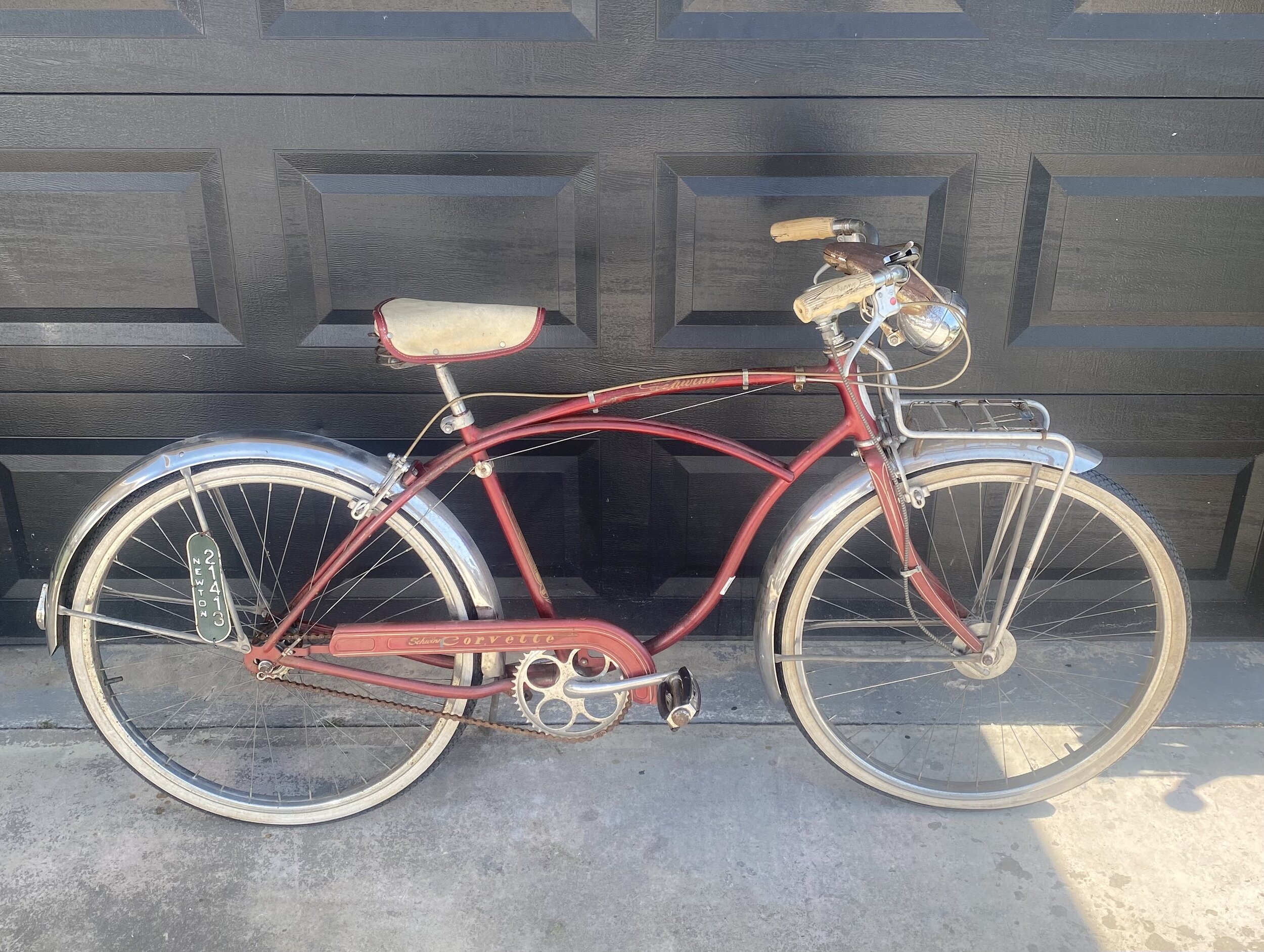

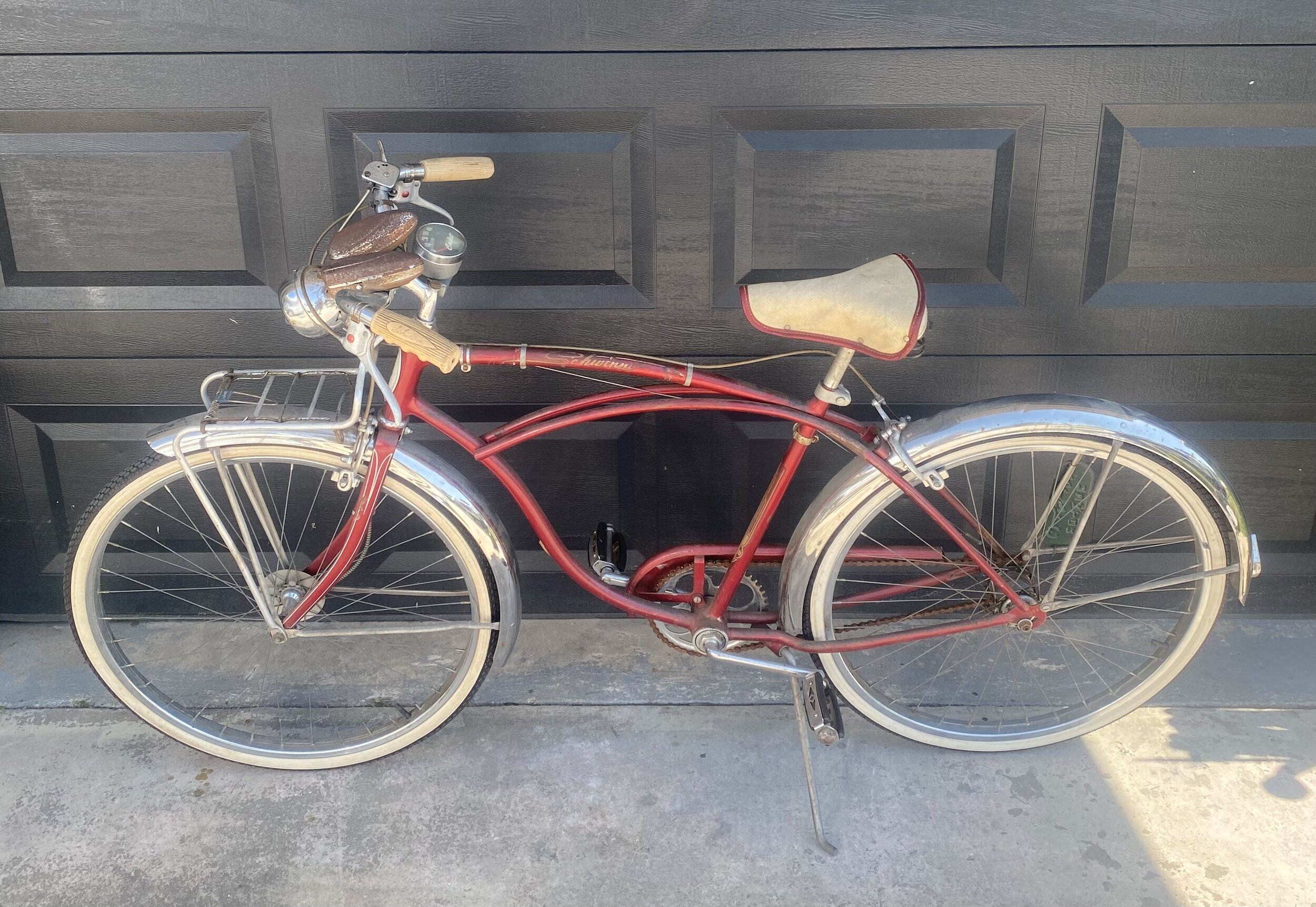

I scored this 1957 SCHWINN CORVETTE today had flat tires put a little air in them and they hold air another score rides like it should and even shifts without a problem unfortunately the speedo doesn’t work 😔 and has the wrong seat
Is there anything else that doesn’t belong on this bike or is it just the seat and license plate??
When I clean it up and getting everything right what would one thing like this go for?
@stelber1987, going back through this thread, I started wondering what kind of hub is on your bike? I don't know exactly when Schwinn started using the Sturmey SW hub, or how long it took them to realize there was a problem, or to make arrangements to get hubs from Austria instead. Most of the bikes with the Austrian hubs have an oval shifter but I've seen a few like yours and my best guess is it's an earlier version. Even if you've got an Austrian hub they're not dated, so we may never know for sure whether it's original or not, but at least it would be another example to consider.
