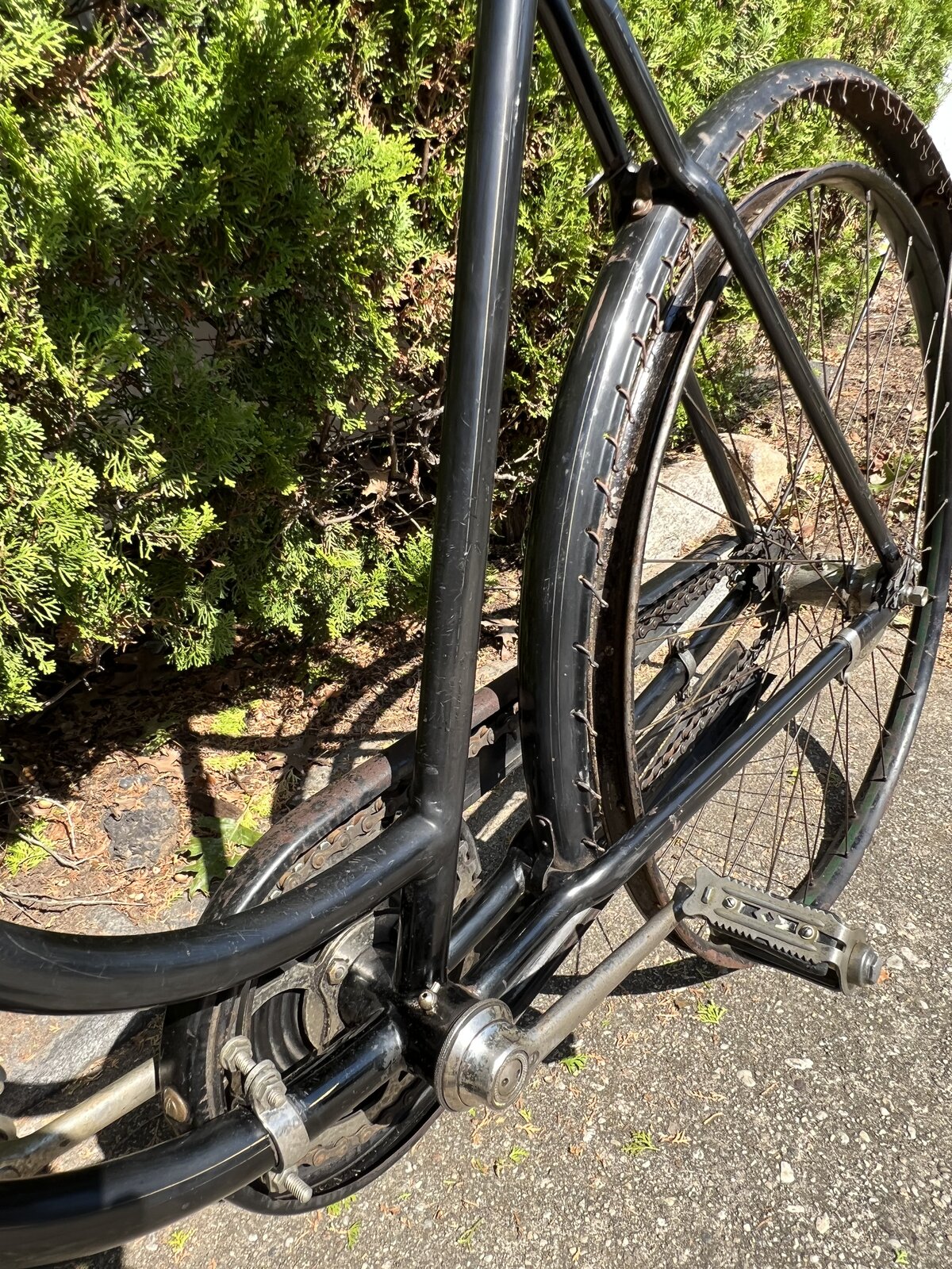

Can anyone identify the maker of the pedal in the last photo?
Yes, those are Wippermans, form Hagen, Germany - the company is still in existance today - although they dont make pedals anymore, but still chains , for bicycles and industrial appliactions.
Wippermann pedals were widely used in Europe- this design came up around 1900 and was used into the very early 30s.

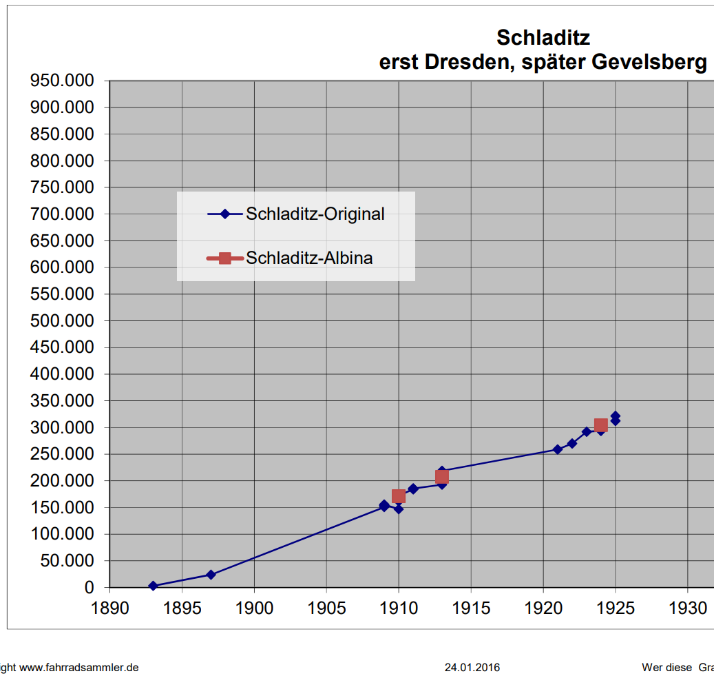

Schladitz was condisered as a high-end brand ("Markenfahrrad") but produced relatively small numbers - they made many components themselves, but had no pedals of their own, so I'm certain these pedals were originally equipped with your bike.

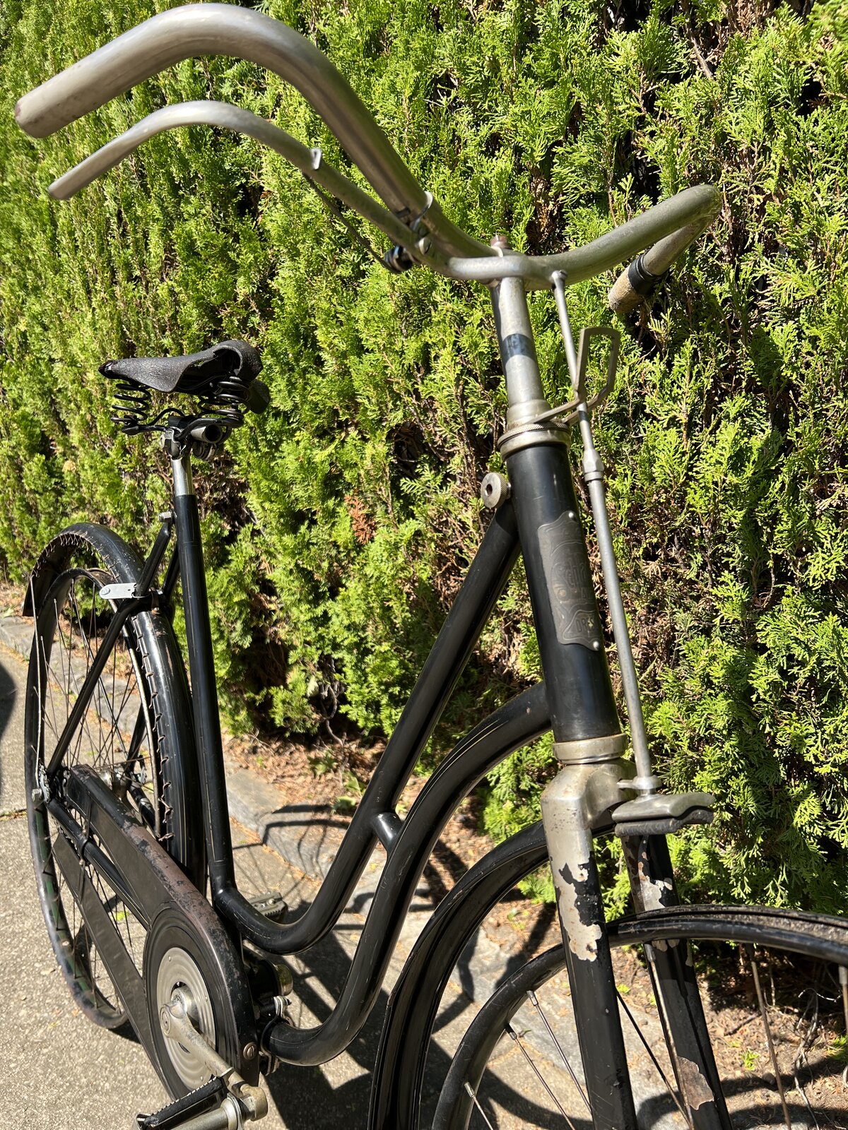

Any by the way, Harpo : this bike is fantastic - and all parts seem to be original:
The lamp-bracket, the front brake assembly , fenders + fender brackets are all special Schladitz-design - nothing has been changed. Great
You also did a great job in preserving the lady - no overpolishing, just cleaning and maybe some wax (?)...

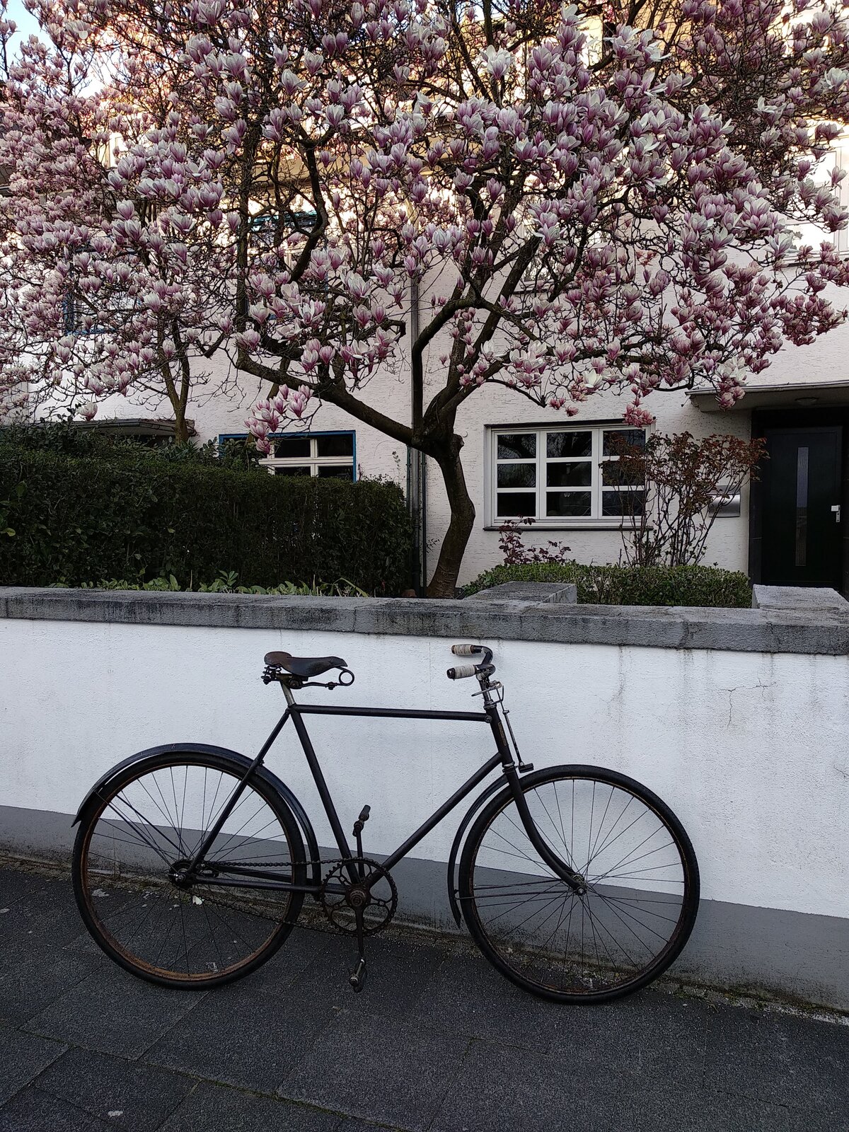

Here are a few photos of mine:
