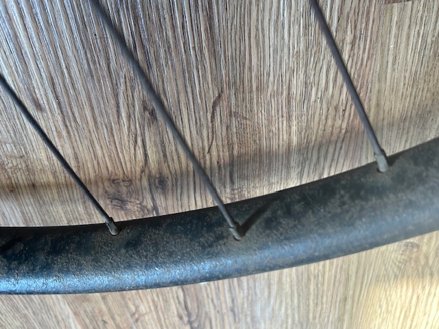

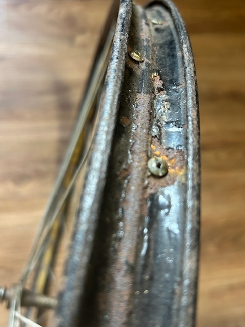

I have 2 rims that are similar to yours
but they seem to be slightly different sizes.
They will not accept the same size tire.
One is 33mm wide and seems to accept a 622 BSD tire.
approx 25 1/8" total diameter
It also seems to have some kind of weld bead on the middle of the inside
(yours appears to have also)
The other is 32mm wide and is too big for a 622 tire.
approx 25 3/8" total diameter
A 635 tire fits but is a little too loose.
I am wondering if this one is a 630, and is that what the Rubenas are?
