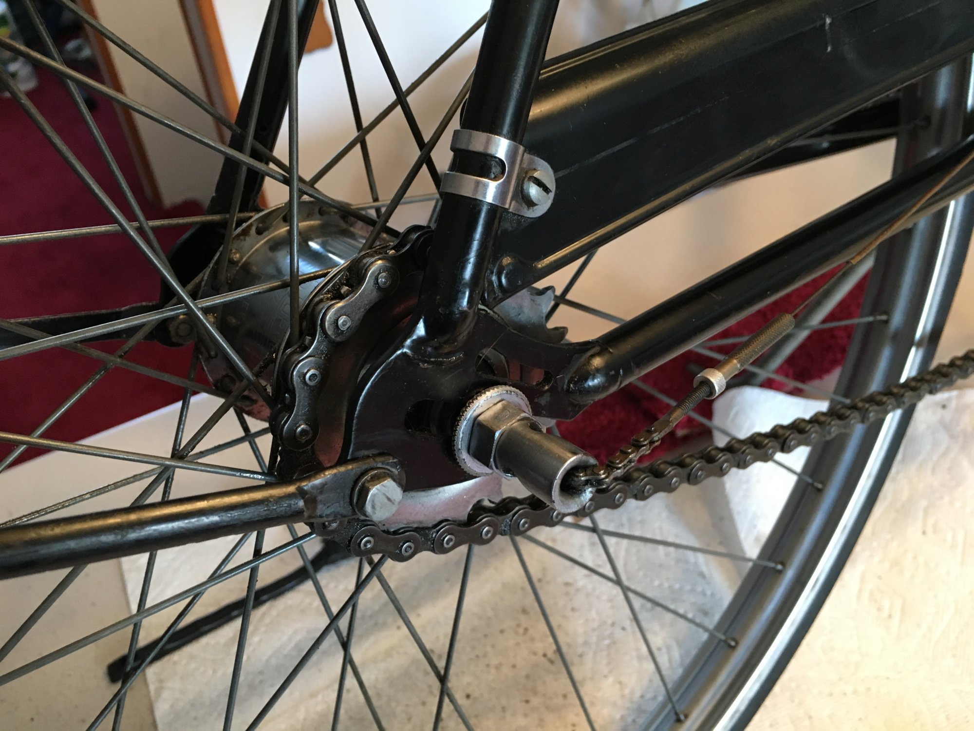

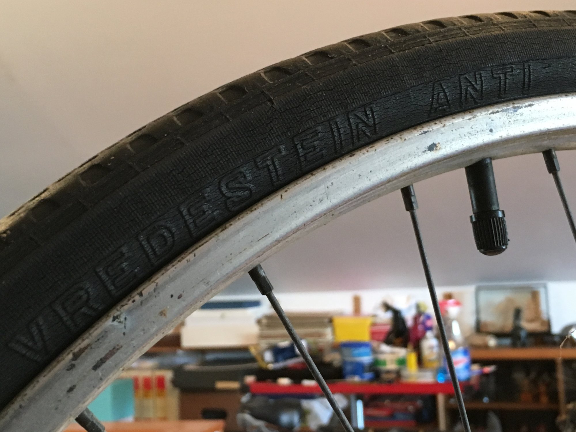

Here I go again...another RUDGE...but older this time. The other one (shown here on THECABE) was from 1968 and a Deluxe model.
This is now the oldest English bike I have, and just 4 years newer than I am. It's in very good condition, and except for the Hunt Wilde grips and tires appears to be all original. End cap is missing from one of the pedals, also. What's cool on this bike is the opening for oiling the bottom bracket. The cap is missing, but I'm sure all is well inside. The wheels spin freely (chain came off removing the bike from the SUV) so at least that's a good sign. Brooks saddle is a little cracked, but hey, it's been used!
I'm looking forward to doing a nice detailing and taking it for a ride. Who knows, maybe I'll get lucky and find its mate.

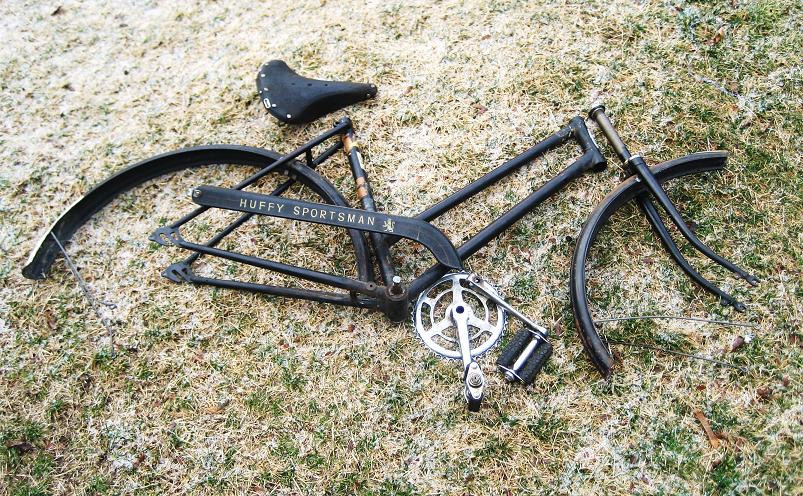

I thought you may find the Huffy version interesting to see. You can see the English lion on the chain guard, and it also says made in England in very large letters on top of the down tube. I bought the bike primarily for the Saddle, and used some of the parts to get a vintage male framed Raleigh back on the road.
In the future, once I have time I will list some of these parts in the sale section (minus the Saddle) for anyone who might be interested.

The Huffy shown and the Rudge are similar, but are not the same bike with different badges. The Rudge shown has the higher-end brazed fender stays; slope-shouldered/heavy-duty Rudge fork rather than the general-purpose flat-top fork; Rudge/Raleigh pedals rather than the waffle block general purpose pedals; Rudge has pump pegs whereas the Huffy doesn't seem to have them. They started out as the same basic platform - the "Sports light roadster" concept, but the Rudge was considered a "high-end" bike, whereas the Huffy was a re-badged version of the budget Raleigh product (AMF/Hercules and Nottingham Phillips used similar).
The Rudge here looks like a larger female-sized frame. 19inch and 21nch female frames were common, but there was a larger 23-inch female frame you could buy as well.
Interestingly, the Rudge pattern fork is about the strongest and best fork on these types of bikes. The old parts catalogs show that the Rudge-style fork was offered with Raleigh decals if you busted your original fork and wanted something "heavy duty". I have one of those heavy-duty replacement works of Rudge pattern but with Raleigh decals in my parts bin.
The badge/brand you got depended on how much money you wanted to spend. If you wanted a premium bike - Rudge, Raleigh or Humber. If you wanted the economy version - AMF/Hercules; Nottingham Phillips; Huffy. They all ride pretty well. At the higher levels, each had a little more character (Humber duplex fork; Rudge heavy-duty fork; Raleigh thimble fork; etc).

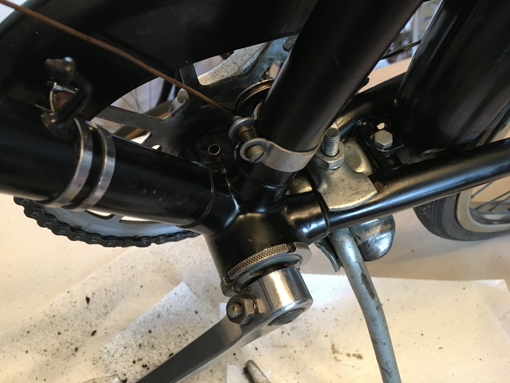

The oil filler cap is METAL...unlike the plastic on all of my Raleigh's and 1968 Rudge...

Very good find!
Thank you for posting.
Coming right along most nicely.
You might wish to keep an eye out for a Shuresta propstand for it.

I noticed those stands in a few of the Rudge Catalogs I had found from the 50's. The one on there now is the same stand as the Raleigh's I have.
