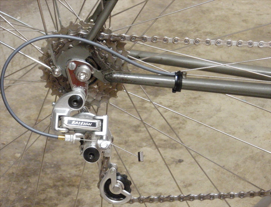

I bought one when I was designing my sleeper Lenton to look somewhat period.
But it was so heavy, I opted for Raleigh-branded VGT instead.
Valentino is steel Campy.

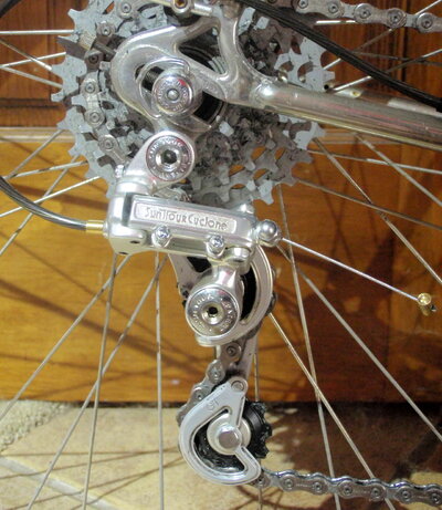

The performance of the Sun Tour mech far exceeds most Pre-'90s Campy regardless of weight. Any offset/drop/slant derailleur I have used to replace ANY Campy inline mech has always resulted in better shifting. My favorite performing pre-'90s Campy mech is the Athena; heavier, and much cheaper than some other Campy units, but out performs them (unfortunately, not appropriate for this bike's period).
I could get on my SunTour soapbox, but their 1964 patent was copied by everyone when it expired, and by Shimano 2 years before it expired.
Campy was the last hold out, trying complicated mechanisms for dual-axis movement, such as Croce d'Aune, but they broke down and copied SunTour with '88 Chorus - admittedly, Chorus was a better SunTour. Every RD made by everyone today copies SunTour's 1964 patent.
I'll give to Shimano they make the best FD, with chain-lift designed into their cages.
I think Cyclone looks appropriate on any bike, and you can't go wrong here.
SunTour V was available in '72, and came on several Motobecane mid-range models.
