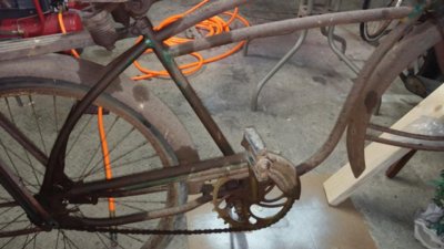

The Chain-ring/ drive sprocket appears to be lady's only. I've searched tons of photos but none on boy/men's bikes.. for lack of a name i'm going with: Skip tooth 'turbo or cyclone hearts' Chainring.

Skip tooth seems to have becoming phased out by 1950, and this frame has the "transitional" spot welded and brass rounded joints. Noted earlier as an indicator of 2nd generation of post war beginning about 1944-49. I did not remark because it's obvious in the photograph. top bar spot wield cross bar brazed.
I might of considered this frame to be a left over, but, really not likely as it's indicating all of the bonus points of being girls 2nd too the top of the line, which would be having a springer the top of the line. . . Curved Fender braces, special feature flat fender mount spot for light, rear carrier rack, truss rods and grips. which means also most likely to have had a tank. Those features put it 2nd top of the line types sold, and it's very unlikely top of line would be made with out-dated frame/parts. (turbo heart skip-tooth, combo brazed-spot wielding, and pre-war chain guard.)

It is indeed a 1950 frame. The particular dropouts on your frame didn't start until 1950. CWC used skiptooth drivetrains as late as 1956, with only the top deluxe bikes switching over to 1/2" around 1948. This bike has been assembled from several other bikes, which is why you haven't seen one exactly like it. The fenders are from an earlier CWC bike, due to the curved braces. There's one straight brace probably because the curved one would not fit correctly on the frame it wasn't designed for.
