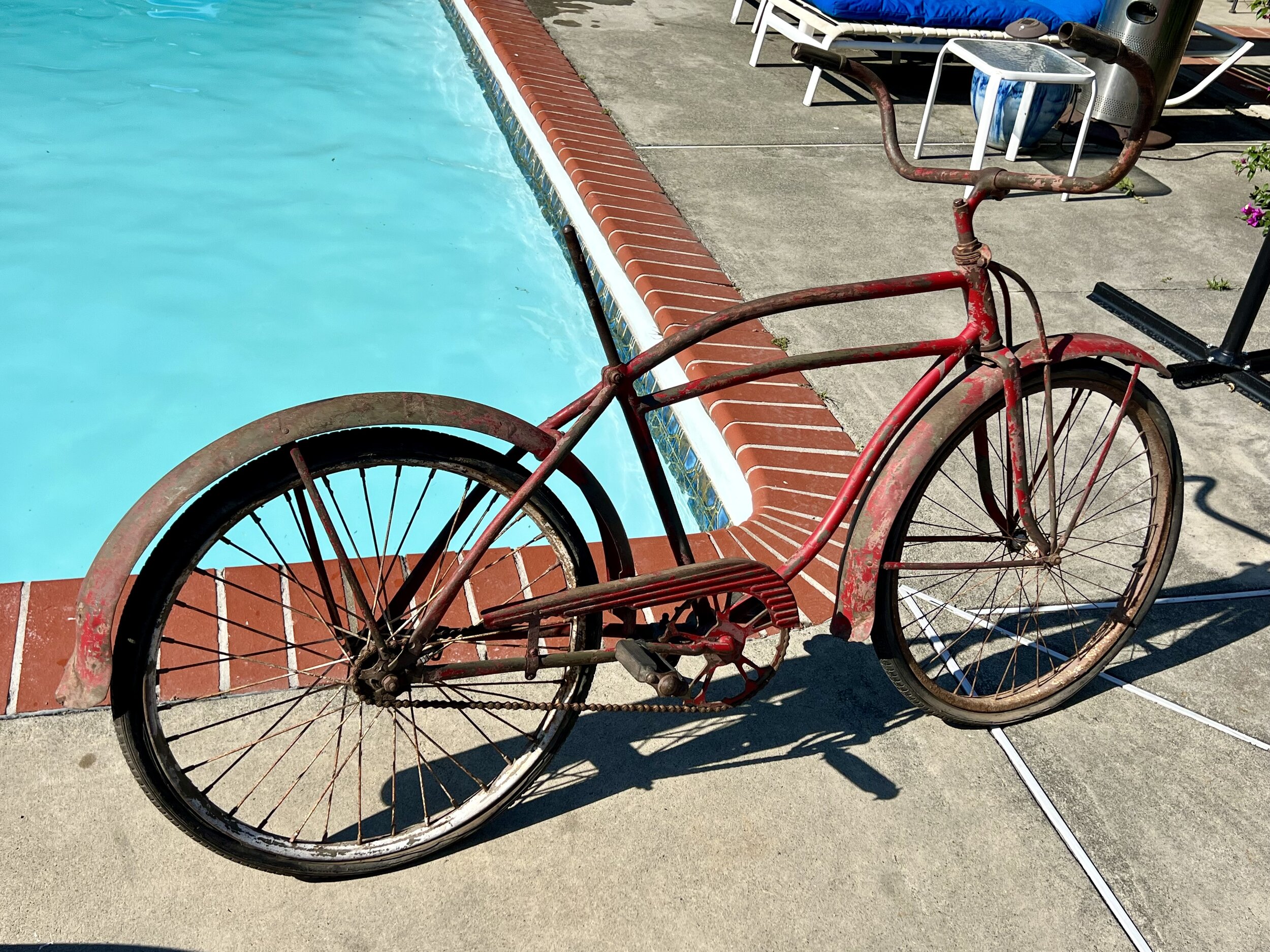

Hi All, and especially Jimmy @jimmyjambo43
Jimmy posted the G519 he discovered, in the Westfield Serial Numbers thread yesterday. Post 56 and after...
This is a long post to discuss an unusual bike. I have started a new thread, because it will be lost in the Serial Numbers thread, and deserves one of it's own.

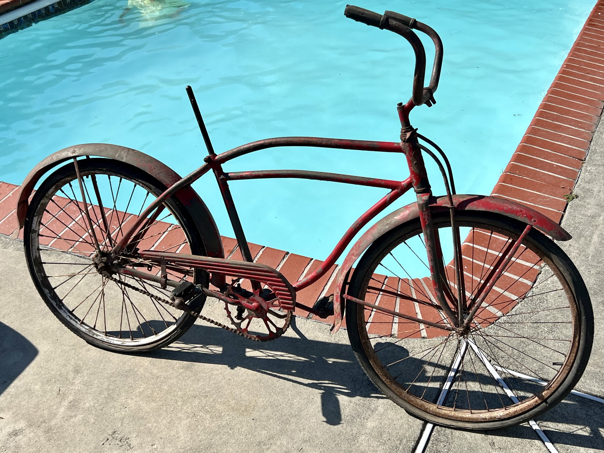

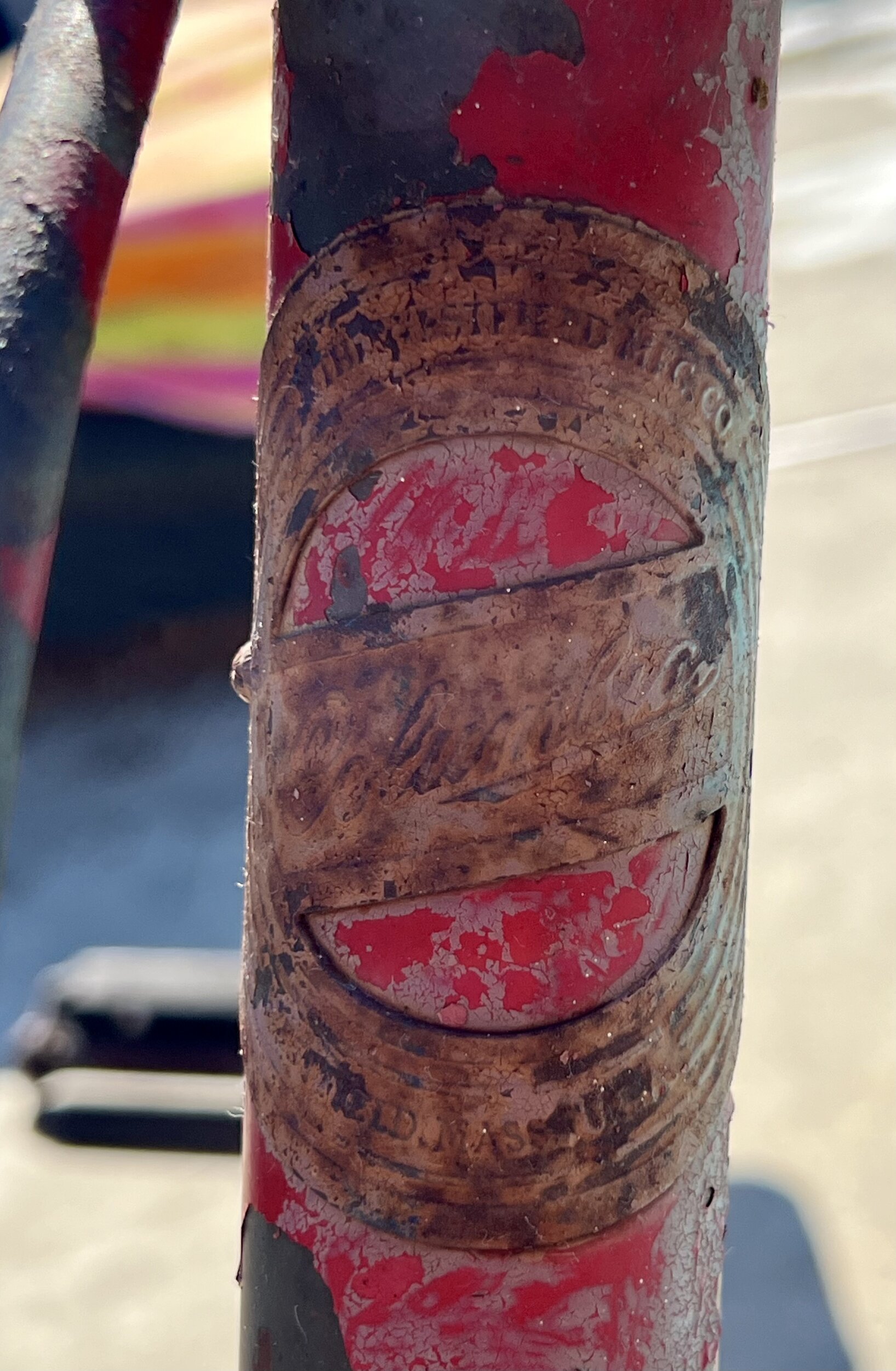

Jimmy thought (with good reason) that it appeared to be a 1942 G519, and put up a nice set of detailed photos showing what is an original G519, nearly complete, with the green paint showing in many places below an old red paintjob.
It is obviously a long neglected bike, but in quite good condition overall, although missing a saddle and original front wheel.
I have no doubt it is an original G519, but not made in 1942, but in June or soon after, 1945.
As Jimmy said, at first sight would seem to be 1942, with the early curved downtube, steel badge (I would have guessed brass for an early 1942, but this is close to the changeover point for these), coffin chainwheel, and the number MG46352 fits into a known batch of G519 built around March 1942 (see list extract below, showing where it should have fitted in).

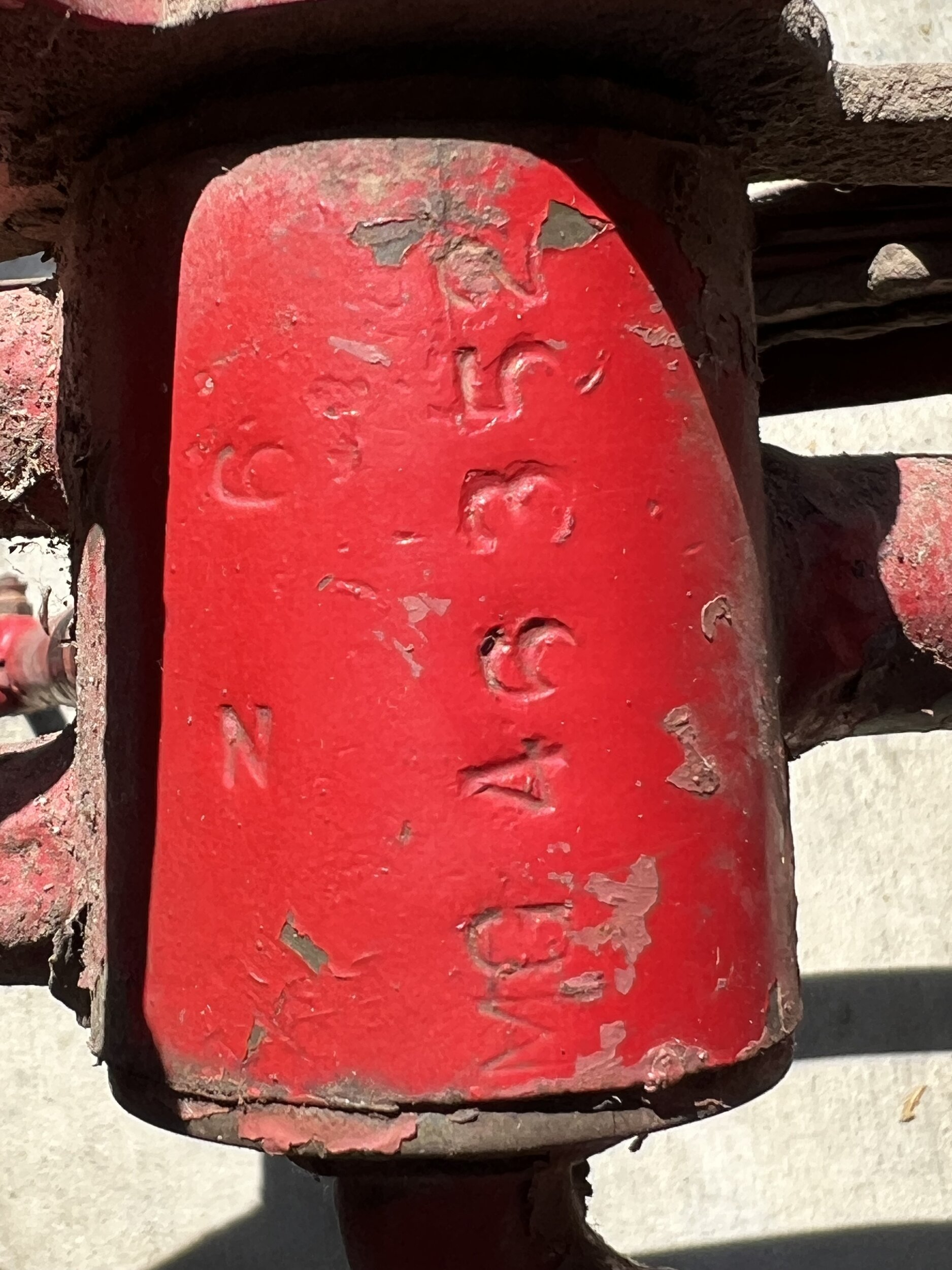

However the code for the date of manufacture of the frame is N6, which is June 1945, so it cannot have been made before this. 1942 bikes in this sequence are normally J2 or J3. (February to March 1942).
I considered whether N had been stamped by accident instead of J, but then the 6 would also have to have been stamped by accident, otherwise, for the normal serial number sequence for 1942 to continue, all production would have to have stopped for three months. Not very likely.
So, I will assume for now that N6 is June 1945, although I have not seen an N6 yet, coding stopped about this point, and the latest I've seen is an N5. The letter reversed or on it's side occurs a lot with the 1945 code, and I wonder if it is an indication of who built which frame, or the week of the month. I need to work on that.

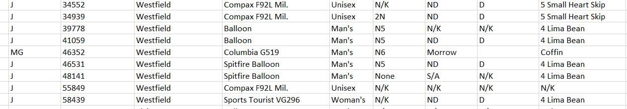

Below is an extract from my list showing where 46352 in 1945 occurs....
You can see that the number 46352 in 1945 could be an N6.

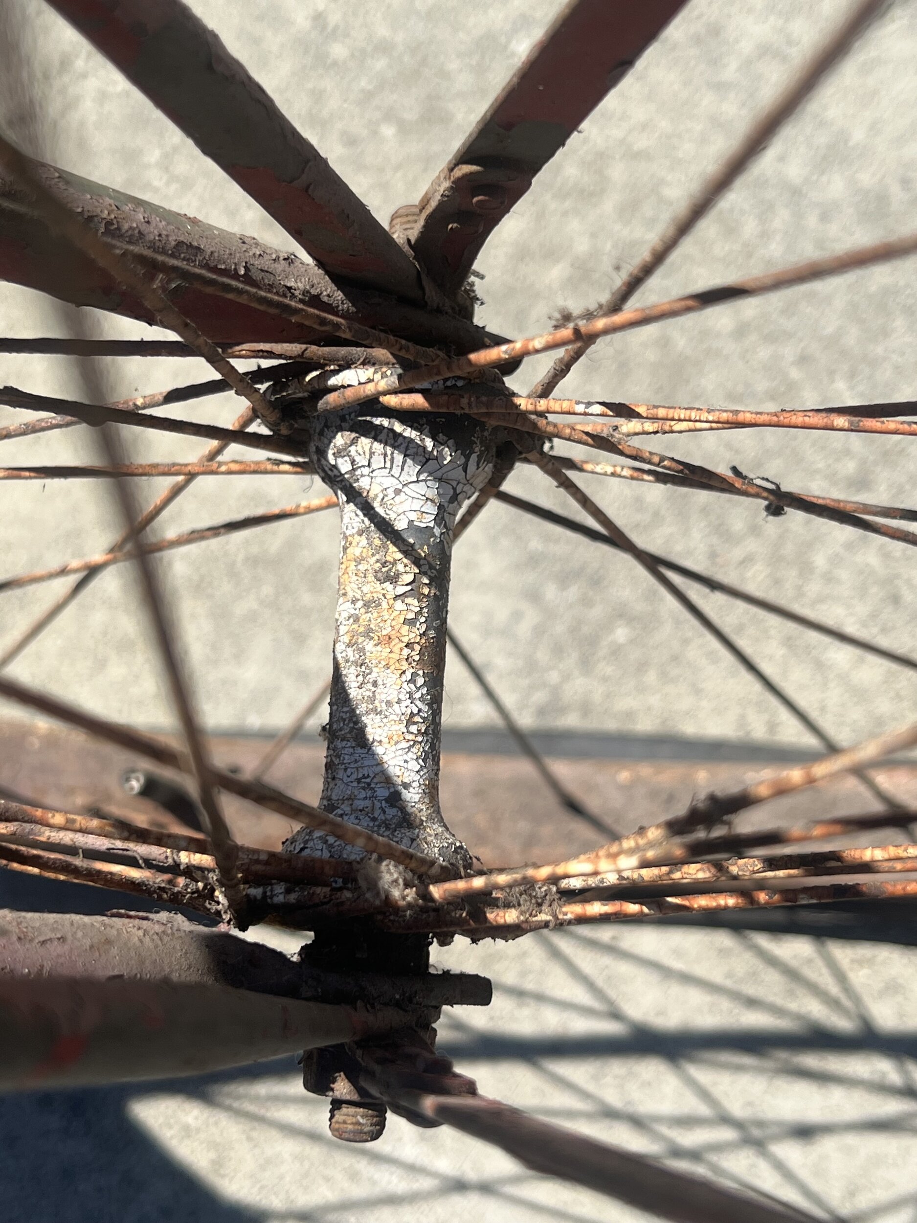

A feature noted by Serge @blackcat is that the rear dropouts are not the standard ones associated with G519, which have a stop for a dropstand, but the civilian version.

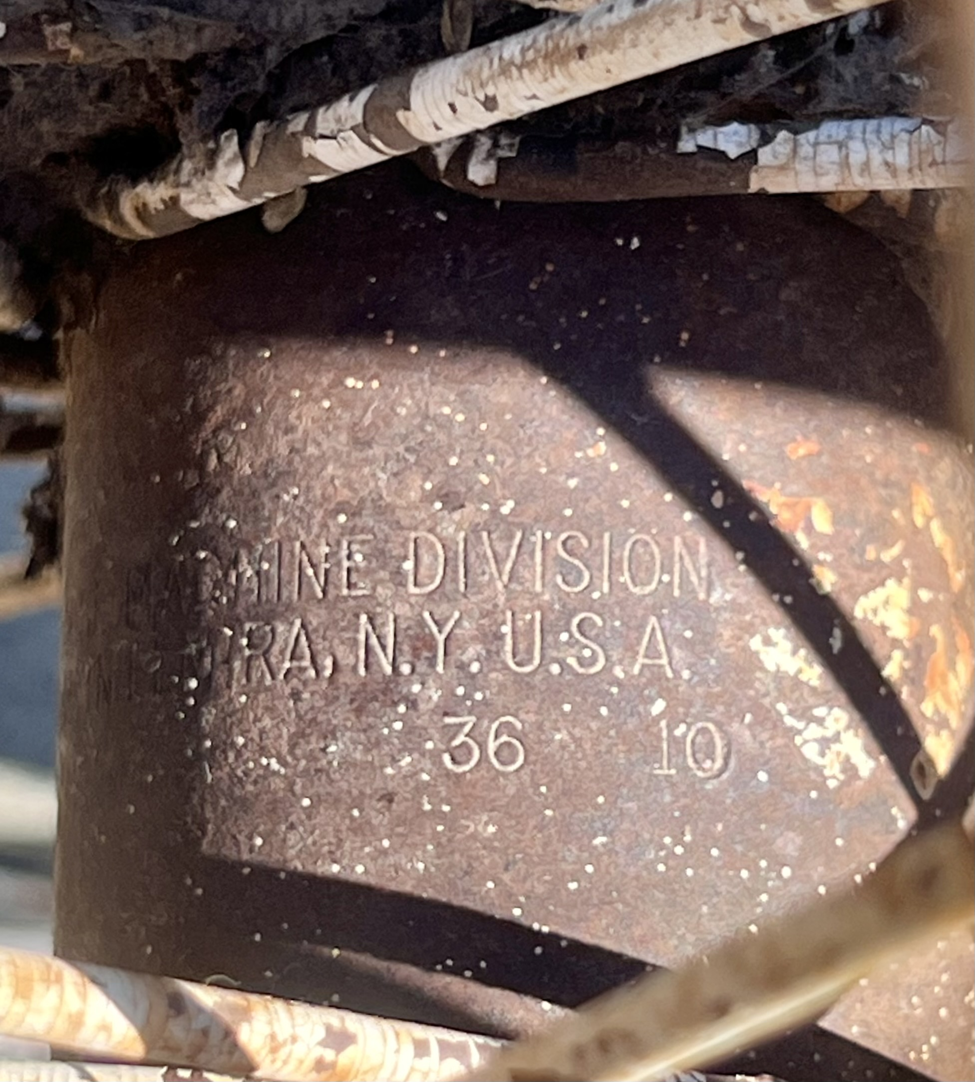

The Morrow is the correct 36 -10 version for a G519, I have asked for the Morrow date code, which might help, though these can be swapped in service.

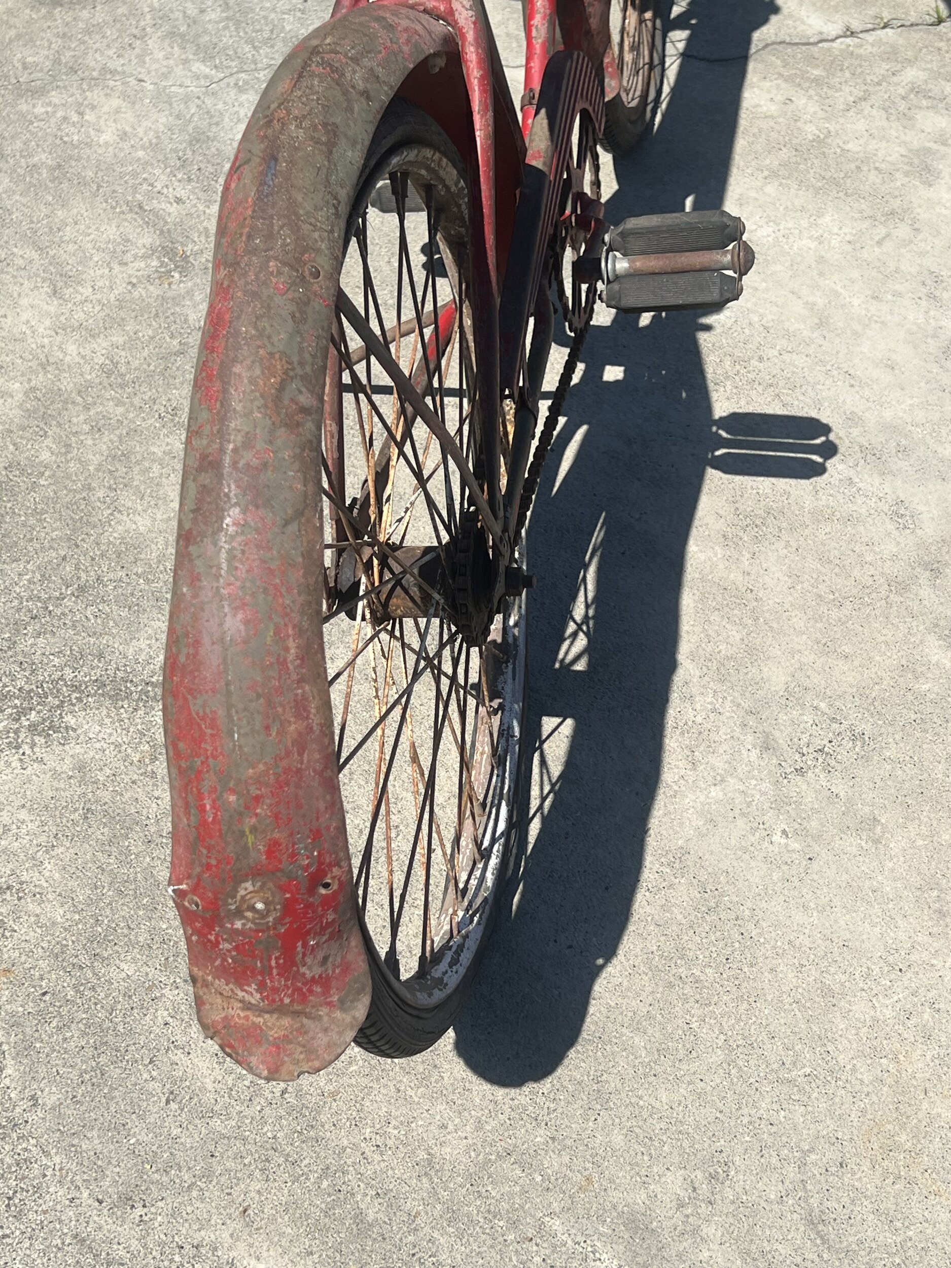

A small detail from here, is that both bikes appear to have duckbills on the rear fender, not a feature of G519's normally (although, I agree, fenders can be changed). Serge noted that the fender braces on the rear fender are also in the position associated with civilian bikes, but the green paint says it should be the original one.

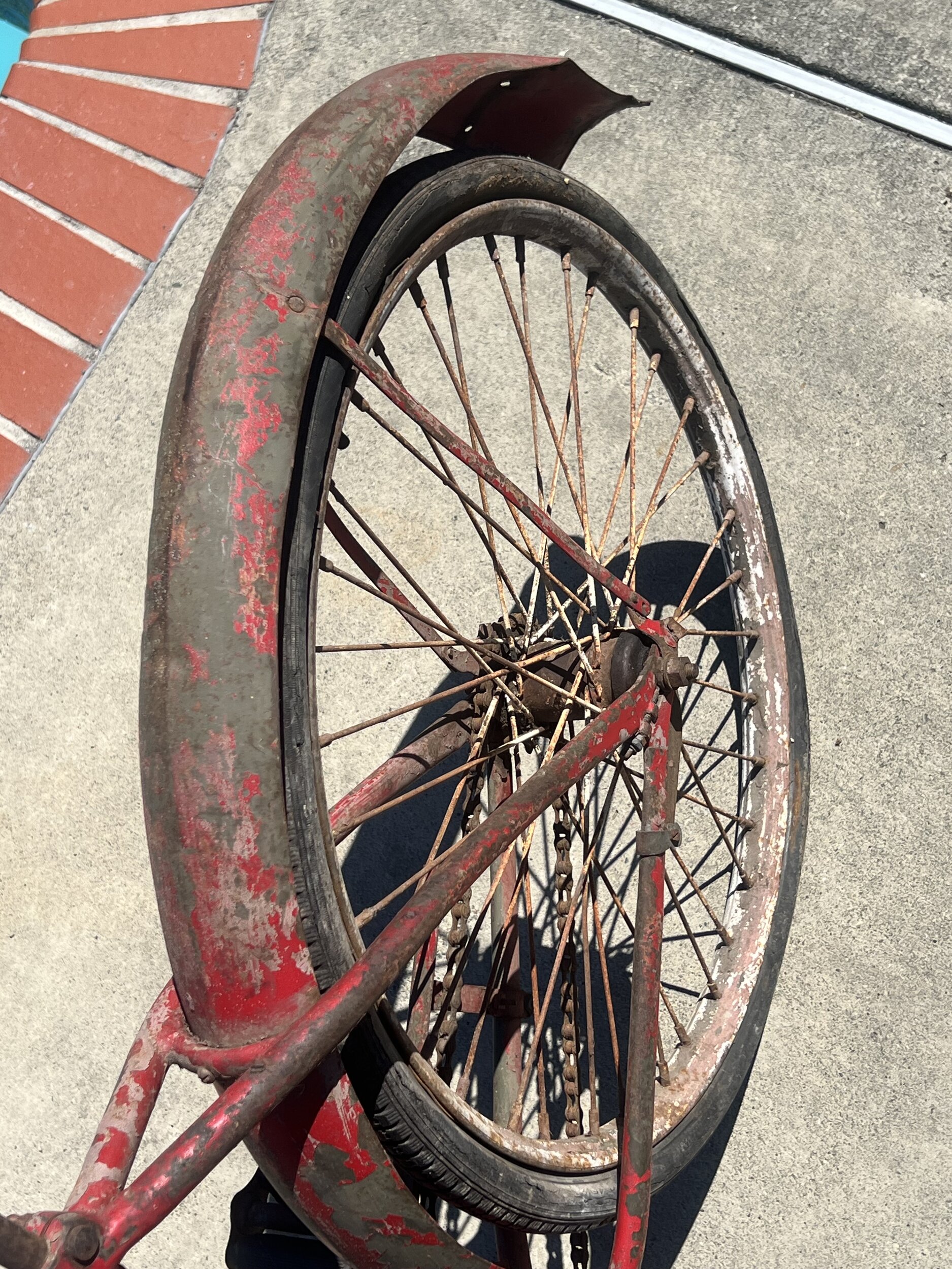

Hi Adrian,
I agree with all of your assumptions. The only thing is I would not differentiate the two styles of drop outs as one being civilian and the other military. The same drop outs with the ears for drop stands were on many prewar civilian bikes.
Chris

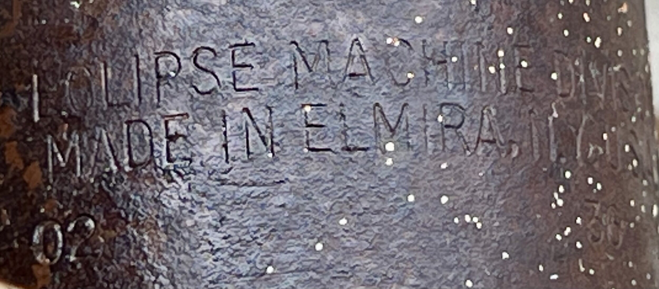

Thank you for all of the amazing info posted here! I will be attempting to remove the paint. 🎨 And will post pictures of the progress. Planning to Collab with Chris on this one, he can help me out with some parts 🤞🏻 here is the gate code on the Morrow hub apparently produced spring of 1945
Hi Jimmy @jimmyjambo43
That's excellent. Thank you for checking.
O2. Letter O is 1945, and 2 is second quarter, so made April to June 1945.
That is what you'd expect to see for a June 1945 frame and helps confirm the date.
Also, it means that it likely to be the original rear wheel, and that the hub was ordered in for this late contract. It is not an earlier hub they had lying on the shelf which they used up.

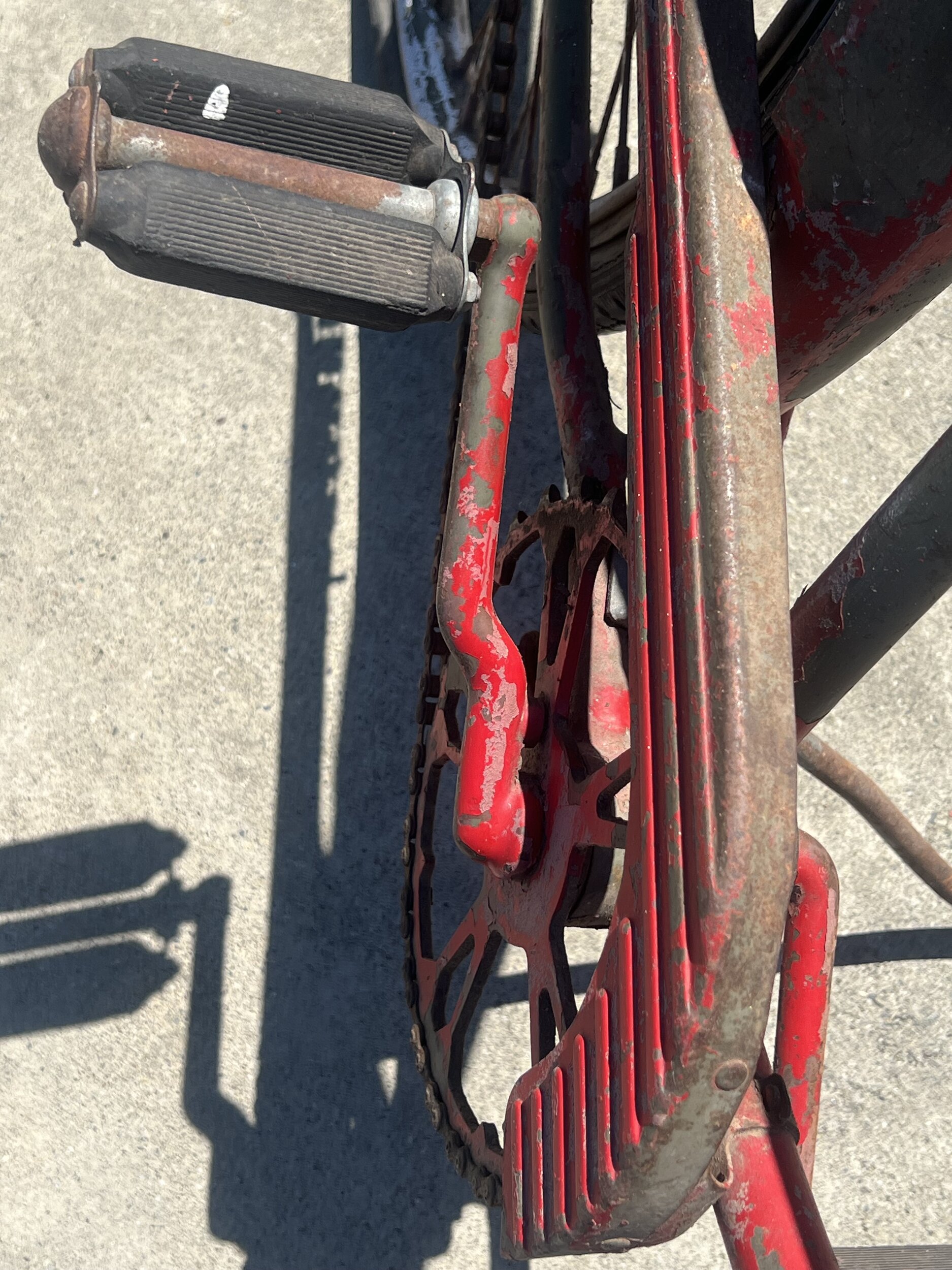

Incidentally, I don't know if this would have had wooden pedal blocks. Rubber restrictions had been lifted, and I've just looked at a few civillian bikes from the same period, and they are all rubber blocks.
That said, if it was a military specification, maybe they'd have been fitted anyway. Your choice, I guess, until we know different...

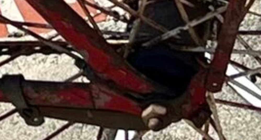

Well those rear dropouts have me just absolutely confounded
and making me question my very existence. Let alone every
little thing I thought I knew about G519 bike frames. I am most
intrigued. Awesome to see an end of war production bicycle
that defies the standards. I like the sideways N as well. Funny
how when they started at Westfield the M was an upside down
W and everything was stamped all sloppy and by the end of
the run the MG was nearly perfect.
Yes, until closer inspection, perhaps the rubber blocks are original...the bodies of the pedals appear to be cadmium plated, not painted...
