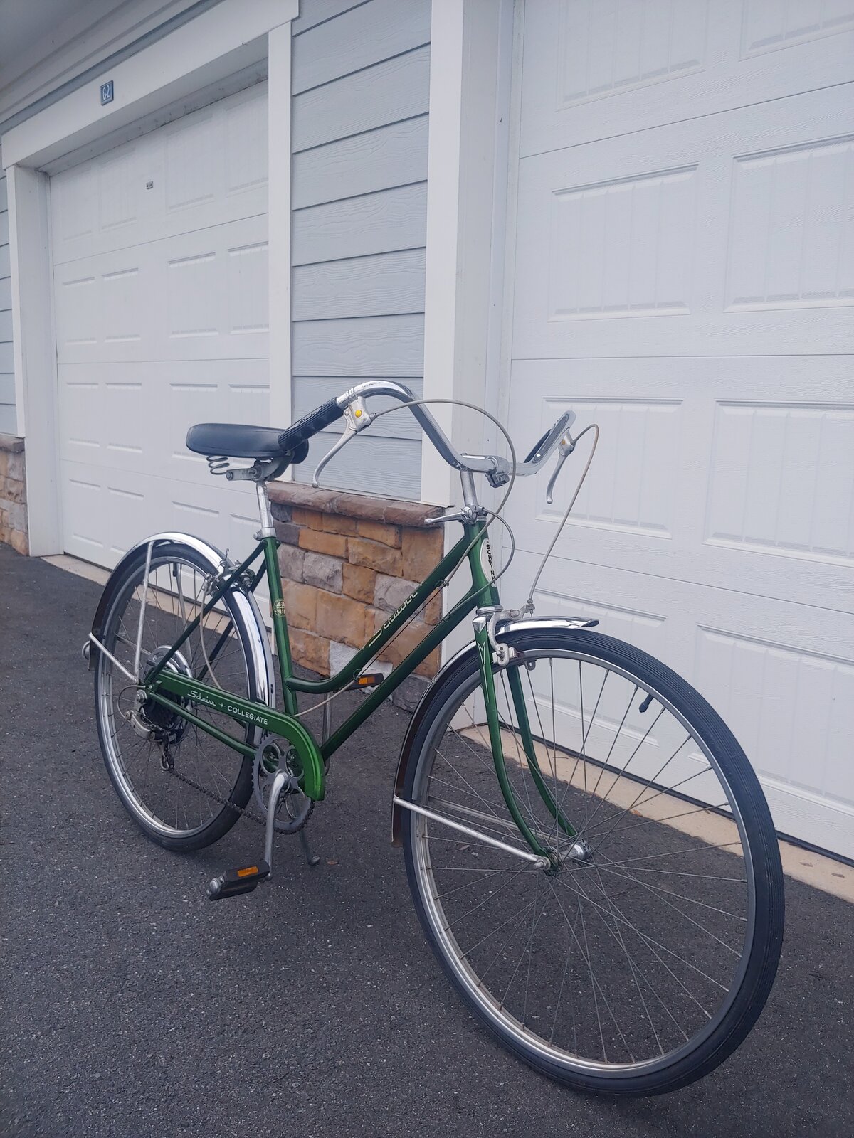

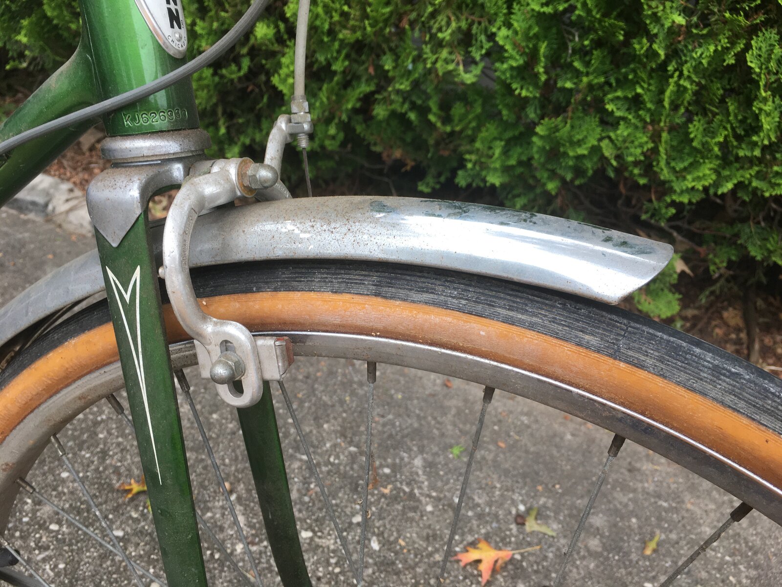

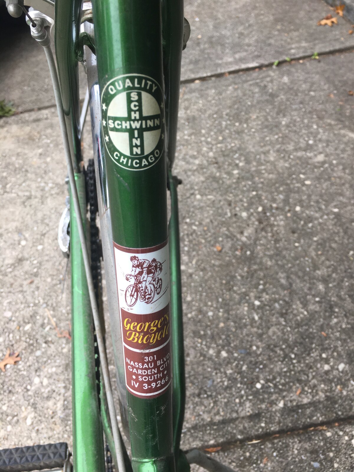

This 5 speed Collegiate bike came from the original owner, 10 minutes from my house. It was on Facebook for a week, listed as "BIKE"...not even the word Schwinn. Even dirty, I knew it was in great shape from the three photos that were shown. Decals are perfect, and I believe the tires are original also.

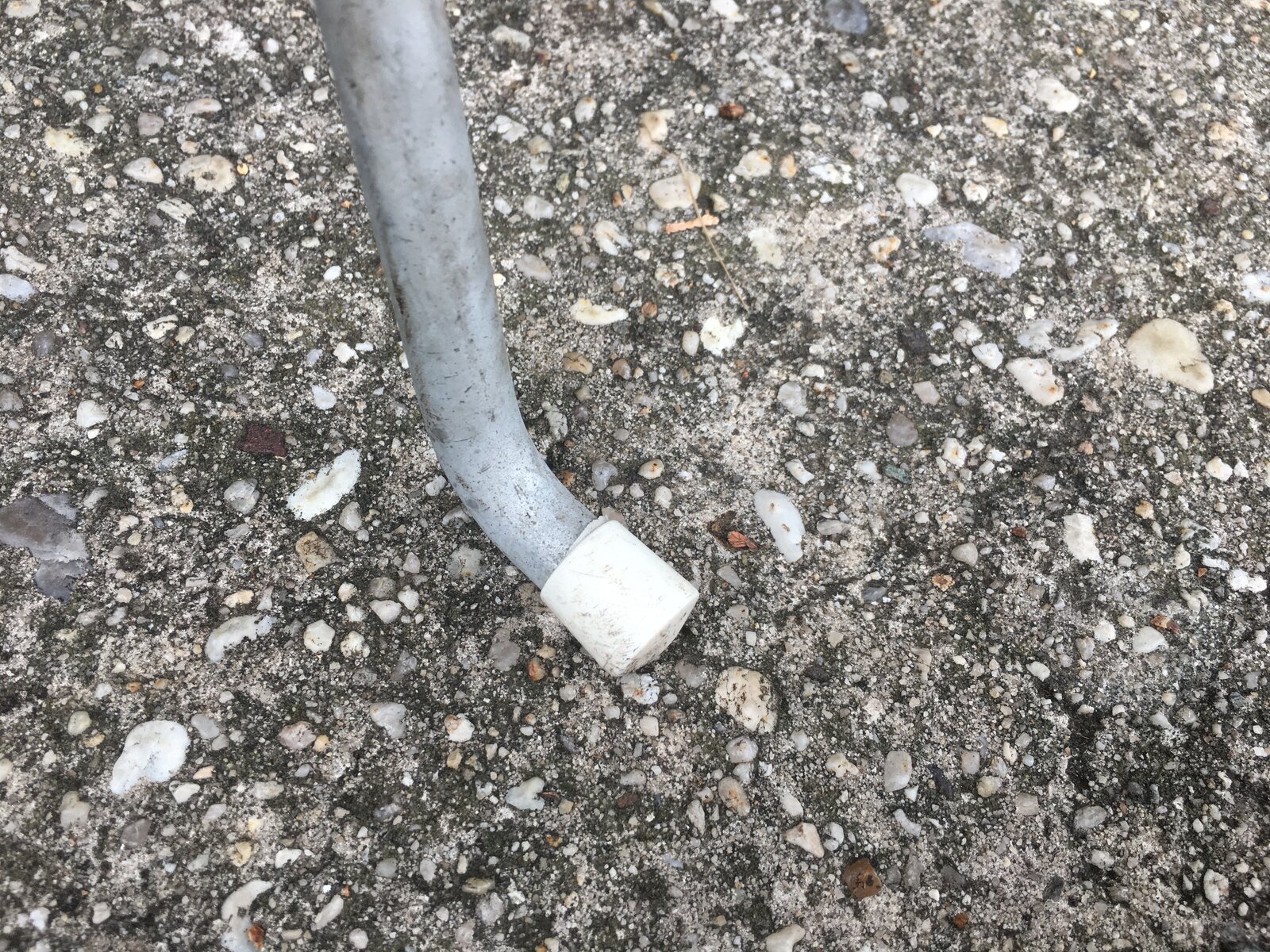

I was told the bike had sat for many years in a dry basement, and it appears that it did. This will clean up very nicely! And check it out...the cap is still on the kickstand! 🙂

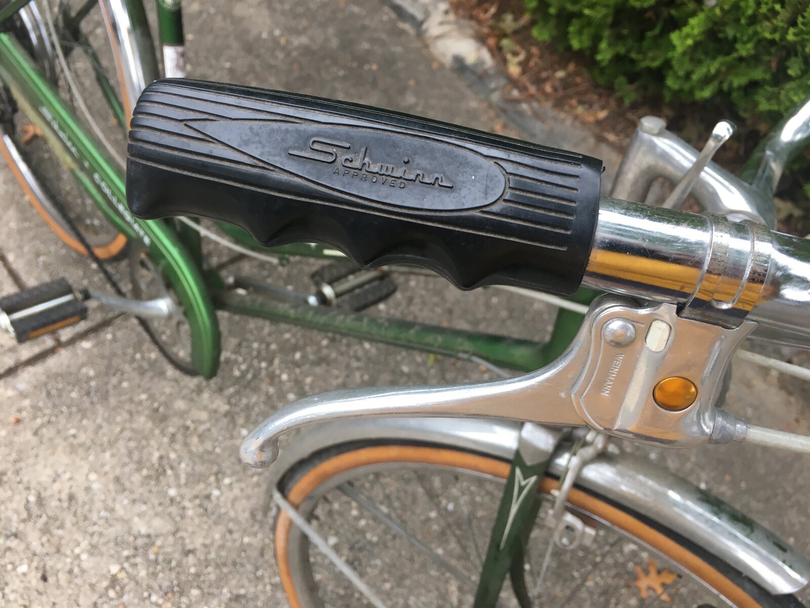

HARPO, your Collegiate bike has what I call the waffle pedals. Schwinn changed the pedal design to what I call the smooth pedals (seen on that other Collegiate) at some point around the time of yours, actually likely by the last months of 1972, about a year before your bike. Some folks preferred the older waffle with reflector built in so SCHWINN dealers would accomodate them. I have a (AH) Jan 1972 19" Kool Lemon (model 769) step through COLLEGIATE which has the waffle pedal with reflector. Late 1972 and all 1973 , I think would have normally come with the smooth pedal with the built in reflector. Mid- Late 1972 marked the change from wheels with center hump-ridge to those with a smooth area. My memory might be wrong, but that is what I seem to recall.

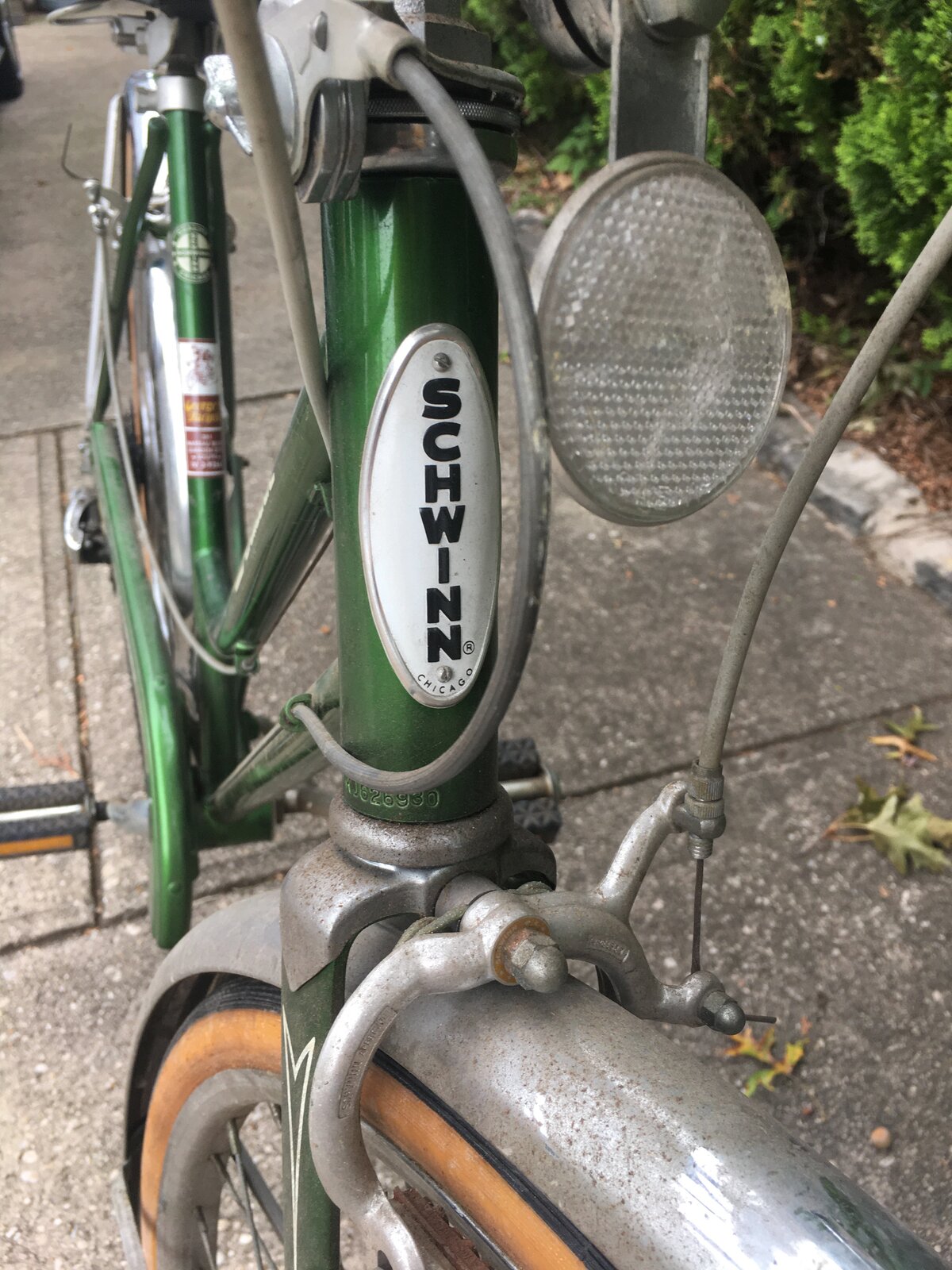

During sometime in 1970 model year, the SERIAL NUMBER LOCATION MOVED TO JUST BELOW THE HEADBADGE.
During 1976 Schwinn also began printing an extremely tiny number day of year code within the oval White Schwinn badge. Possibly late '75 too, but I am certain about 1976.
1973 may have been the last with the round reflector on the chrome raised round bezel attachment to the rear fender.
1974 went to an ugly rectangular plastic rear reflector on the rear fender

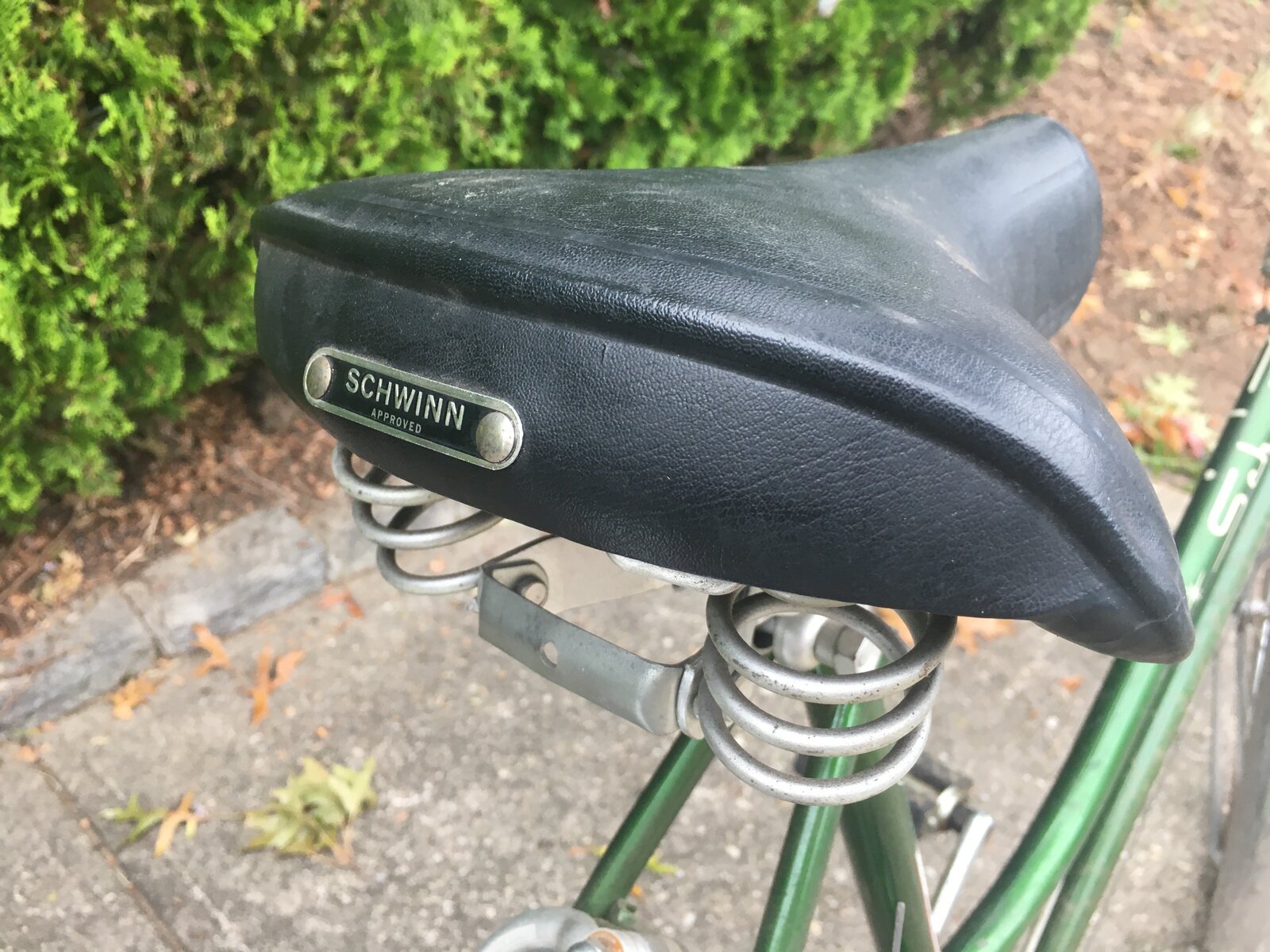

Those SEVENTIES era COLLEGIATES also have a much more comfortable T-85, I think it is, black rubber-vinyl spring seat by Mesinger with the Schwinn Approved rear rivet tag, which is much more comfortable than the seats before about '71 or '70. Though the earlier two-tone colored S seats look cool, their comfort for your 'bum' is not nearly as good as the rubber like black seat seen on every 1971, 1972, 1973,.....etc

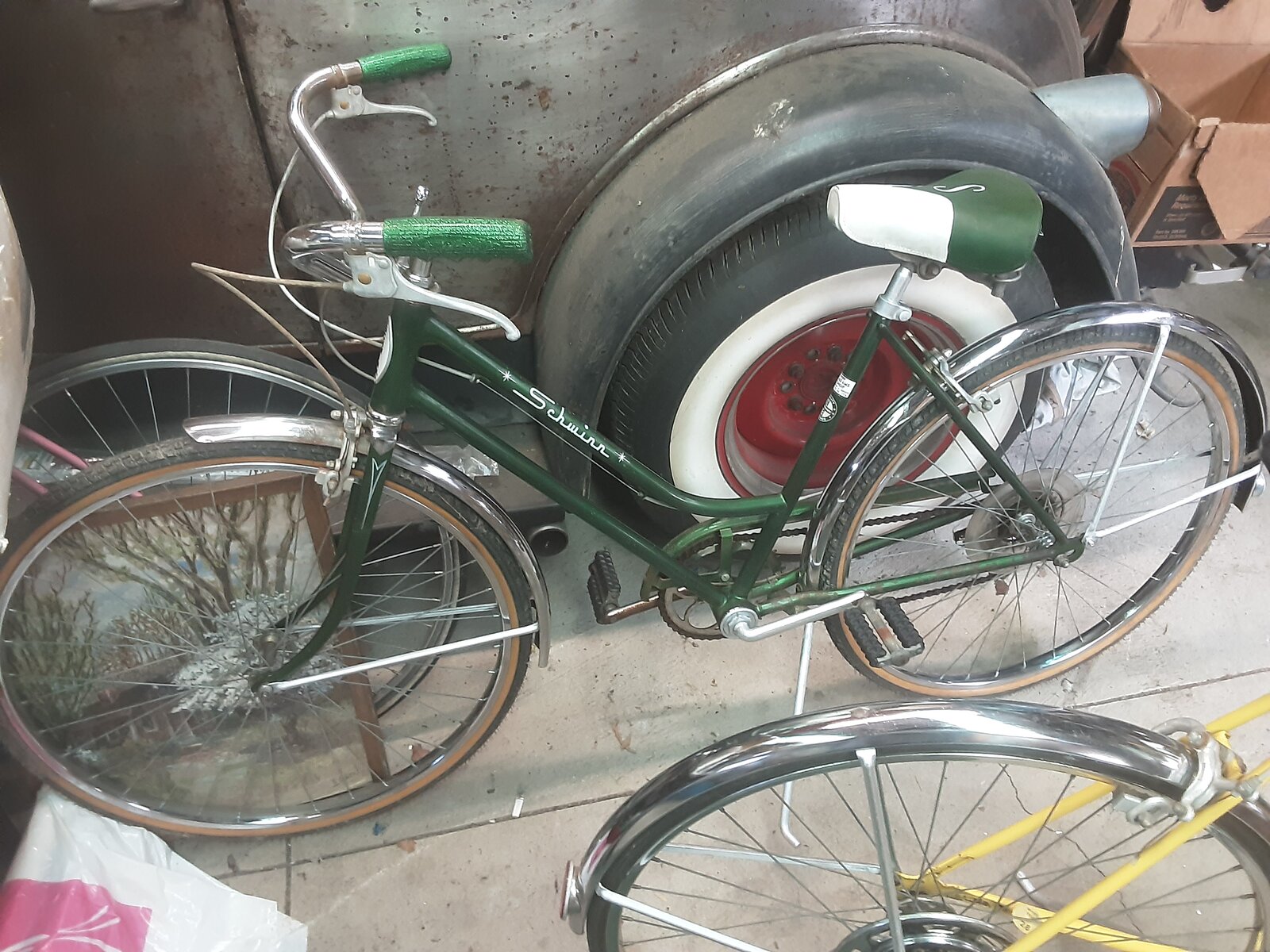

Are Collegiates, Racers, Speedsters, Suburbans all similar in frame design? To a newbie like myself they look similar, what are the major changes?
