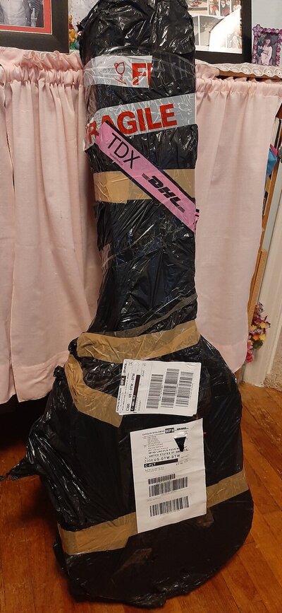

I bought a guitar last year from a moron in England who shipped it to me over seas wrapped it in a garbage bag and packing tape and thought nothing of it! ...
