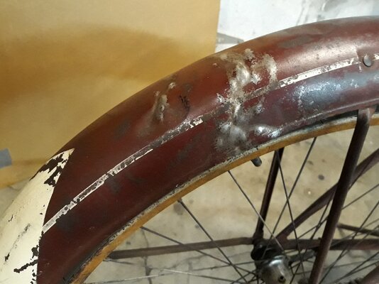

I use a wooden block and dolly, hammer, and mallet to fix dents in fenders. Worked carefully, they can do wonders. The work is slow though, that's for sure. I recently did a badly dented set of stainless Traveler fenders. The front in particular had a big dent in it. It took the better part of an afternoon to remove the dents, clean, and polish, but they look good. Rolling is probably a lot faster, but if you are persistent, basic tools will fix a lot of problems.
Great thread, many good suggestions.
When working with any "thin metals" the biggest issue will be returning the original shape without further stretching the metal. The previous advice of working the area slow and steady, taking only "small corrections" at a time is very important. After it has been over worked, over thinned, stretched, it's had to put the Genie back into the bottle. They make hard nylon hammers for hammering metal that will help prevent stretching and marring. Every time you hit the inside of the fender with a common "ball peen" hammer you are creating a small, stretched circle that will add to your problems. It's much easier to fix a dent, than it is to correct a "previous owners" screwed up attempt.
