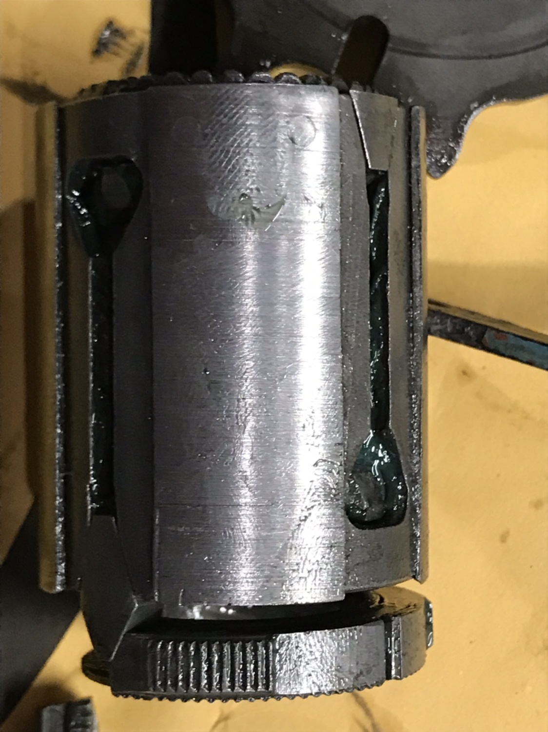

end assembly- cone, spring, retarder washer and axle bushing have moved away from the brake sleeve assembly. After assembling first parts ( pic 1) slide brake sleeve over axle, ( pic 2) the gap should be 1/32 - 1/16” max. If not, then the axle assembly should be tighter together.

Hi @PlasticNerd where is the gap in the picture that you are referring to? @piercer_99 @tripple3 I think this might be the thread that actually clears things up and helps it make sense for me. Actual pictures sure help. And if I need a new brake sleeve i know who to ask. ;)
I will take some pics and circle them to show where the "gap" is! Can try to do later today or tonight! Gary

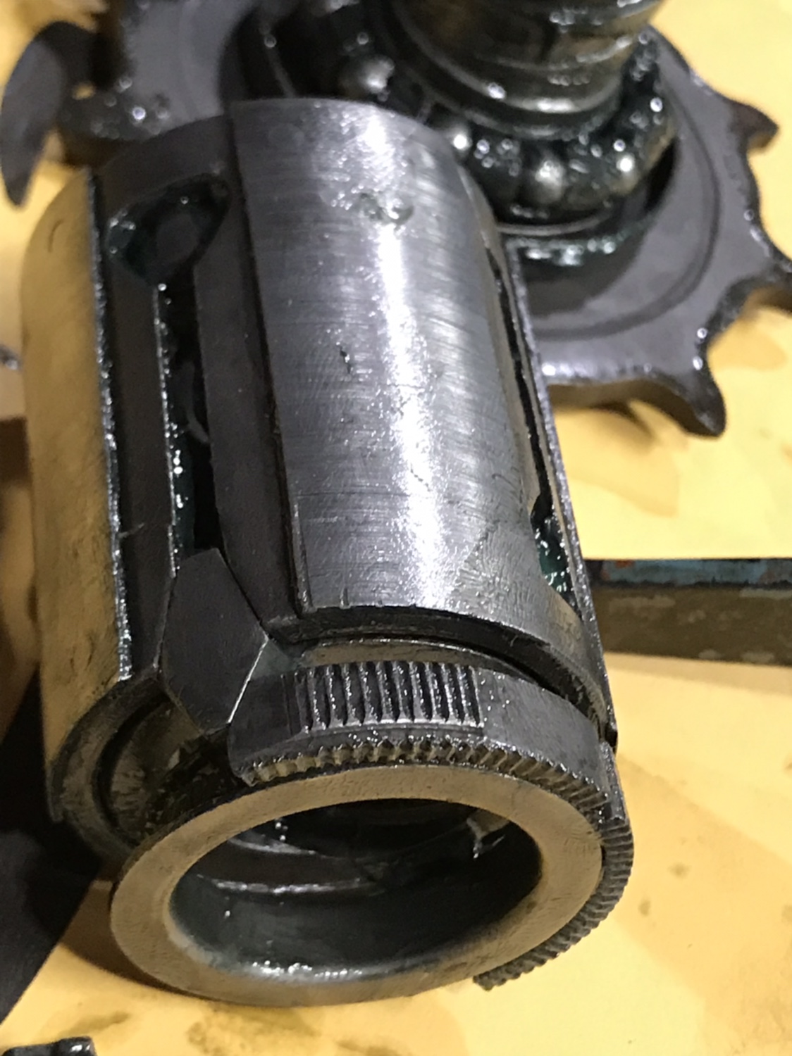

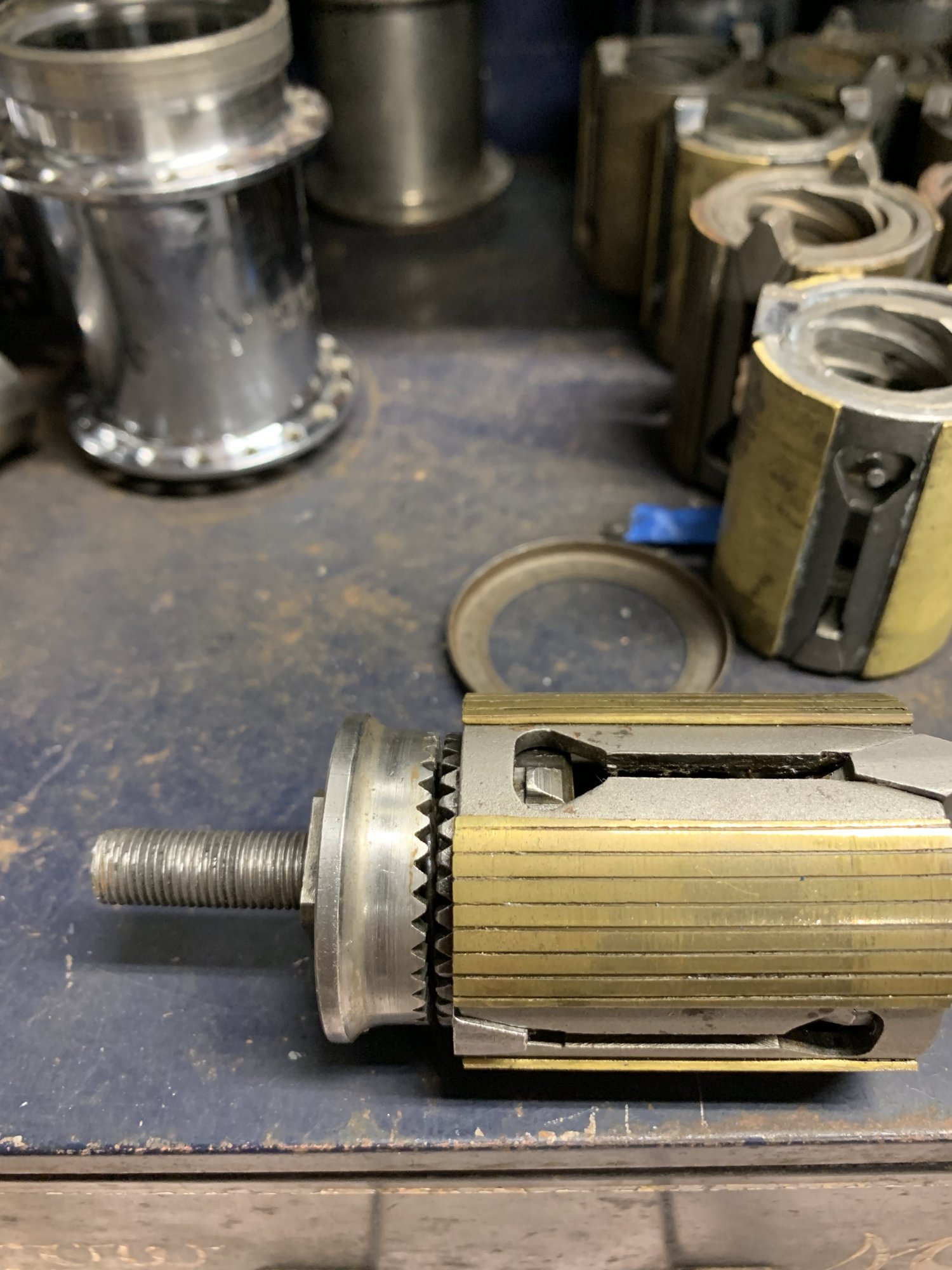

The Gap between the teeth on these two parts, that can be changed by the way you pinch the spring down when screwing the first three Pieces onto the axle. Maybe I can do a video sometime on it !! Gary
I just learned that part 116 (retarder washer) has one side larger than the other, and if installed upside down will cause a large gap between the teeth. Unfortunately this has not solved all of my hubs problems
