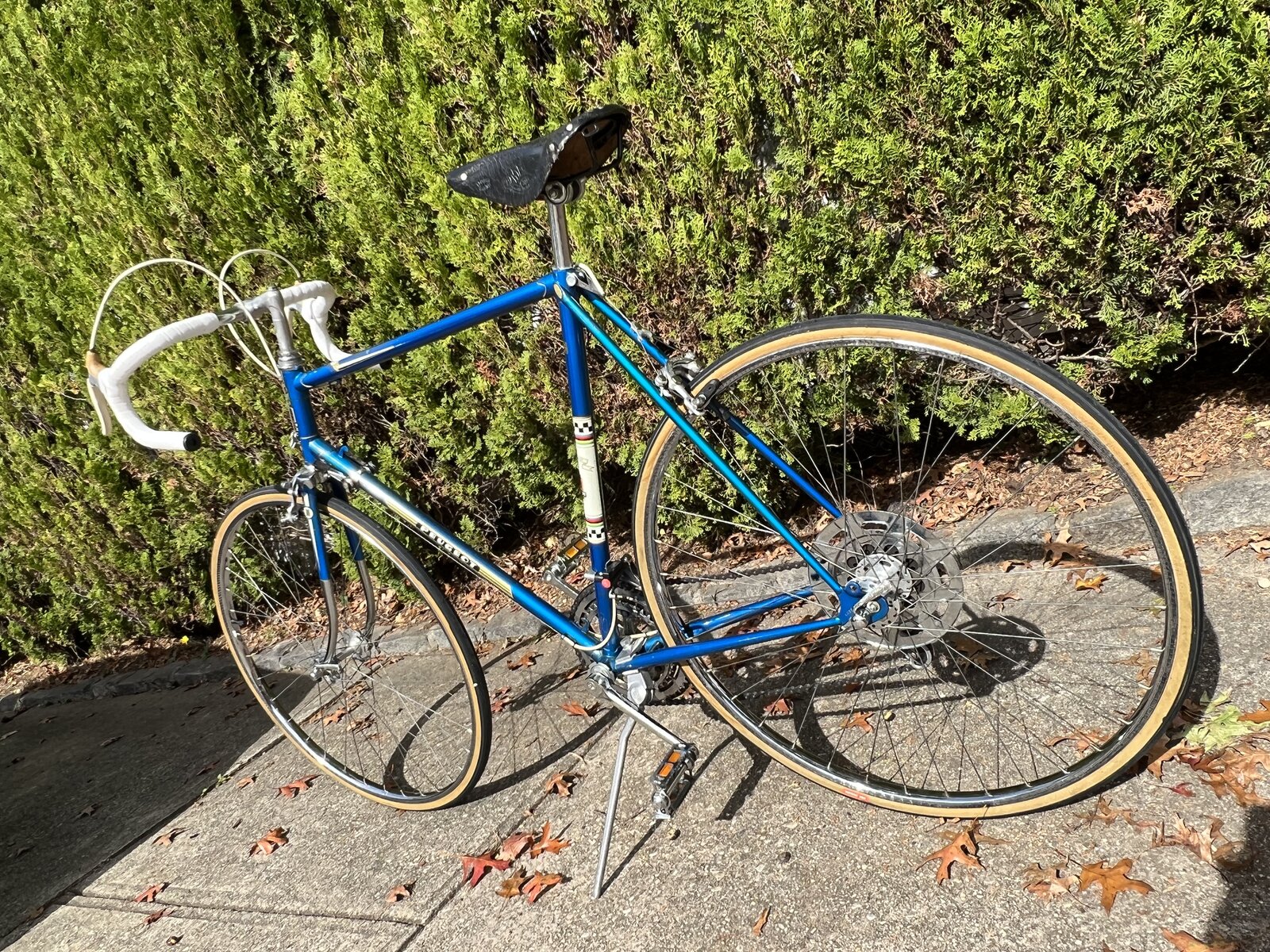

Peugeot UO-8...I Think...

OK, all done. Very happy with the way it turned out, and I might add a Pletscher rear rack like the one my friend had on it when he used it (which will cover up the scratches where it was).Thankfully I had the front derailleur, but I haven't set it up...afraid I'll crack it!! It will be used as display only anyway along with my late brother-in-laws PX-10. 😜
ENJOY THE PHOTOS! 😎
how much stem is engaged in the steerer? looks borderline iffy.
Gnutti QR skewer in front hub would not have been OEM.
are you able to read the marking on the end of the bottom bracket spindle, does it say "49"?

have not before seen a Peugeot bottom bracket spindle with these markings, or similar
two possibilities come to mind -
a) something done for a short time only, small batch
b) spindle is a replacement
He told me nothing had been replaced on the bike (but I guess the Gnutti QR skewer was) that he could remember. A spindle you would remember! 😎
Could the 49/40 be an assembly/ error proofing aide in order to visually confirm the spindle inserted correctly?
