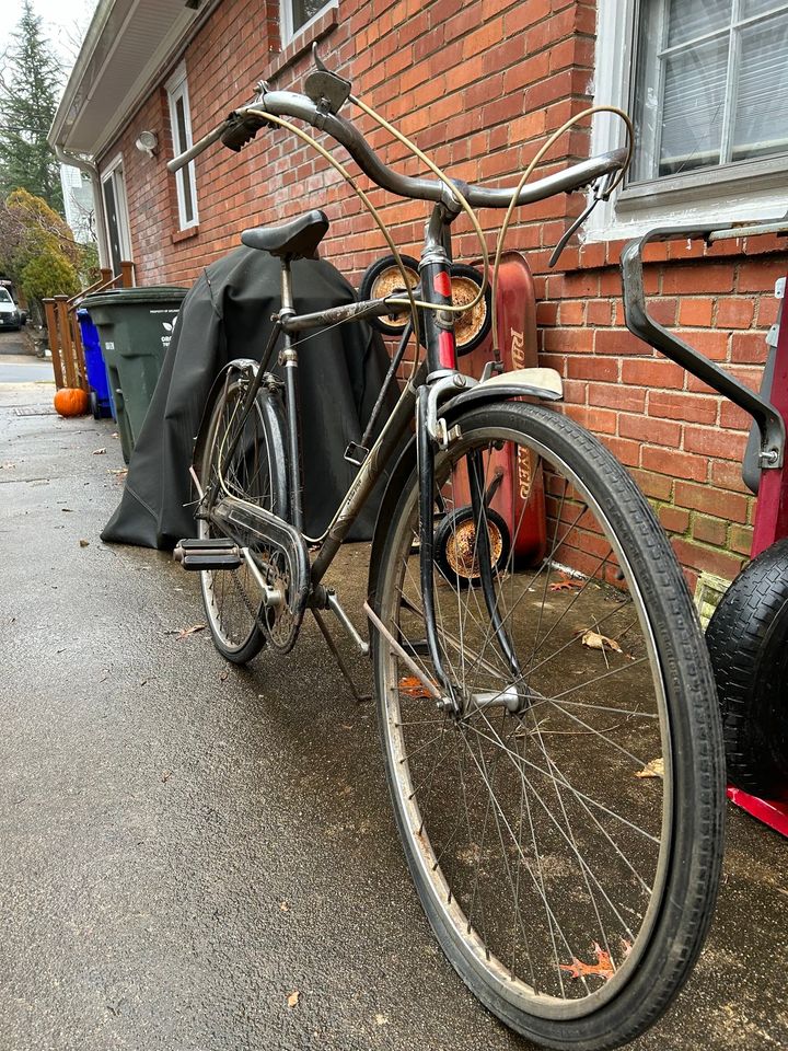

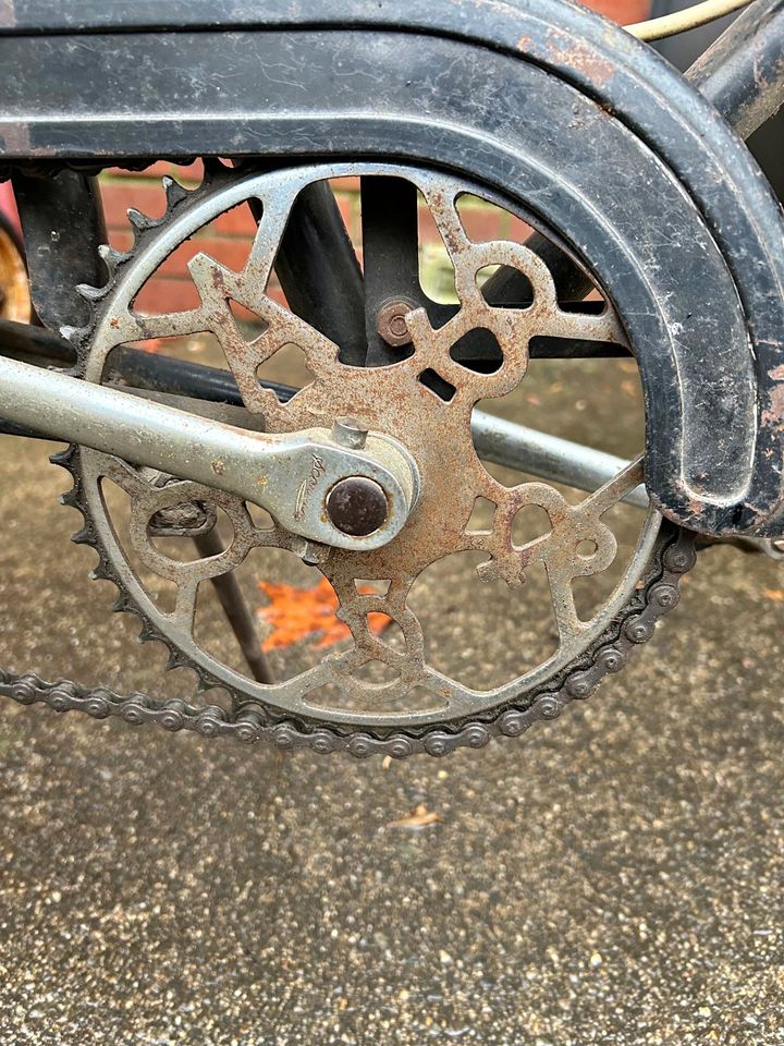

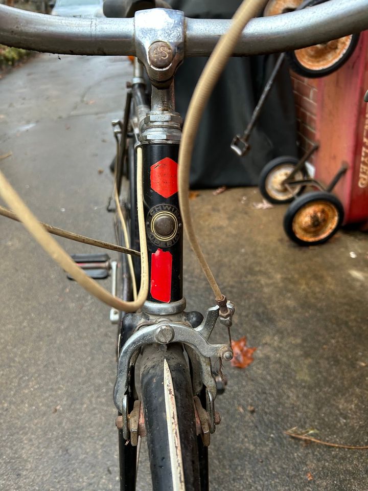

I’d like to see pictures and more information on this one. Three speed? No hub date?
Sorry late getting back, been under the weather. Bought this a few years ago at a swap. Frame, fork, chain guard, crankset and seat post. Hadn’t been able to put it back stock so put a set of new wheels, saddle and bars to tide as a single speed.
I apologize but for some reason it is not letting me upload a pic of the complete bike?? Says the pic is too big? Technological idiot here😀, any help appreciated. Thanks also for the serial number help.
Rennfaron passed along this 1951 black Superior and the owner of the bike kindly gave me a little information on the bike. I'll add it to the list of post-war Superiors.
This is my bike (well, my dad's old bike) and through the process of selling it I have learned a few things, including that the rear hub has the manufacture date. Turns out it's actually a 1949
Thanks very much for the additional information. It's interesting that it's a 1949 model, which falls right into the time period of these bikes. Black is common on the New World models, but not common on the post-war Superior bikes. You've got a good bike there.
As a side note, I lived in the DC area for 18 years and moved back north about 5 years ago. In those 18 years there, I never saw one of these bikes locally. I move away, and then good bikes start turning up there... go figure.
I'll add your bike to our list of known post-war Superior models.
