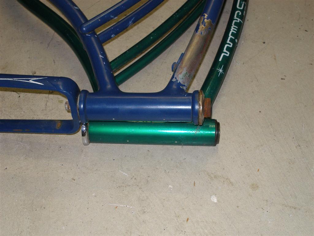

Differences between the 18'' standard cantilever (top frame) and the 20" KS (bottom frame) can be found below:
