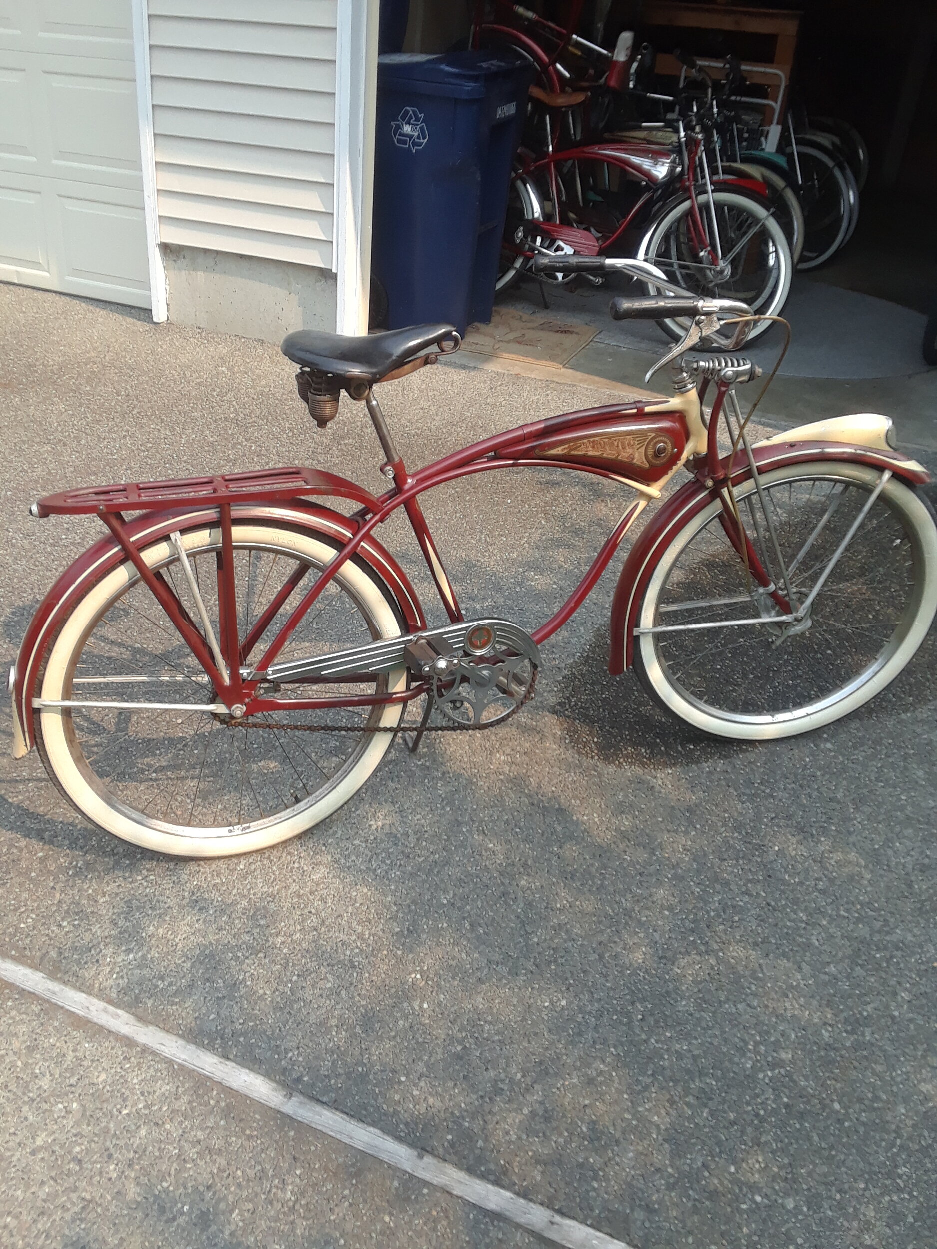

There is one ad that appears to be 1941 bicycle with some special features...just have not seen an ad calling it a special model
This one as stated above looks like 1941. I do not have an ad to see if it's an actual model as it is missing the rear drum and has no tank to be like the 1940 special model. Pretty close though....
I owned this bike a while back. Always thought it was a 40 "new" Autocycle.
I have the 1940 women’s Hollywood Special (which matches that Autocycle especially well), equipped as noted in the catalog, spring fork, rear drum brake and high flange front hub. I’m definitely considering the front drum brake swap because the rear drum absolutely does not cut it alone for safety. This is one of my favorite bikes, it’s such a nice rider.
