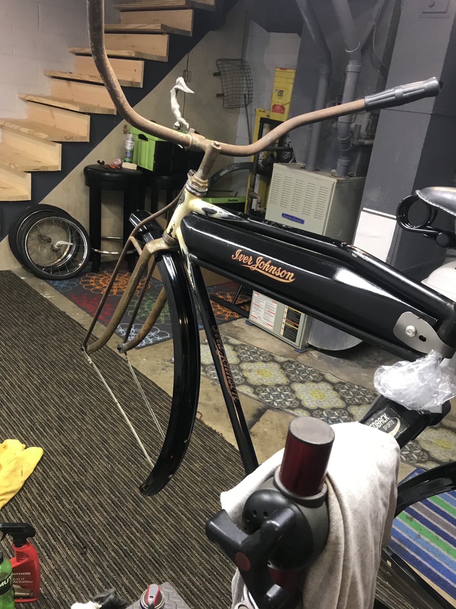

So here in a bit I'm going for my first attempt on waterslide decals on my iver tank. Any tips would be great. I've heard this could get real tricky real fast. Thanks in advance.

I appreciate the info. I will try exactly what you said! Wish me luck!! :)

This tank is just there long enough to find a OG one :).
Decals aren't perfect, but aren't ripped or torn so that's a plus :). Thanks for the good advice!
