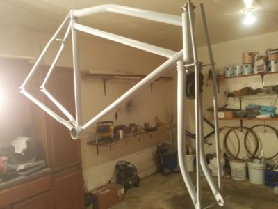

primed frame ready for paint
this is the frame ive talked about on this thread for all plausible cause its a 1919 hendee indian when done it will sport the indian red with gold pinstripping and nickle plating white tires white rough rider grips white pedals and for sale..... just need a real headbadge and im good..... till then ill keep up with pics...

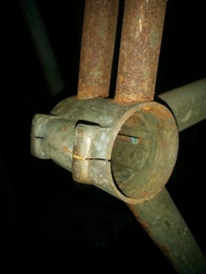

i have a new departure model A and C 1919 was A correct? and what was front W? or nothing just new departure........
gene if your looking into the bike with split crank and no screw holes look at my barnes white flyer tandem barnes made a bike to go against the sterns yellow fellow it had a waterslide decal on the head tube and a split crank ill show pics see if its the same as yours.....
