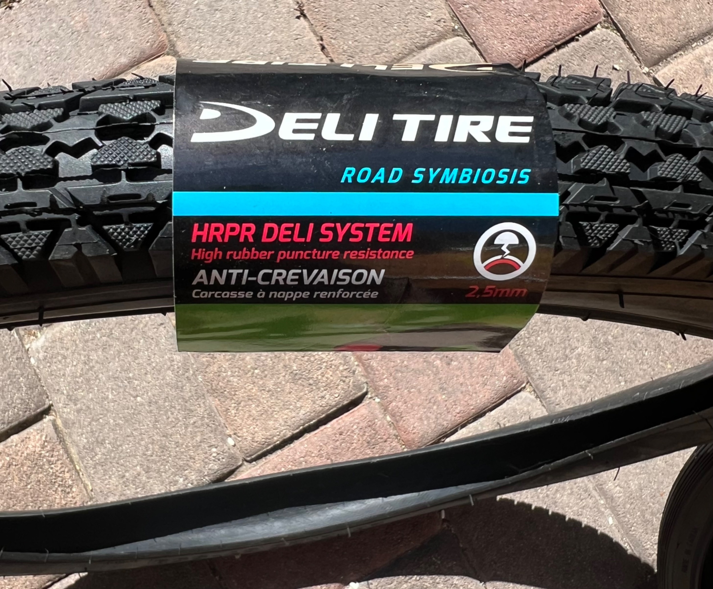

We’ve been using this one with good results.

The tires that Marty pictured above look very nice mounted on his Whizzer and offer a great value for "a rider" application.
