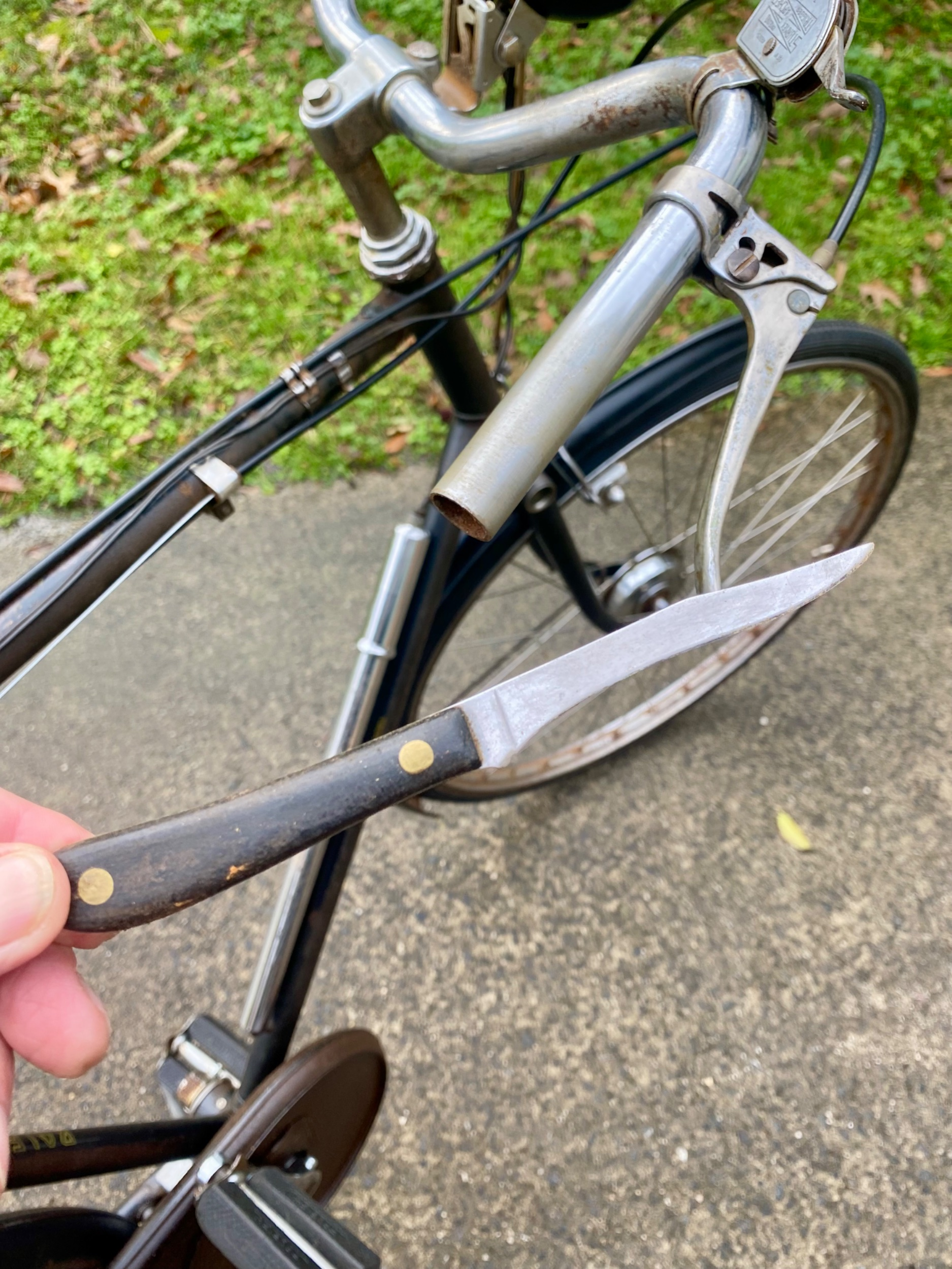

1949 Raleigh Sports Refurb

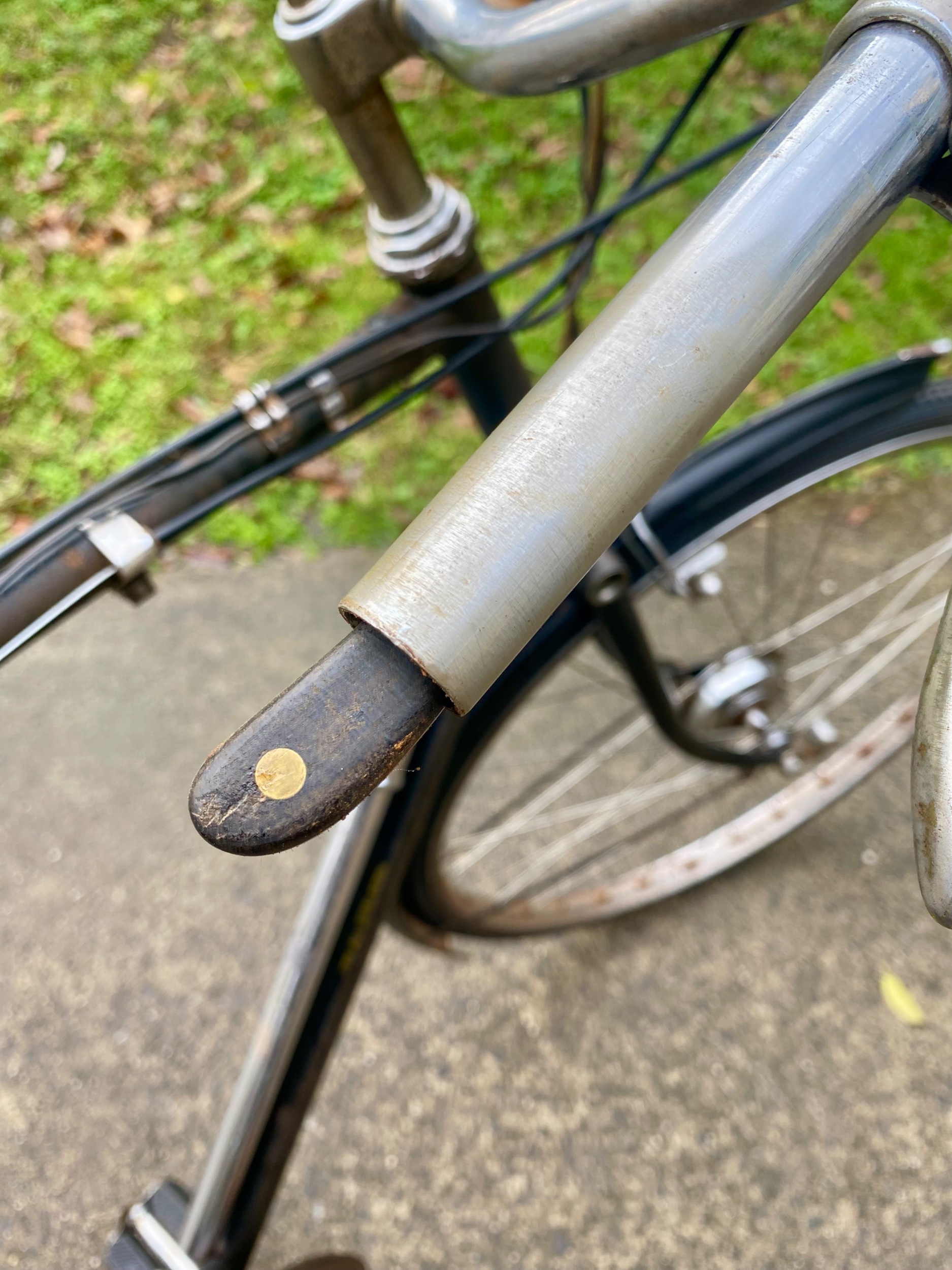

Recently finished this bike up. Here are some pics. I found that knife hidden in a handlebar of another Raleigh and thought it was a pretty cool non-authorized accessory!
