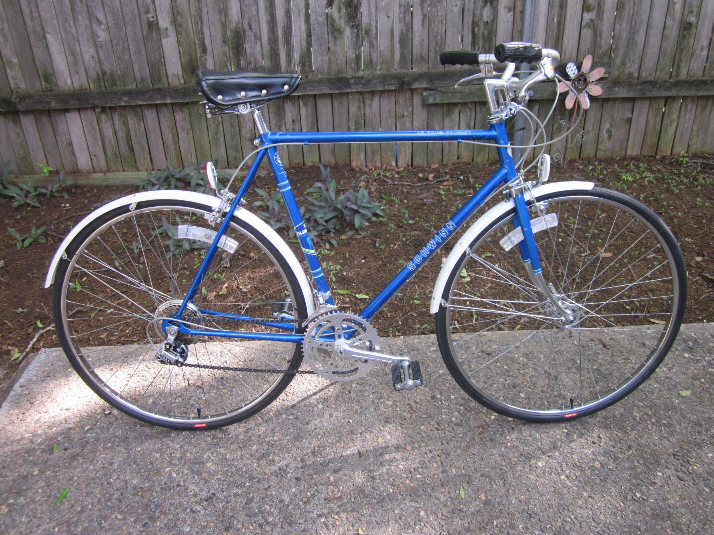

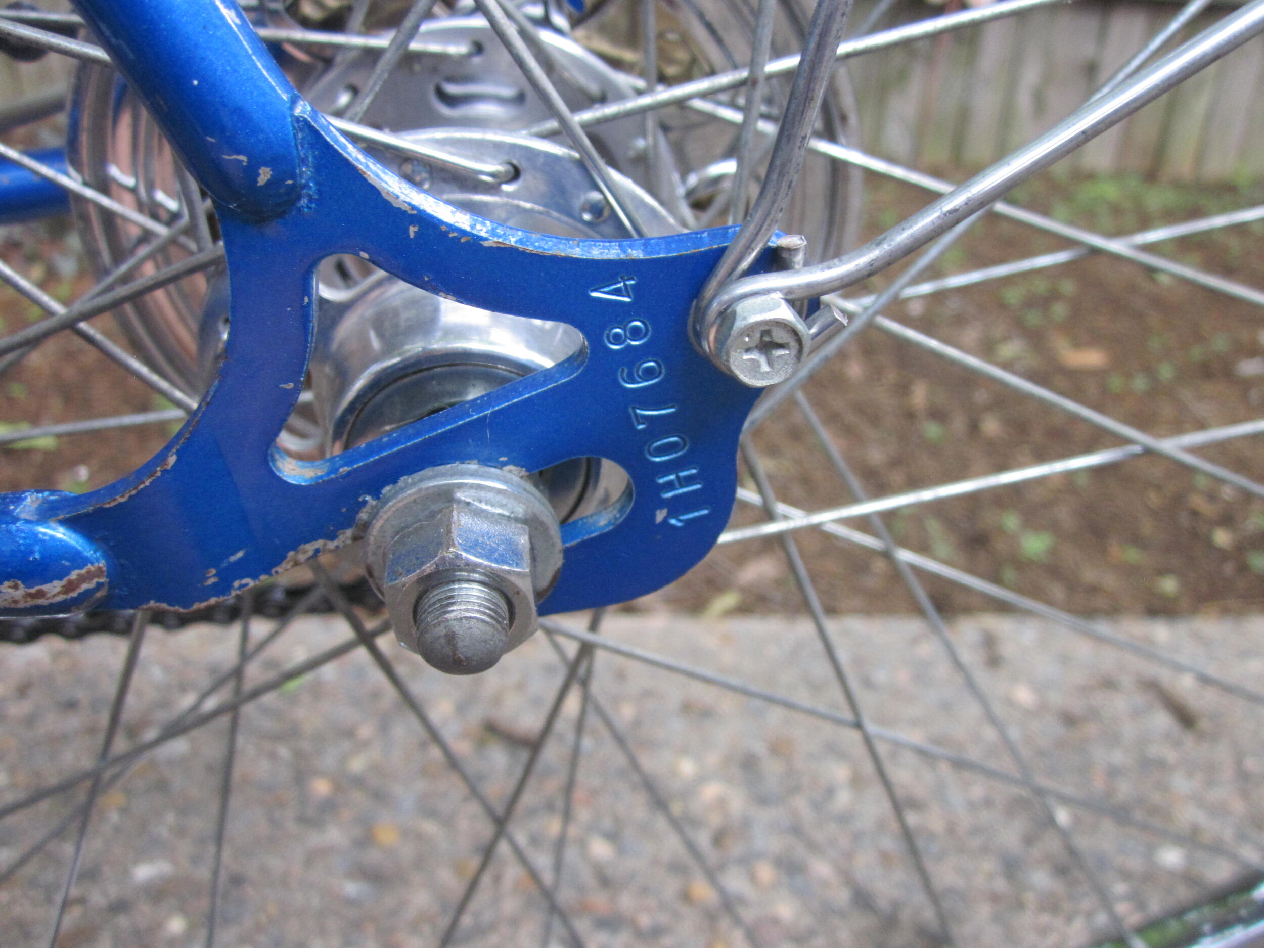

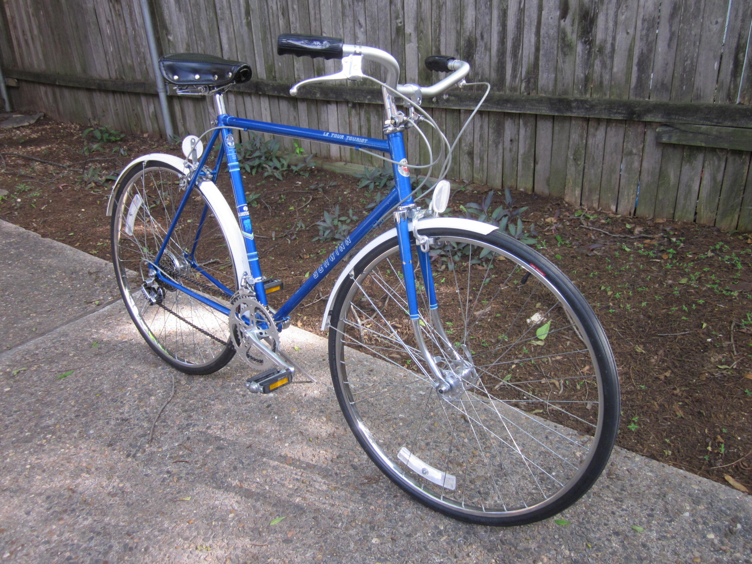

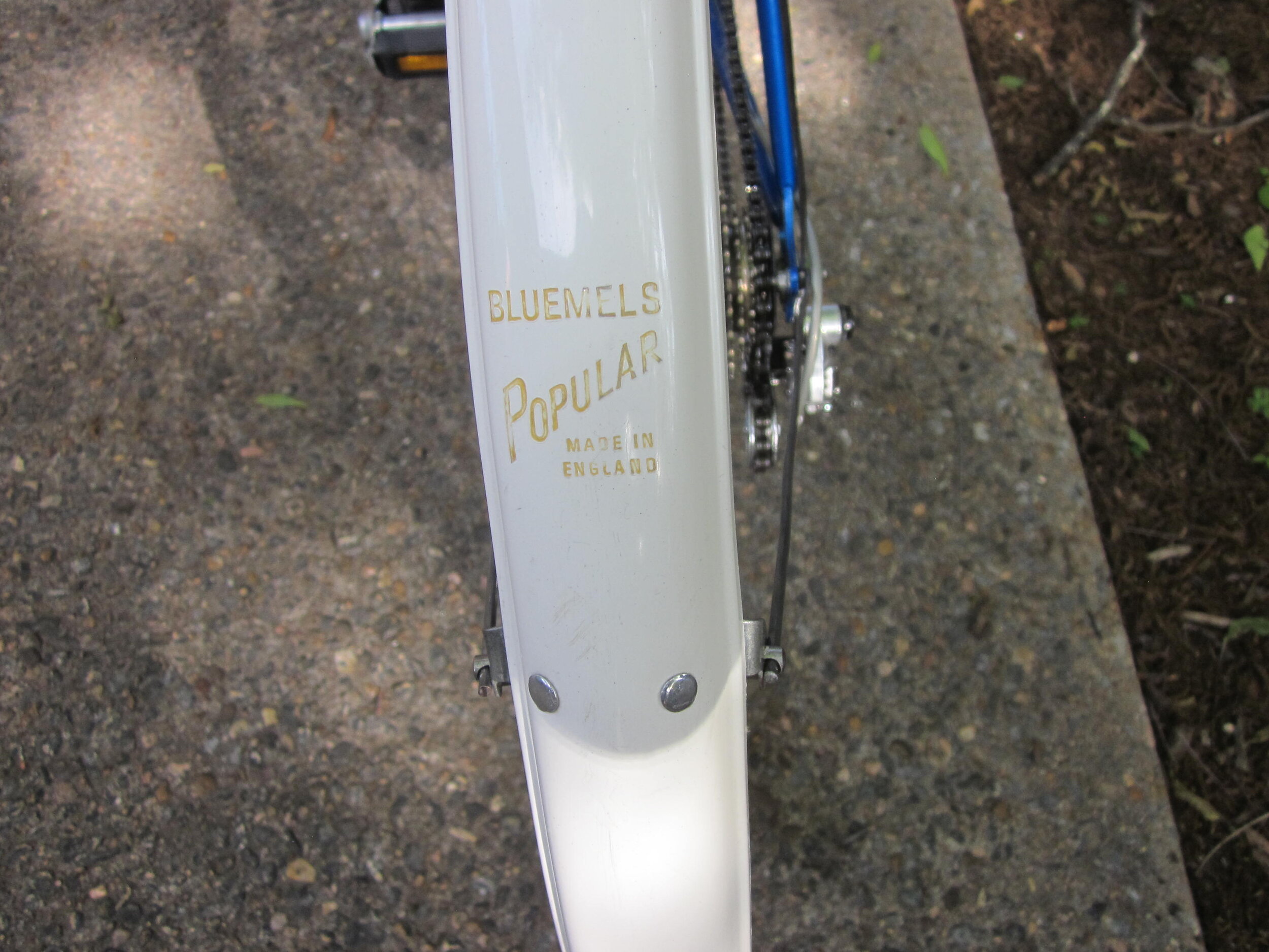

Here are some pictures of my latest project, a 1981 Schwinn Le Tour Tourist in Blue. This bike was in pretty rough shape and became a bit of a challenge for me. It came to me with a poorly installed bent up bottle cage, which did quite a bit of paint damage to the seat tube. I found a cool Shimano decal which covered most of it. The front Bluemel fender was cracked with two broken struts. I trimmed off the damaged section and rerivited the brace. Both of the Cat Eye reflectors were broken, so I replaced them. Everything else was rebuilt including the pedals and rear derailleur. I installed new tires, tubes, rim strips, brake shoes, inner control cables and a nice pair of correct Schwinn cushion grips I had in my stash. I have to admit that the bike shifts smoothly and rides great! I'll probably put this on craigslist for 175.00, less than I have in it. I hope you enjoy the pictures. Thanks, Mike
The Panasonic made LeTour Tourist is a fairly rare bicycle to see these days. I've been to a lot of bike shows and swap meets and yours is only the second I have ever seen. Yours is especially cool with undamaged looking Blumel fenders. You most often see the British plastic fenders beat to death. The owner and founder of (I can't include the last name and Japanese name of the company because the auto editing feature of this forum renders his name pointless) Electric/Panasonic/Bridgstone/JVC brands etc. in Japan) hired engineers that knew how to build a bicycle. Over the years they have built some superb examples. In my opinion some of the best Schwinn Lightweight frames (with a few small exceptions) were built in Japan. My very first Schwinn Lightweight was a beat up, rusted out 1974 LeTour. I brought it back to life and it has been through many iterations of wheels, gears and shifters but remains one of my favorite bicycles to ride and that includes a 1974 P15.
I hope the person that purchases your LeTour understands what they are buying. Best of luck with the sale. Thanks for posting this jewel.

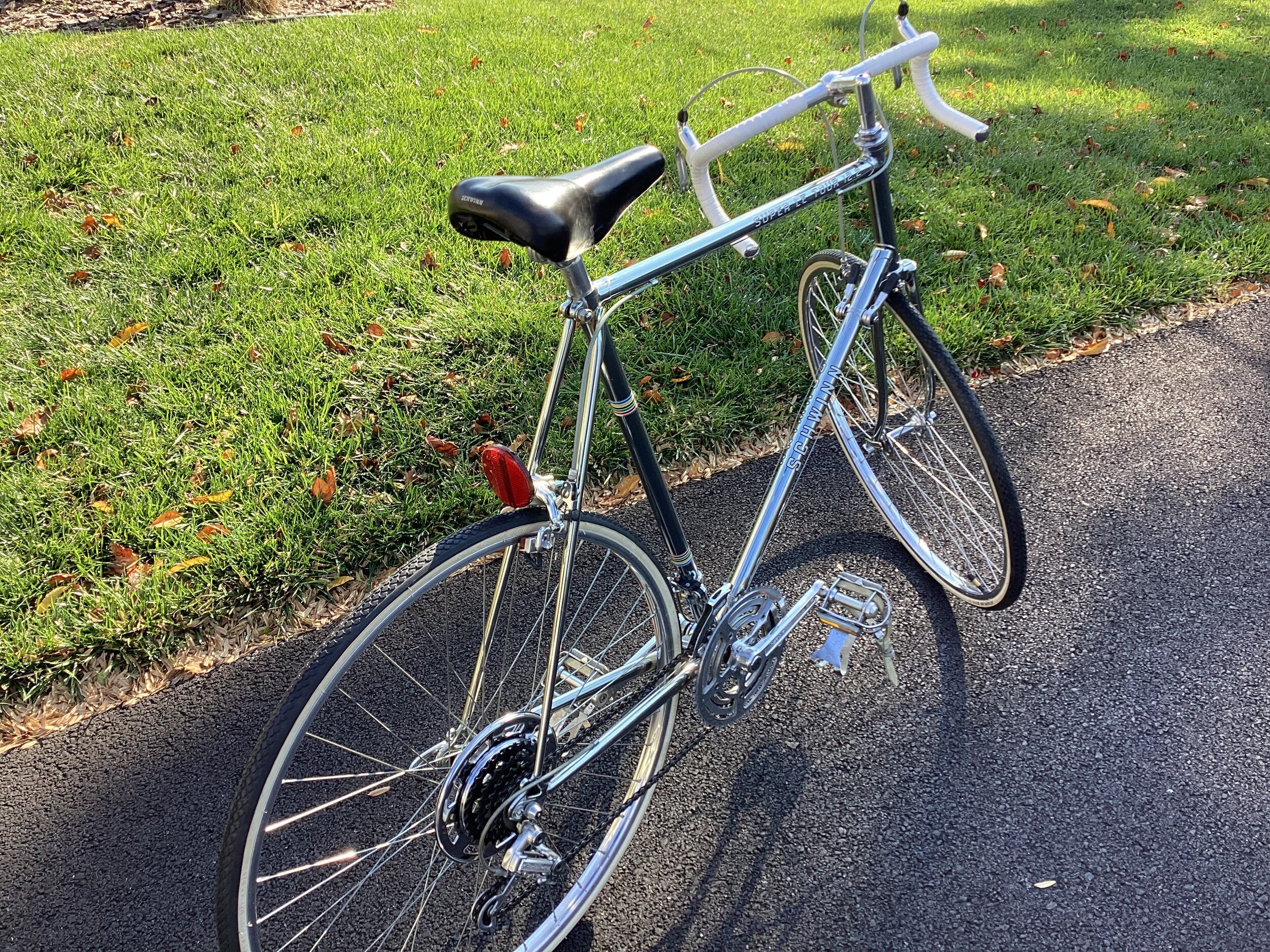

Nice looking Super LeTour! Once I put alloy rims on my '74 and removed the kickstand, I didn't know if I would gain anything in sourcing a Super. I really like the gear shifters up on the headset. Be even better on the end of the handlebars, but I'm too cheap for that conversion.
