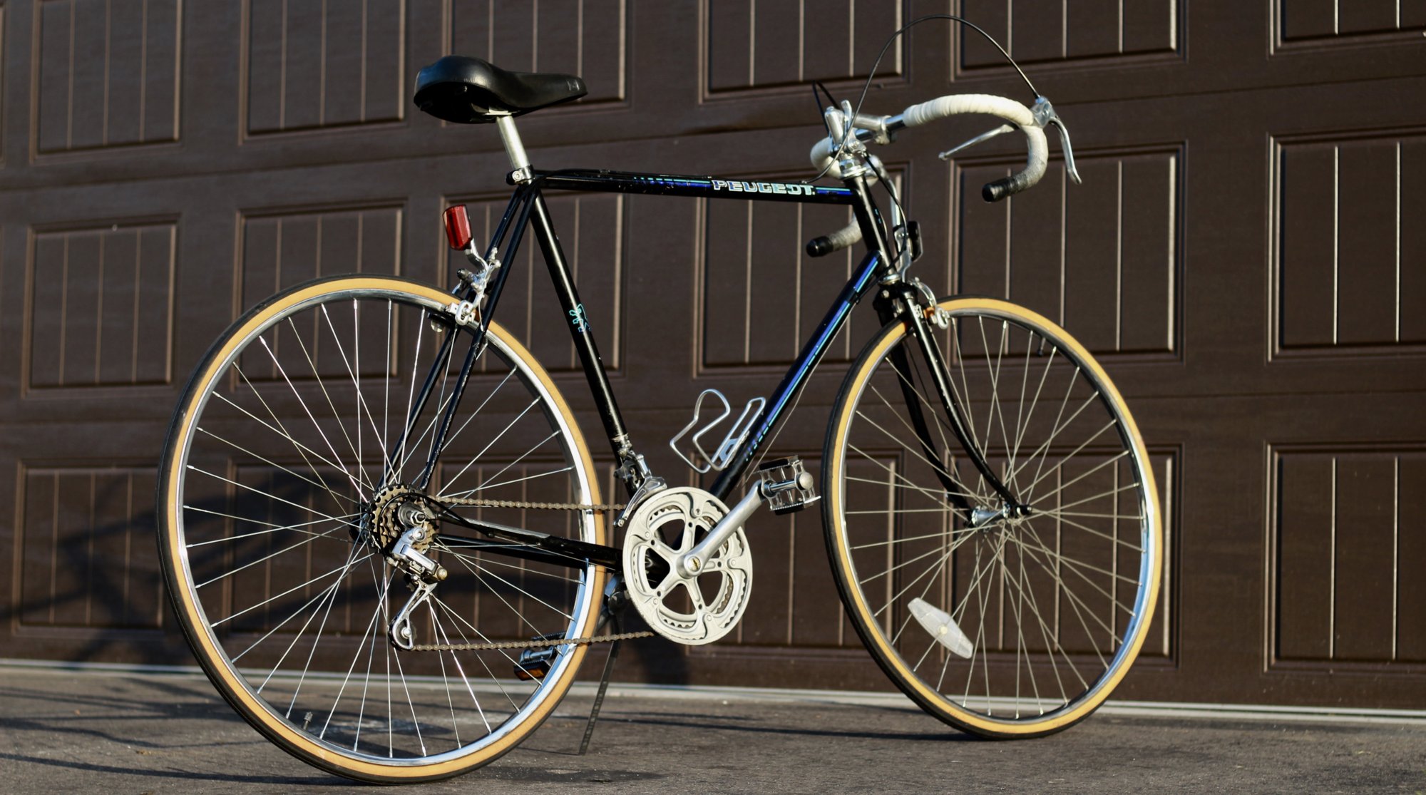

Even after fixing up this Peugeot I have a rough idea of the year but no clue as to the model. There's a sticker that says '103' tubing but that's it. The front hub has an 85 engraved so I assume that's the year. The serial number is Y503 33289.

Cycle appears to be model P6.
Here is the 1985 (US) catalogue page and specification list for the model.

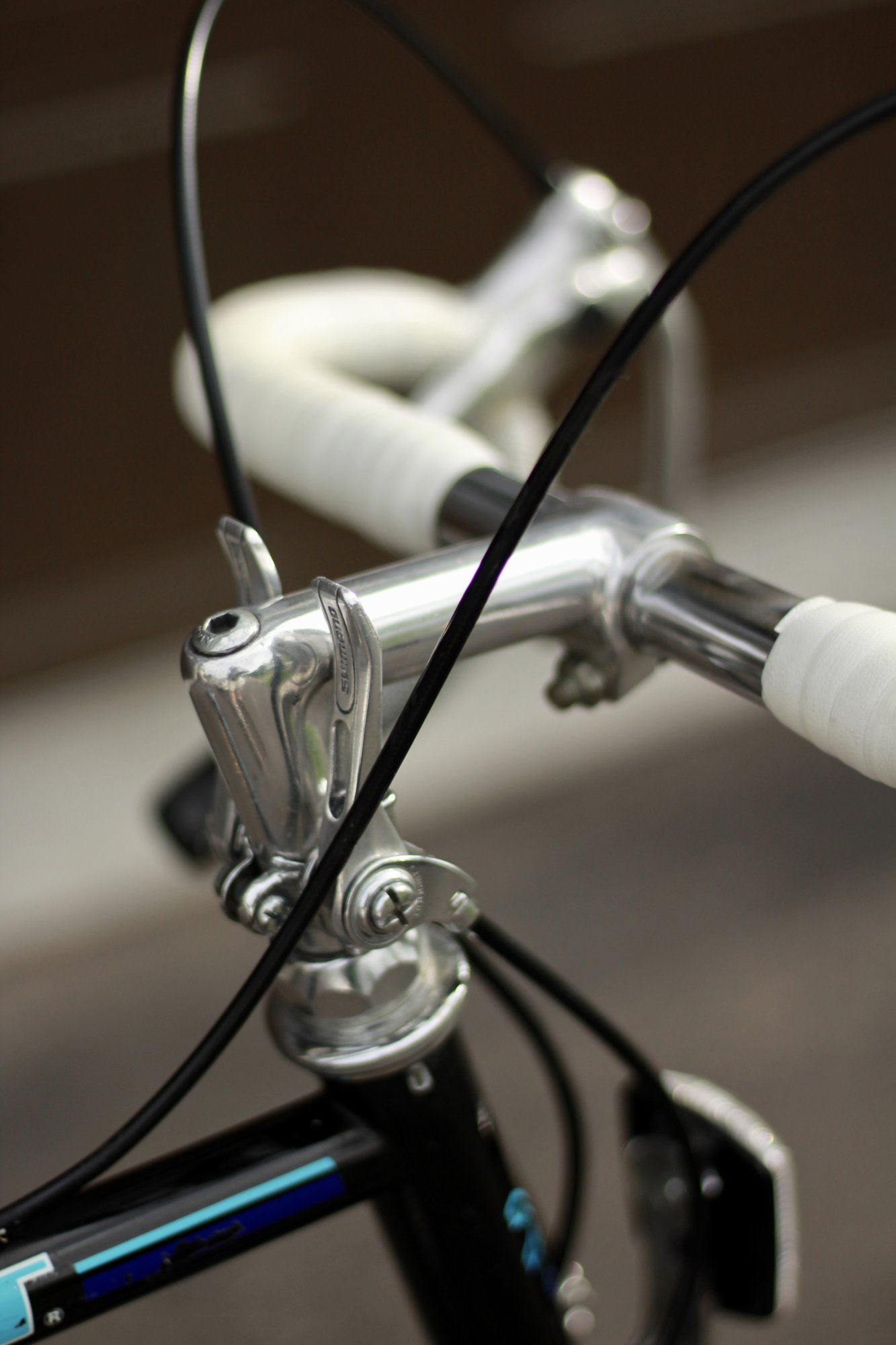

handlebar, at right end
stem, just below the minimum insertion mark
Atom gear block

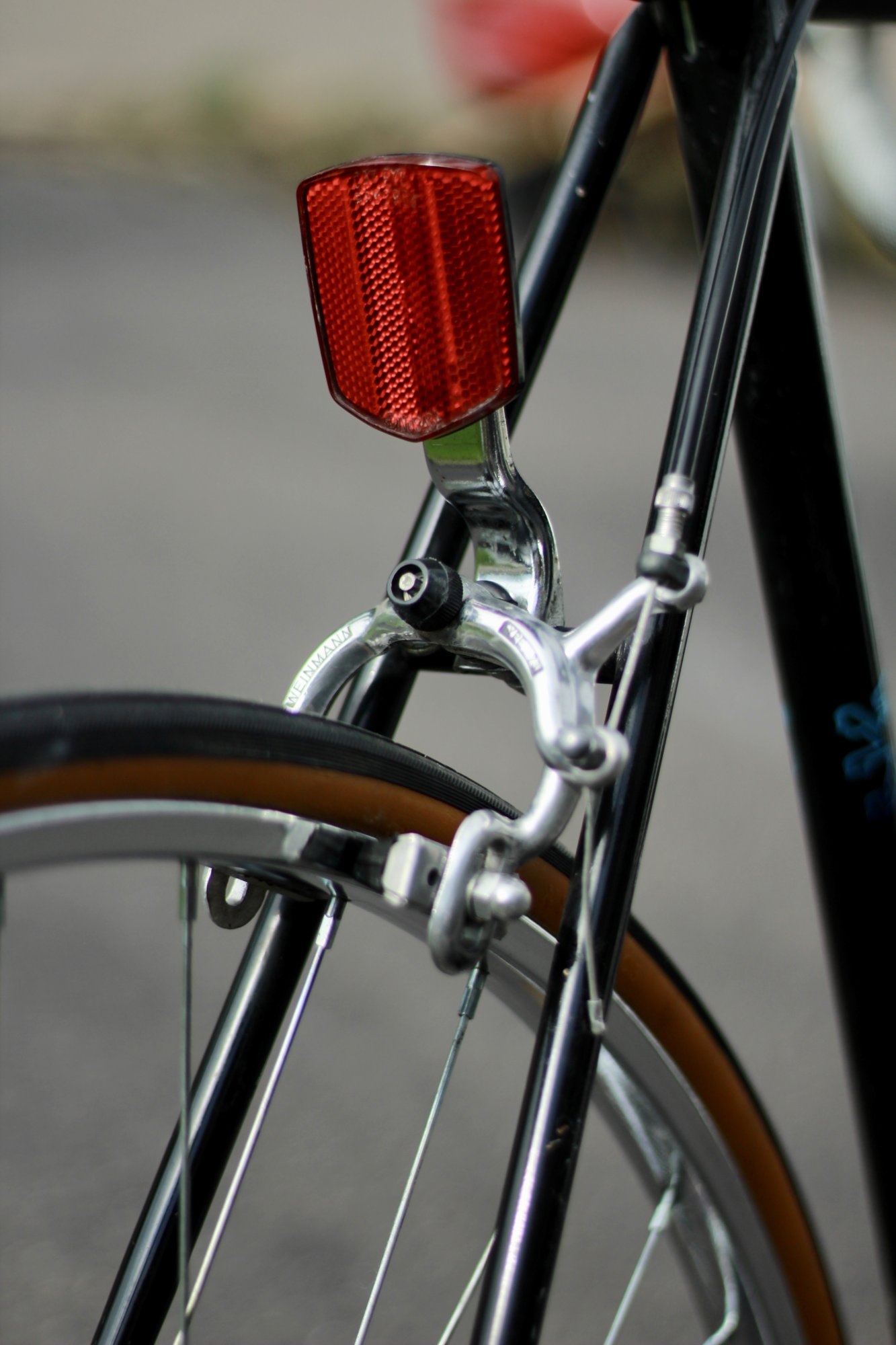

Weinmann brake caliper arms - there is a clock face type marking on the back side. the two digit number in the centre is the year. would expect either 84 or 85.
Shimano gears components are marked with date codes. their "secret decoder ring" is here -
http://www.vintage-trek.com/component_dates.htm#shimano

Yeah, it’s a P6. Initially I thought it was a P8 but they didn’t make any in black.
