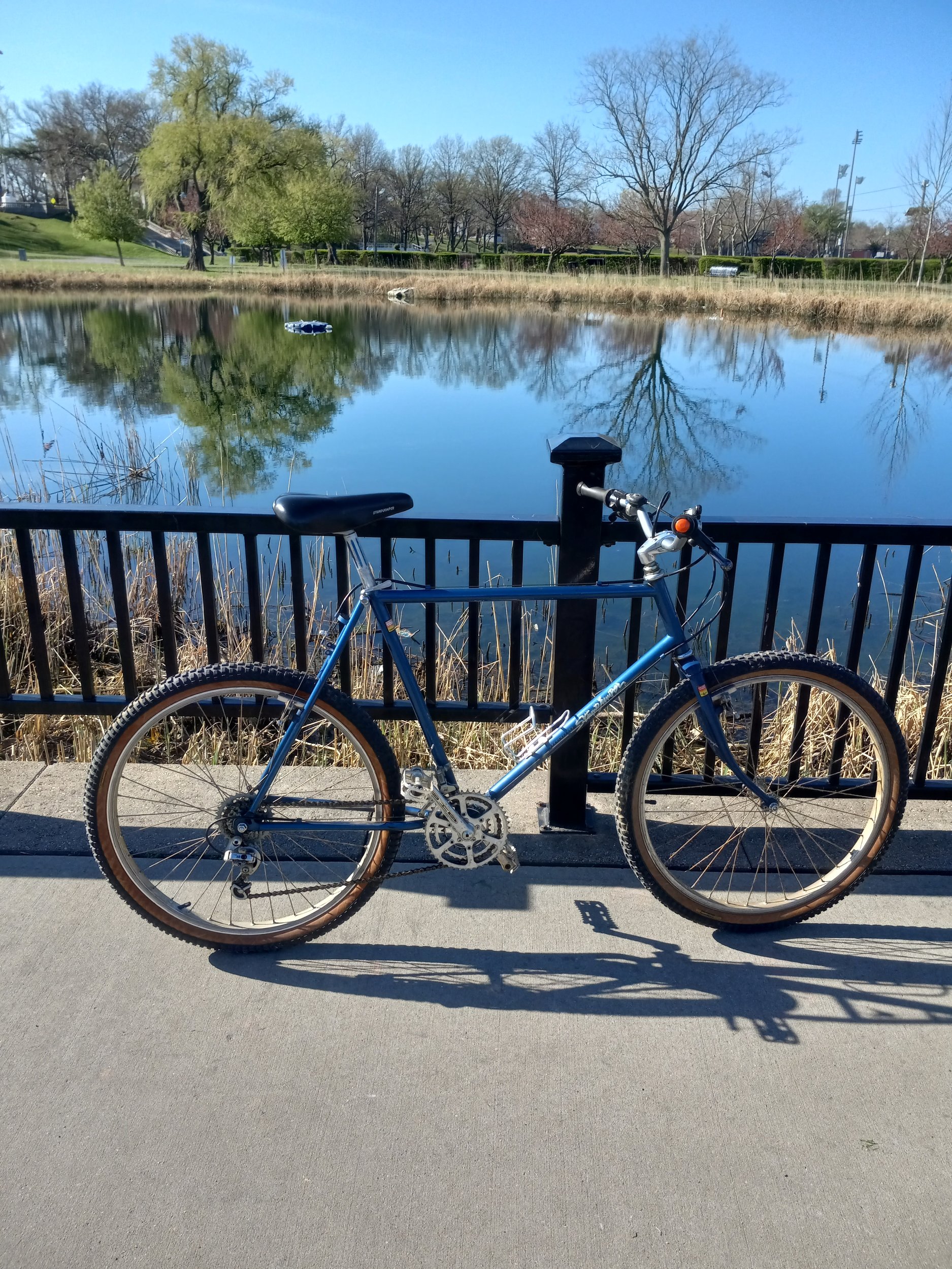

1982 might have been a transition year between the Palo Alto and MountainBikes decals. My Everest could be an '82, but based on the serial number "1630R" and the other bikes listed on the Vintage Ritchey website, I took it to be an '81. Maybe "1" is the year and "630" could be the 630th frame.
Charlie Kelly told me that my bike is an '82 because it has a indentation line around the top of the seat tube and these frames were only made in 1982.
Great info. Thanks! My Everest has that indentation line also. I remember Charlie writing on one the forums, maybe MTBR, that he built all of the wheels with Phil/Bullseye hubs and nutted axles. Both of my bikes have the hex head axle bolts.

1986 Stumpjumper Sport - this one is a bit of a beater bike. It's a high miles bike that had a hard life, which I purchased from a junk dealer from Gloucester, MA. and had it shipped to me in NJ. Had I not purchased it, it's next stop was the scrap yard.
The fork is a period replacement, rear wheel had to be rebuilt since the sidewalls of the original Saturae hoop were almost worn through in spots! The rear axle was also snapped. All of the chainrings on the crank are replacements, and the Deer Head rear derailleur was replaced at some point with a Shimano LX. Surface rust, lots of scratches, and wear typical of a bike that lived near the water most of its life. But, it's a great rider, light and responsive.
March, 1982 Specialized Stumpjumper, purchased from Jeff Archer at First Flight Bikes. This is the earlier TIG welded frame, with an ovalized seattube at the bottom bracket junction. Suntour AR derailleurs, Mighty thumb shifters, Mafac cantis/Tomasselli levers, TA cranks, Araya 7X rims on Suzue sealed bearing hubs.
