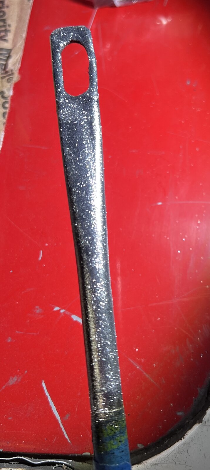

I had a minute today so I figured I’d try the nail dust on a real bike part (I usally use it on movie prop stuff). It’s going to take me longer to type this than it did to do it. I used a putter fork strut. I just cleaned the rust off a bit and went for it.
Spay it gloss black. Once the paint gets tacky dab on the nail dust. Once dry brush off the excess with a nail brush until smooth.
The surface was pitted so it’s not all smooth. I may try on a scrap clean metal tube to see how that goes
Wow
